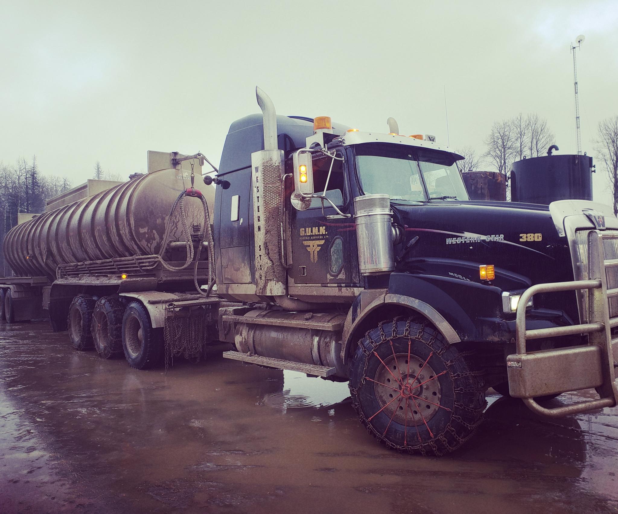

Freezing rain followed by 10 - 15 inches of snow over the weekend had me feel the need to chain her up good!!
I gotta say, I'm gonna miss this beast of a truck once its sold. She's built for winters, factory block and oil heater, turbo 2000 air dryer system (leaves the tanks bone dry), 6 air tanks, alcohol sniffer, 6 way locking cuffs that can engage at any speed, 13,000kg bobtail tare weight grips the road nicely and the massive steers actually feel insanely stable. Shes got massive clearance for any snow drifts as well.
