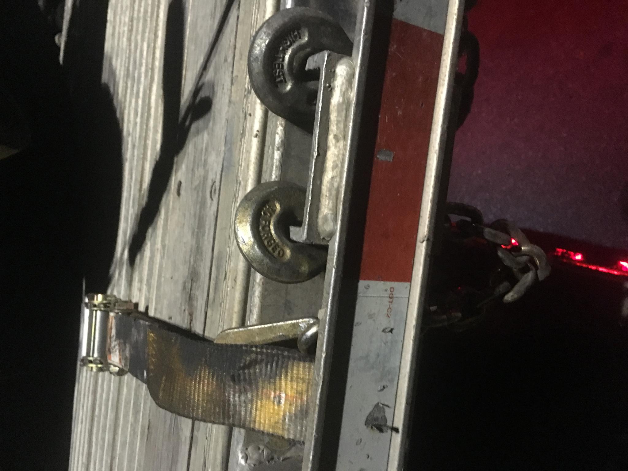

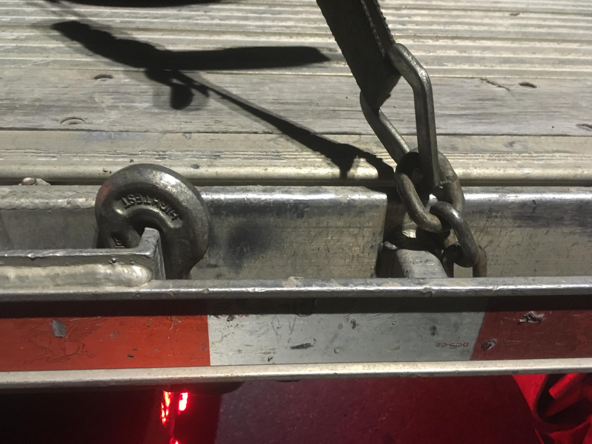

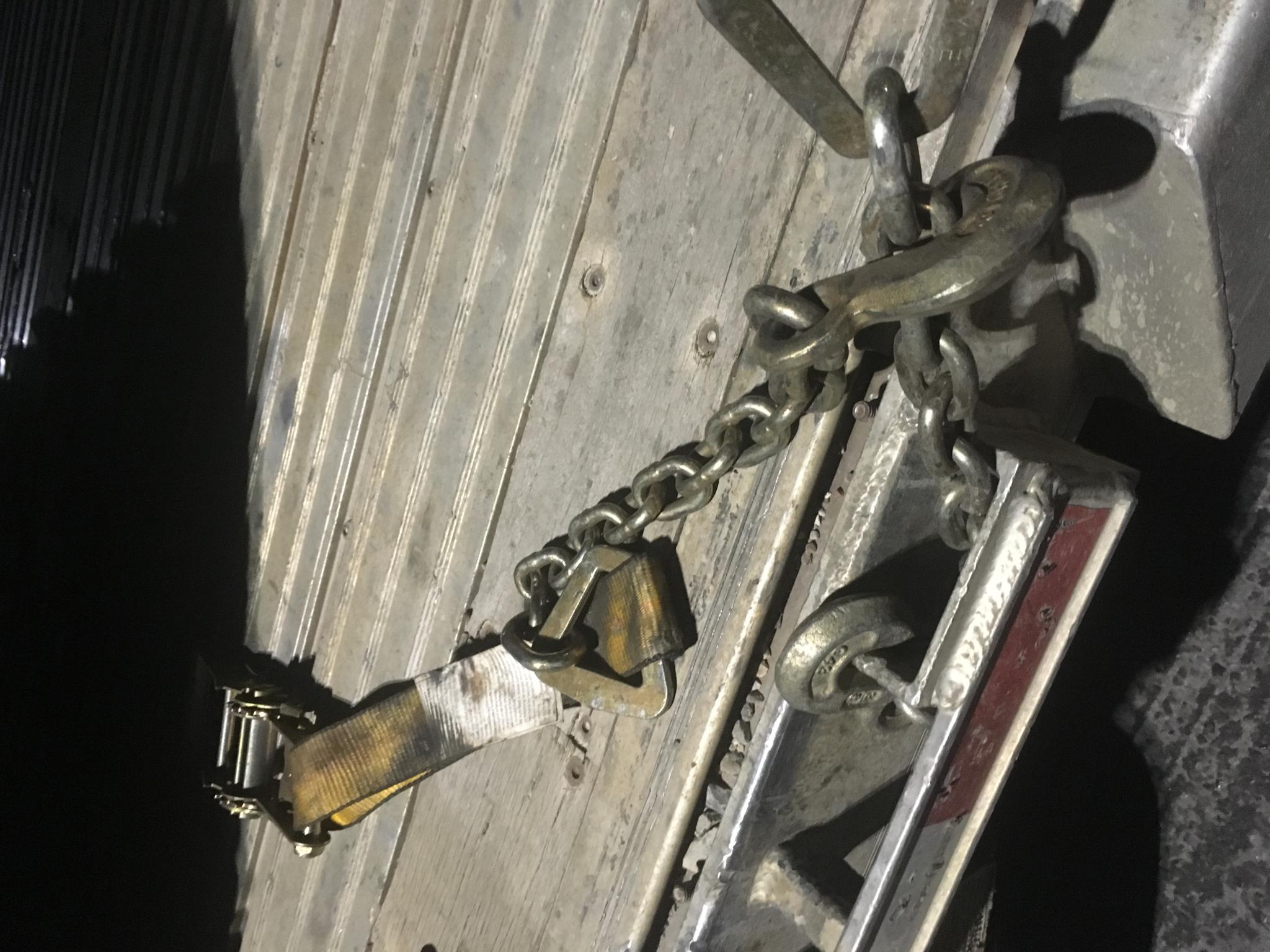

(10-25-2019 )Chamberpains Wrote:  DDlight, your still only using half the pocket. Use the whole pocket or it doesn't count. A single side of the pocket has 0 rating.
I could have sworn I've seen someplace that it was rated to hook on the pocket, but my East manual shows it hooked to the chain also - albeit, only using on side of the pocket...

Nostalgic,
I believe that is what they call 4 points of contact when it comes to wrapping around that securement point. In the picture you have the chain touching 2 points (or corners) on the spool and 2 points (or ends) on the pocket. That gives you the 4 points. 2 points will take the stress when moved in one direction, the other 2 points will take the stress when pulled in the other direction. Its the same reasoning why WLL are different from direct connection (half of indirect) and indirect connection(double direct). Direct takes all the force all the time, indirect trades off or shares stress between 2 points.
The WLL of using a pockt and spool is often different than using just the pocket alone.
The way DDlight is attaching to them is 1 or at best 2 points directly to one side of the pocket. Its not pocket & spool or just pocket WLL rating. Its only half a pocket. Which has no rating.

I wouldn’t have had enough chain to be able to go around the stake pocket completely.
10-25-2019, (Subject: What would you have done differently?? )
Post: #42
I guess I like doing it that way so it leaves enough chain you can grab onto it again. Or you can use one stake pocket for two tie downs

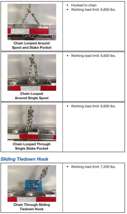

Nostalgic, is that the actual securement diagram that came with the trailer? That's the 1st time I've seen securement to only one side of the pocket. (3rd picture down) All the pics and training I had said that you wrap the whole pocket. Maybe things are different on some trailers.
Post: #44
(10-25-2019 )Chamberpains Wrote:  Nostalgic, is that the actual securement diagram that came with the trailer? That's the 1st time I've seen securement to only one side of the pocket. (3rd picture down) All the pics and training I had said that you wrap the whole pocket. Maybe things are different on some trailers.
Yep. Everything is rated @6600, with exception of J Hook, which is 7200. JHook with strap is 5400, which doesn't make any sense if you used one of the super straps. Also had to peel off the stickers saying not to use the rub rail. I made it 2 months before they had to go. I've had to use the pocket winch once now on the rub rail also - sometimes there's only one option, and it stinks.
Yeah, I could have loaded them back further, but this was first on, last off partial from Tacoma to Philly and I wanted to save every inch of the deck possible.

So East trailers rate the single side of the pocket but not the rub rail. My Reitnouer trailer rates the whole pocket and also rates the rub rail. I guess it goes to show that you need to know your equipment. Don't just assume every trailer is the same. This exactly why the industry is confused all the time. Everything you run in to is different. Nothing is uniform to quickly know what to use, how to use and if its in good condition or not. It's a constant learning and questioning game.
