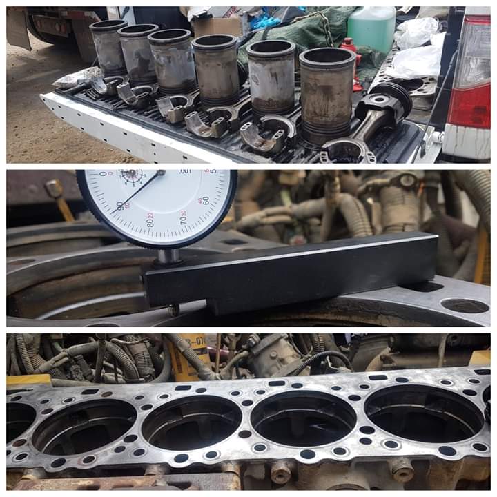

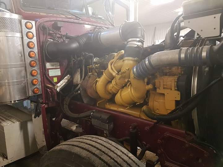

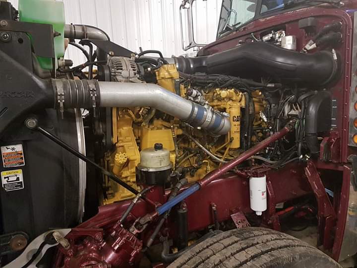

Those who dont know, I rebuilt my 2008 Peterbilt 389 with a Cat C15 SDP engine a year and a bit ago, we spared no expense and did everything minus the turbos..... and I mean everything! I replaced all wiring, ecm, fuel pump and primer and all regulators, every single sensor is new, front and read structures, injectors etc etc. We even removed all the unnecessary crap....... boy did she look pretty and was fun to drive.
./uploads/201910/post_1367_1572363369_6159c3dcee56f40be617bc78771012b3.jpg./uploads/201910/post_1367_1572363381_07ed738d2f164cd82dfe2a60ce191d8c.jpg
The problem, the mechanic didnt cut the deck or counter bores even though he was paid to do so..... he didnt do it because he didnt have the tool, I told him to drive someone out there and make sure it was done and I'd pay whatever it cost. I made the mistake of going on vacation so I didnt know he didnt do it until the head gasket blew 2 weeks later.
He put a new gasket on blaming a bad gasket. 2 weeks later it blew again so my wife and I tore it down to find the grooves were 10x Cats allowable wear!!!

So we let it sit opened up for a year till we paid off debt and saved enough money. Today is the day were starting, the motor is being yanked out as I type this. Unfortunately my injectors got surface rust built up on them so I sent them away for testing.... that's a expensive mistake.
I am waiting to see how the injectors and turbos test back, if they are good then I will be keeping this Cat engine because I could not justify swapping another motor when absolutely everything is new on this one, I already bought new cylinder packs and spacer plate and bearings and rings and a gasket set last year. However, If the injectors and turbos come back bad and itll add an extra $23,000cad to the bill, I'll throw a ISX in here in a heartbeat as that would be my preferred engine anyways.
If I do the Cat, the block is going for the work over, crankshaft to measure straightness, rods checked out, head cleaned up and worked over etc.
If I do a ISX I will buy 1 of 2 good used ones I have available and I will swap everything on the outside before install so all the nickle and dime craps done, then when the time comes I will just need a inframe.

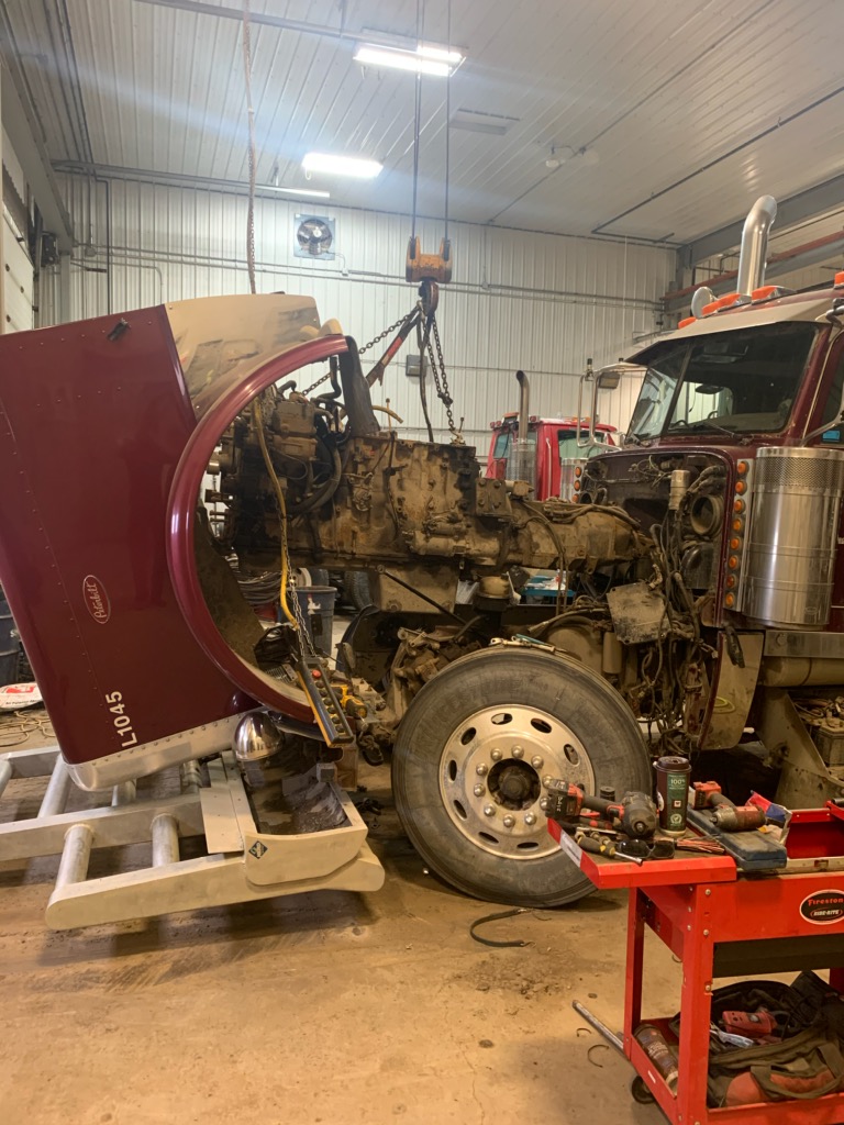

Getting ready to pull the beast...

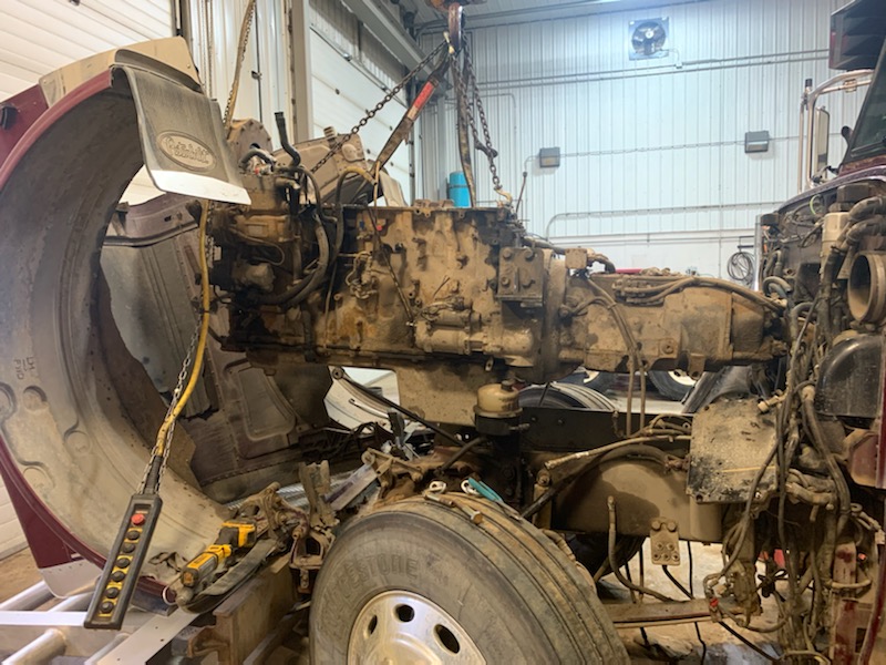

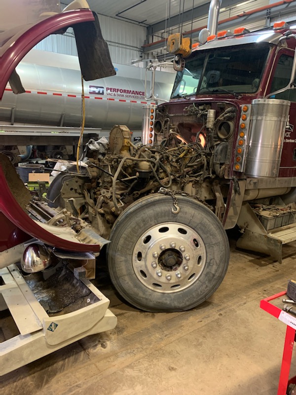

./uploads/201910/post_1367_1572456628_b6d4e24d53b111e5e733bcae7b57a6b4.jpg./uploads/201910/post_1367_1572456647_3a985ce881292b621de975e2f3c6072b.jpg
And were off!!! Man I really should have washed all the mud off before doing a motor tear down.....
Might have to run a pressure washer over it now that the motors out.
