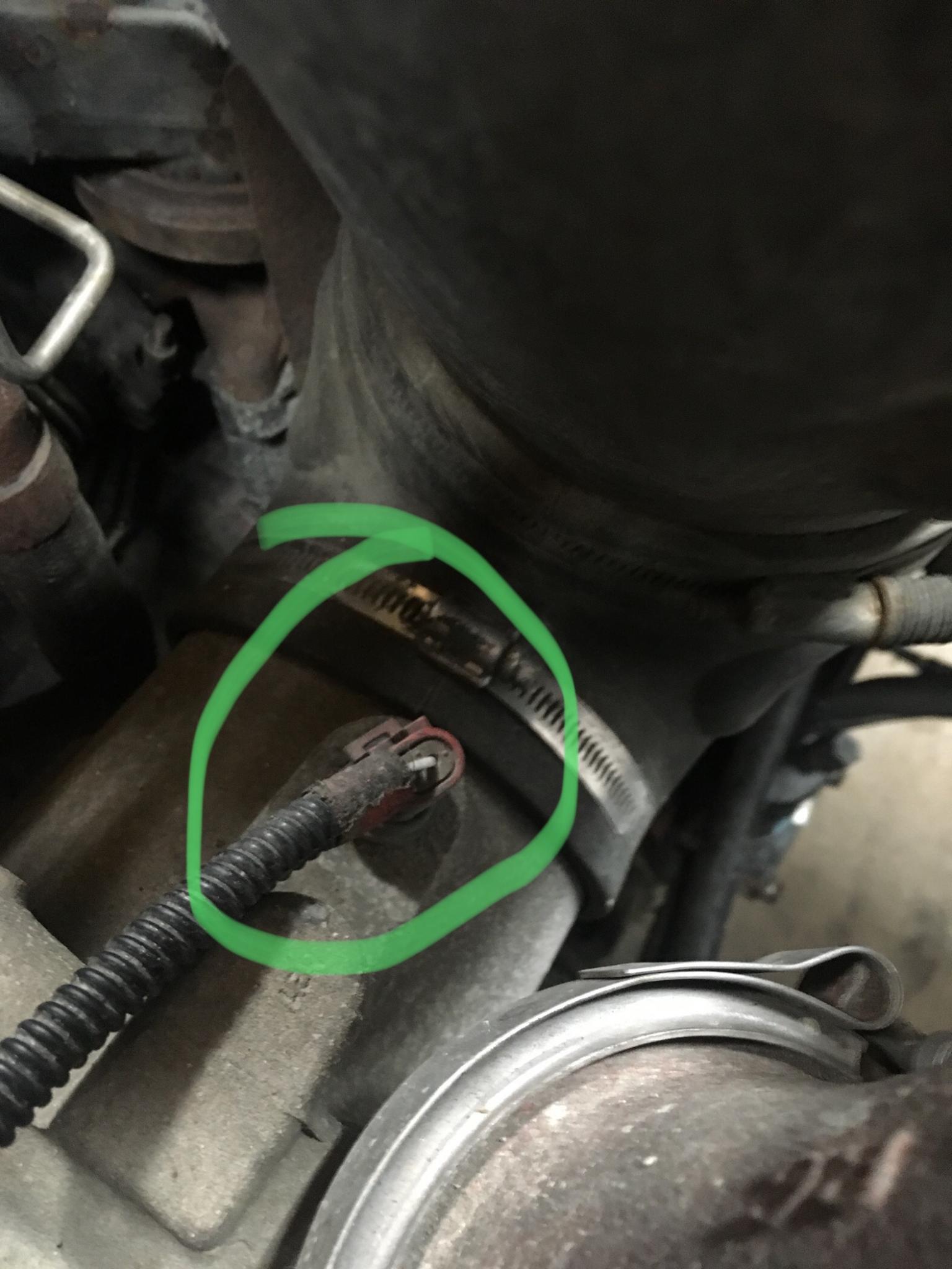

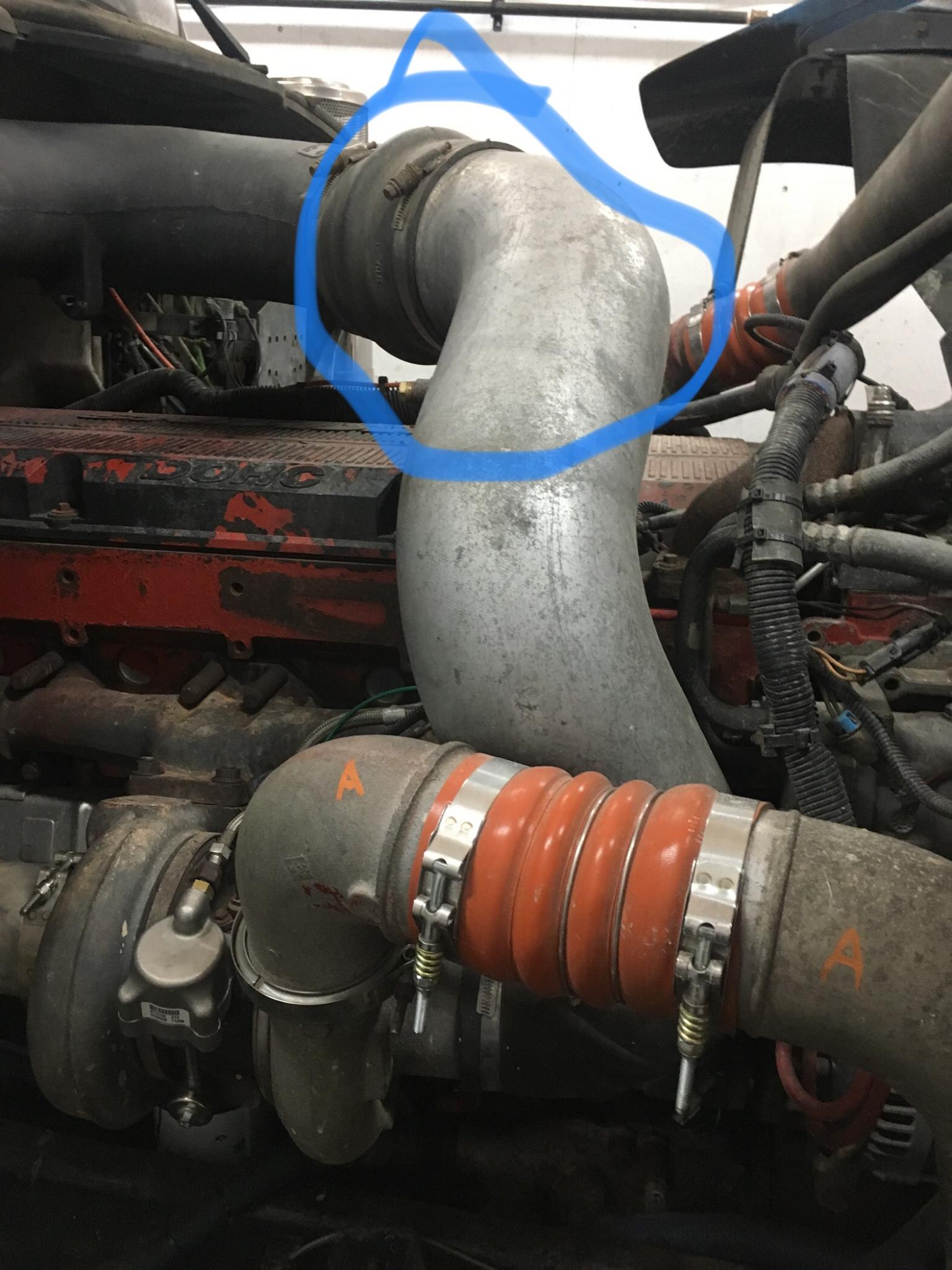

(11-03-2019 )Chamberpains Wrote:  Now you just need to fashion something to block off the 6" intake pipe on the turbo. Then all you have to do to pressurize the whole system, including the CAC, is remove the turbo intake temp sensor and hook your pressure regulator in. Then pump in on up.
Just so I’m following along....which I think I am....
Block off the turbo air intake 6”....yup, that makes sense
Remove turbo intake sensor....that’s gotta be the one circled?
