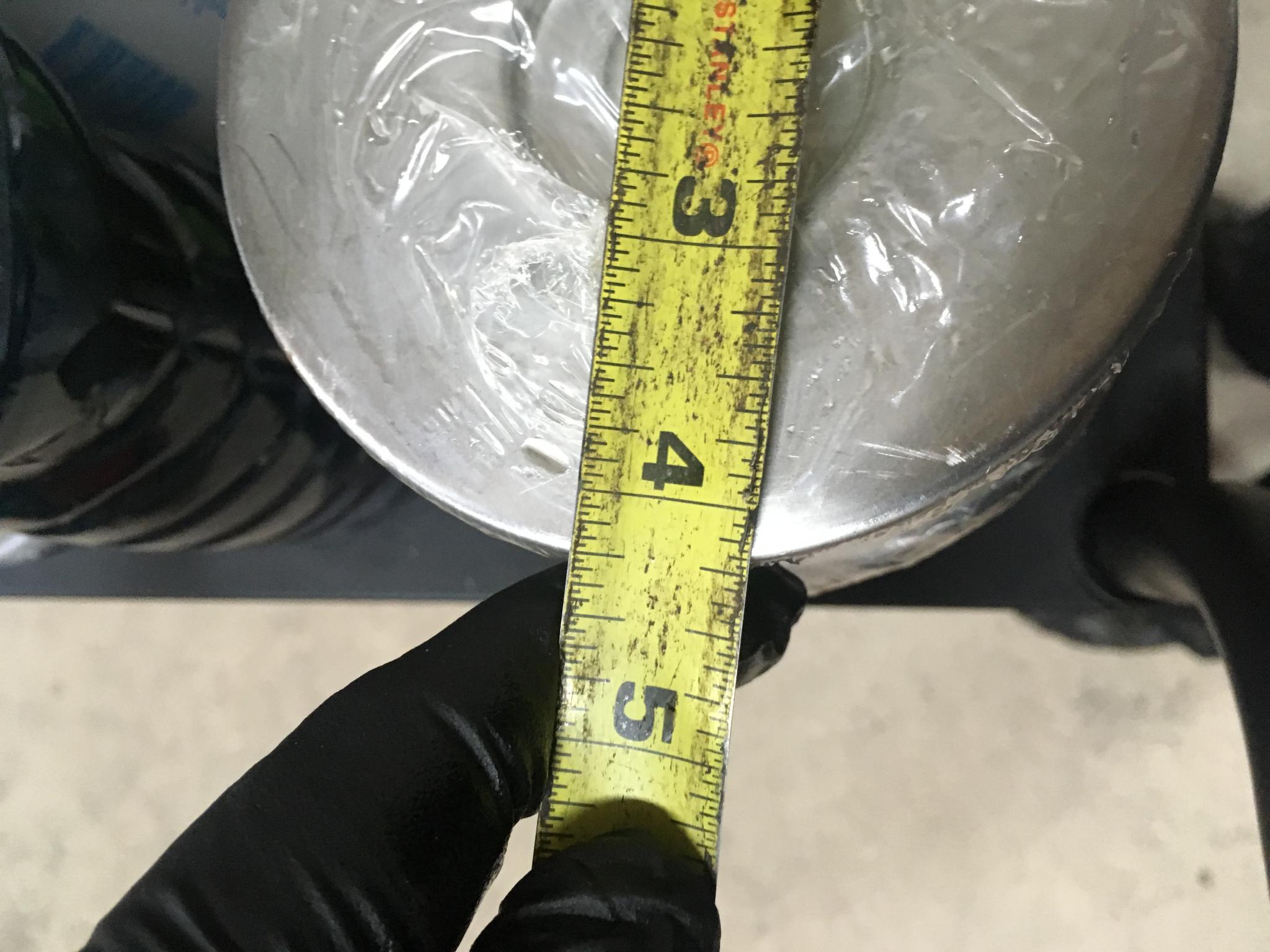

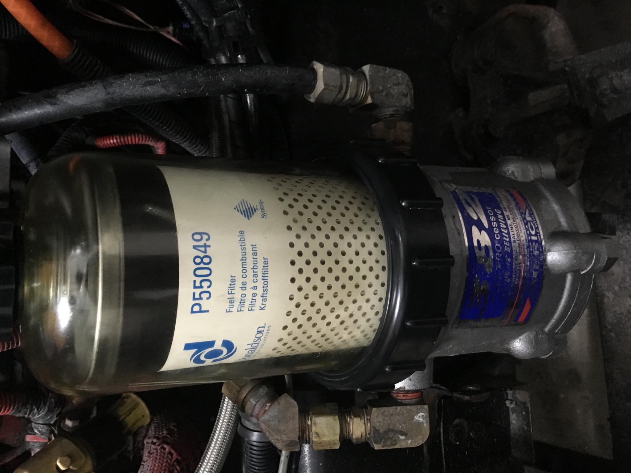

Maybe this is common knowledge and I’m late to the party...
There’s two sizes of filters for the Davco 382. One is 3 3/4” diameter and the other is 4 1/4” diameter.
Both fit in the same filter housing, no special housing needed. This is my first time with the larger filter, I’m interested to see if it does a better job/lasts longer

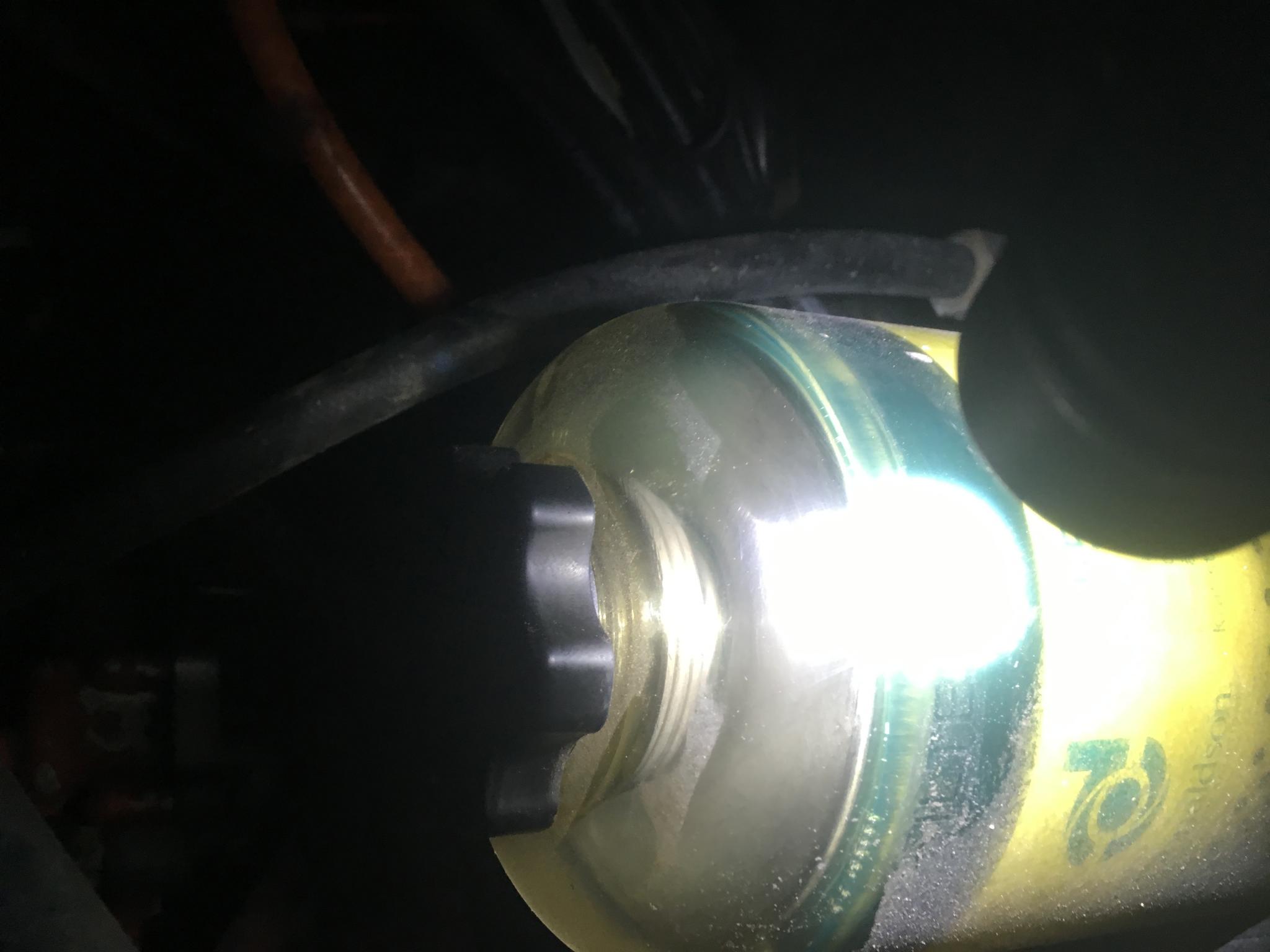

Two weeks and roughly 3500 miles and she’s full. I don’t think that’s any better than the smaller filters.

(11-16-2019 )DDlighttruck Wrote:  Two weeks and roughly 3500 miles and she’s full. I don’t think that’s any better than the smaller filters.
I use a 10 micron fleetguard filter. It clogs up at about 18-20k miles or more, unless I get some bad fuel somewhere.
If yours is clogged up that fast,... something in your fuel system or tanks is very wrong!.
The filter is doing its job!... find out what is wrong!.
In the mean time, get some spare 10 micron filters / replace them often, maybe use some algicide!. The problem will eventually get solved.

Interesting. I’ve always ran a 7 micron in the Davco. Donaldson said the engine fuel filter is a 25 micron, the spin on metal one.
What’s odd is CAT tested my fuel back in the spring, when it was dark and gross, they give it two thumbs up as good fuel
So if there’s something wrong with the fuel, CAT didn’t find it. But I did have it sampled

I find that sad,.. but not surprising.
Is the bottom of your fuel tanks black? -- Mine have no trace of anything black at the bottom.
It could be gunk or something else leaching out from the walls or bottom of the tanks?.

(11-16-2019 )Rawze Wrote:  I find that sad,.. but not surprising.
Both tanks are completely coated on the inside with a black film, not just the bottom
I’ve ran that diesel-kleen through before a few times, the Killem seems to help
