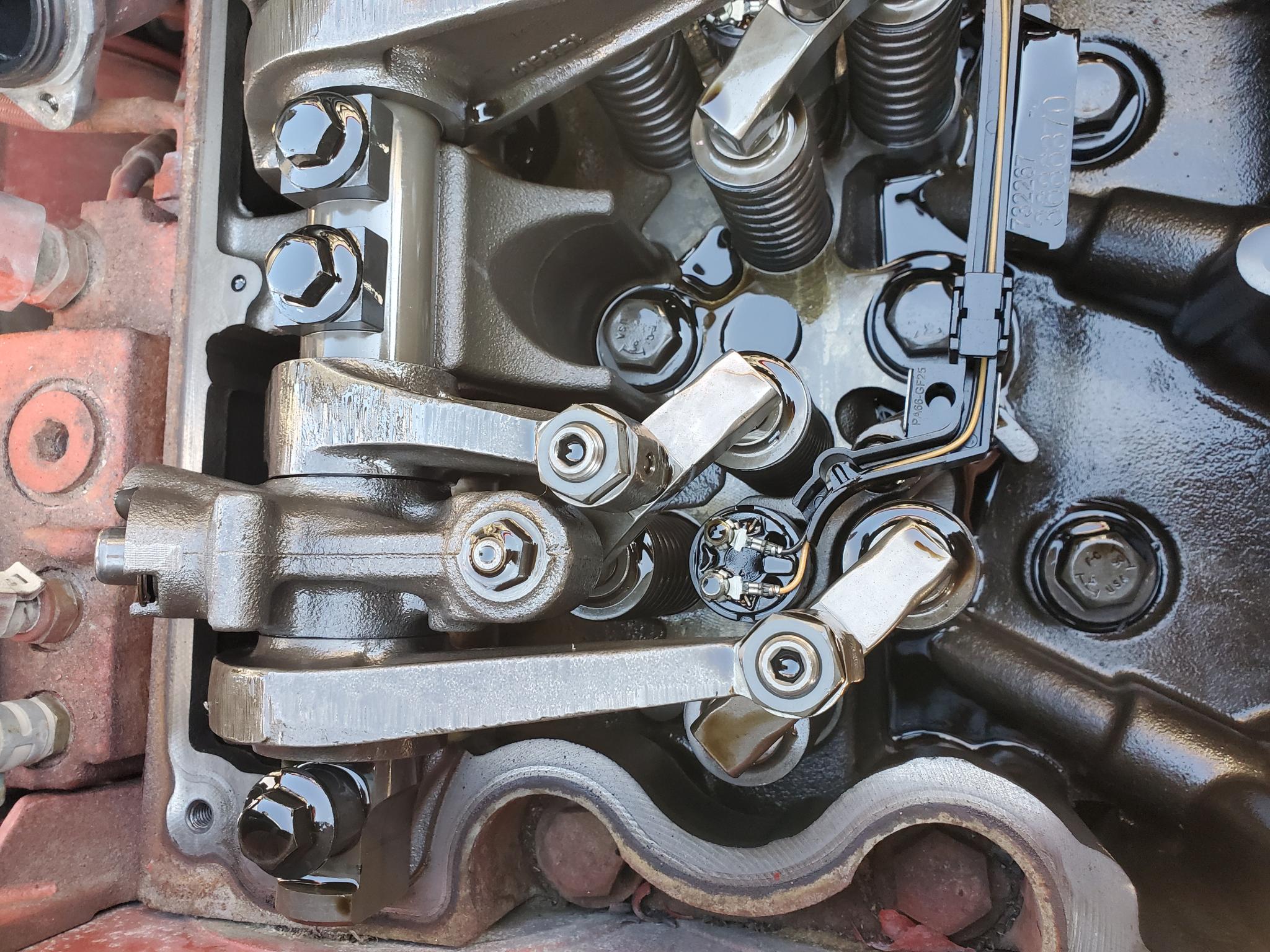

I just did my first ever over set on a big truck. Thanks to this site for the information to make it easier. It was a pretty easy job. I'm glad I saved that $325. I watched Rawze do it and he showed how to adjust the injectors which I was going to do but mine were made different. Mine have electrical wires on them. Are they self adjusting?

you have a 2011ish or newer truck that only has 1 cam either CM2250 or CM2350 the CM870 and 871 had 2 cams 1 for int/exh the other for injectors. your engine has electric injectors also known as common rail with Piazo or however its spelled injectors. the only adjusting you can do with those injectors is programming the ECM

Looks nice and clean in there, keep up on the servicing and she will treat you right, and run some 80-90 gear lube, keep those lobes and rollers coated.

I would make sure injectors have been properly torqued.

(11-10-2019 )Lonestar10 Wrote:  you have a 2011ish or newer truck that only has 1 cam either CM2250 or CM2350 the CM870 and 871 had 2 cams 1 for int/exh the other for injectors. your engine has electric injectors also known as common rail with Piazo or however its spelled injectors. the only adjusting you can do with those injectors is programming the ECM
Good information. Thank you. It a 2012
