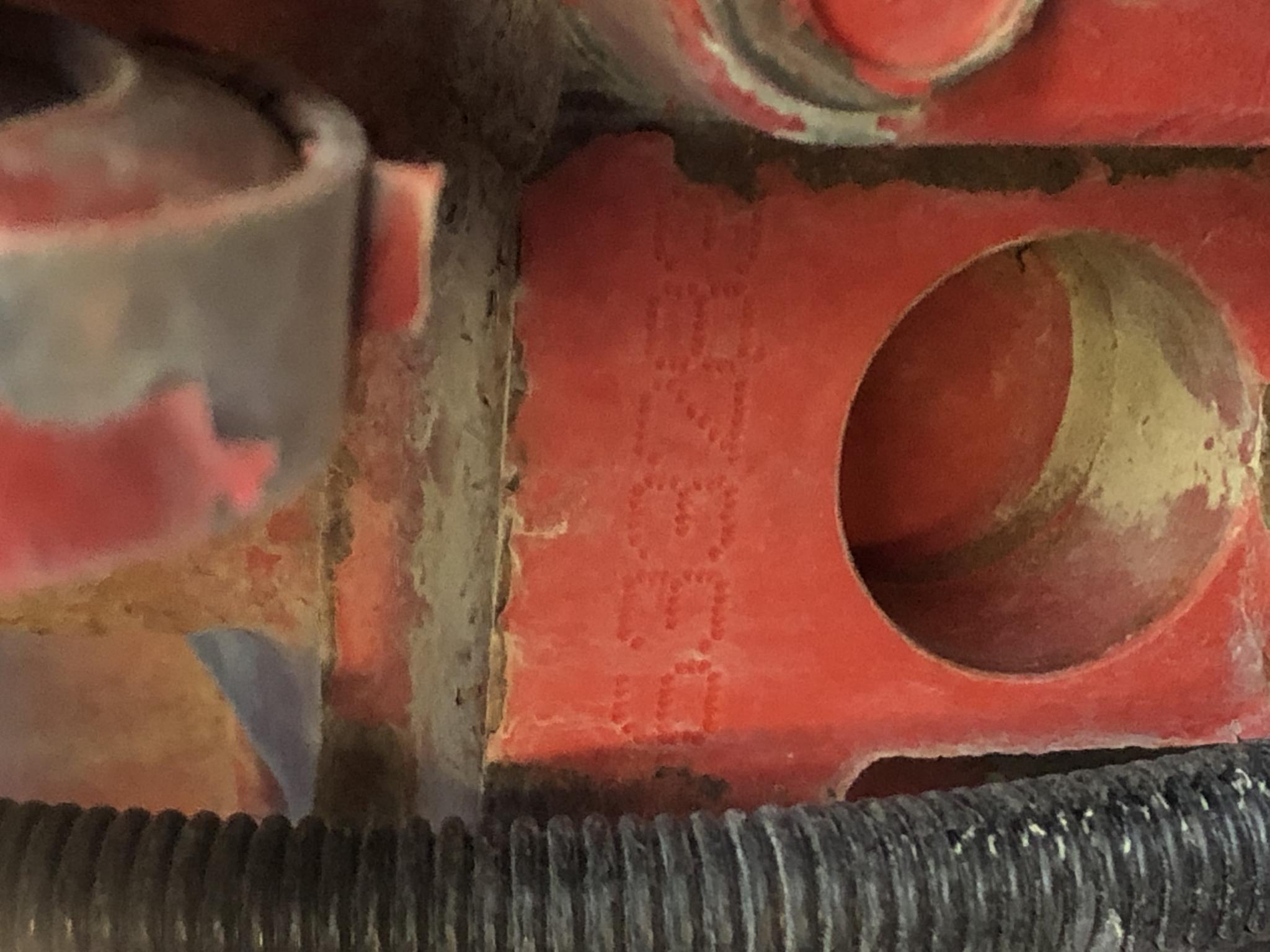

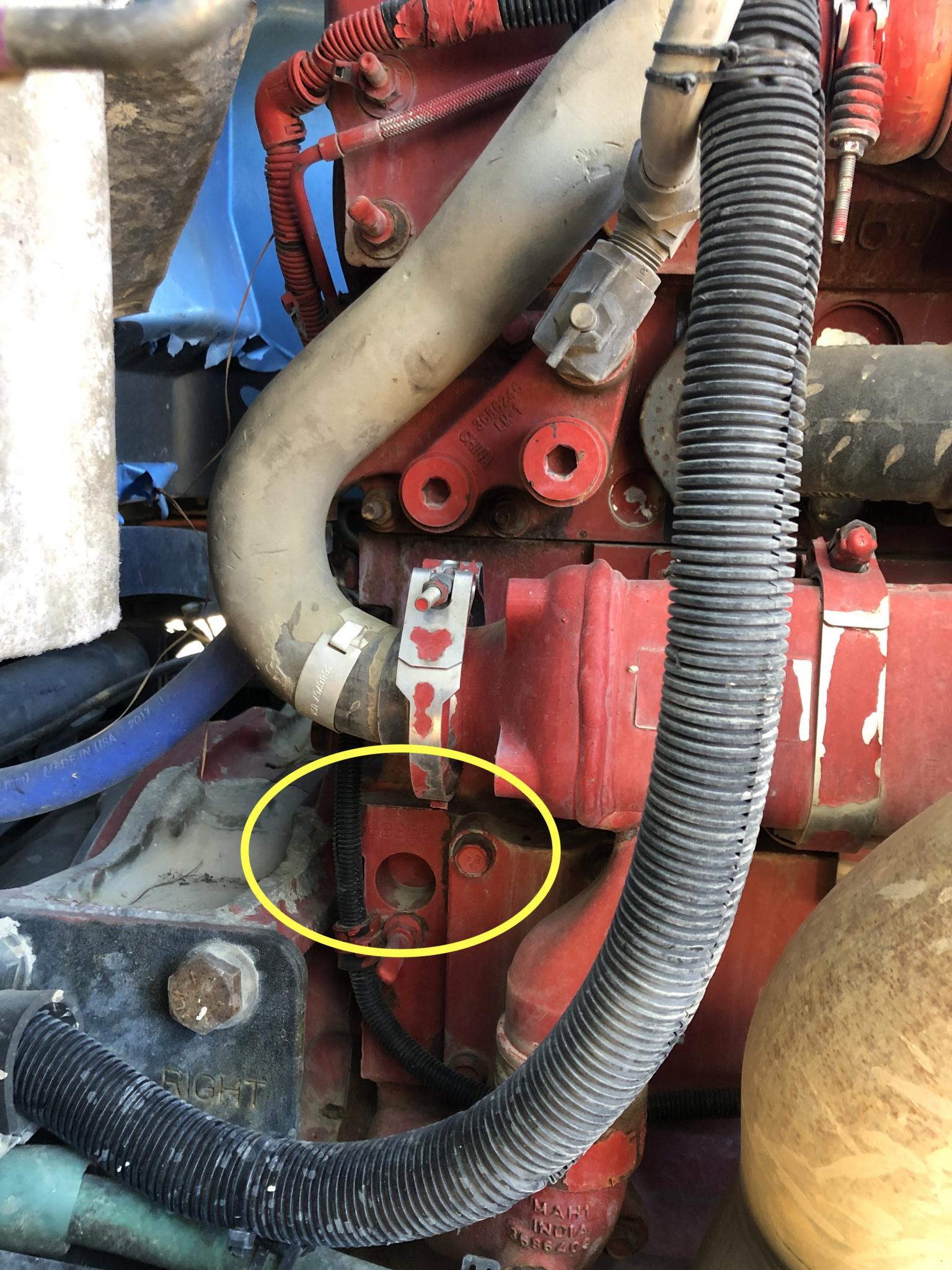

On the passenger side of the engine all the way in the back by the flywheel housing the engine number will be stamped into the top of the block on a machined surface at the top of the deck where the head and block meet in dot matrix numbers.

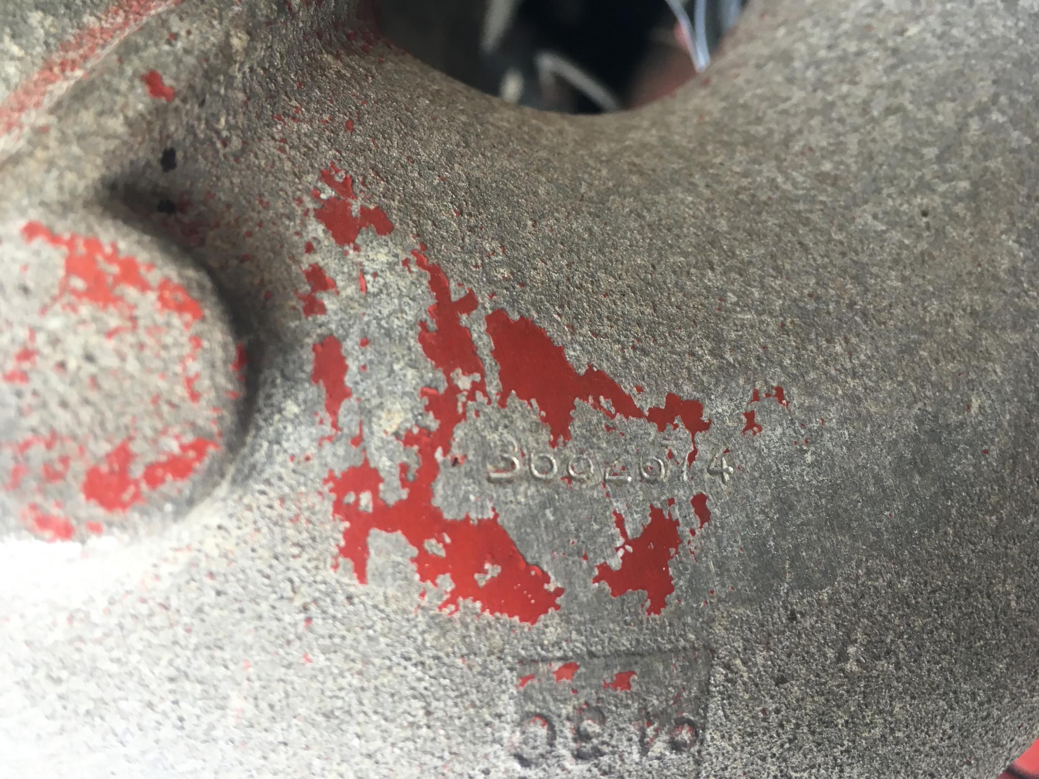

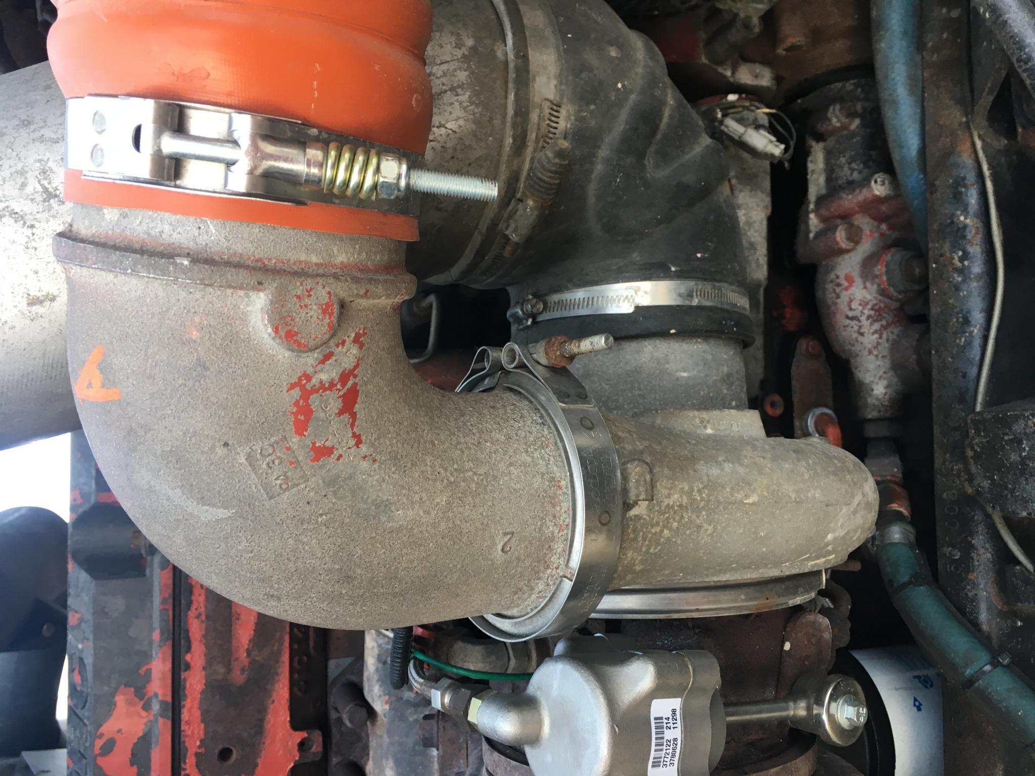

(11-23-2019 )Rawze Wrote:  What is the part# stamped into the elbow connector pipe coming off the turbo towards the charge air cooler?
Looks like 94 3C
That is not the cummins part#. In the pic you provided though,.. it is there .. it is very faded, located below the set of numbers u mentioned. Yours is the 561 model housing, 3682614? (hard to see but this is what it reads). That elbow is the one commonly found on trucks like my Prostar... A 561 with its alternate impeller, not a typical 551.

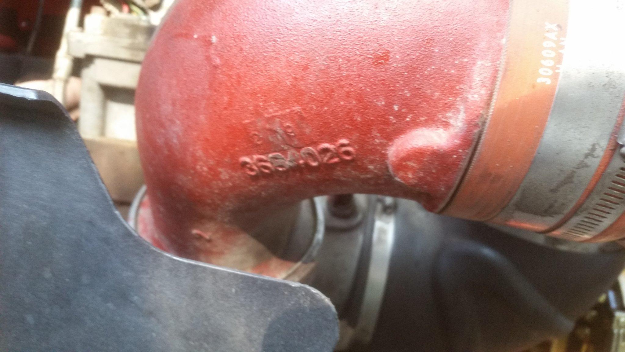

Here is a Typical 551 elbow pipe (3684026)... (this is the most common one). they are found on pete's and other trucks with larger, more free-flowing CAC units. ...

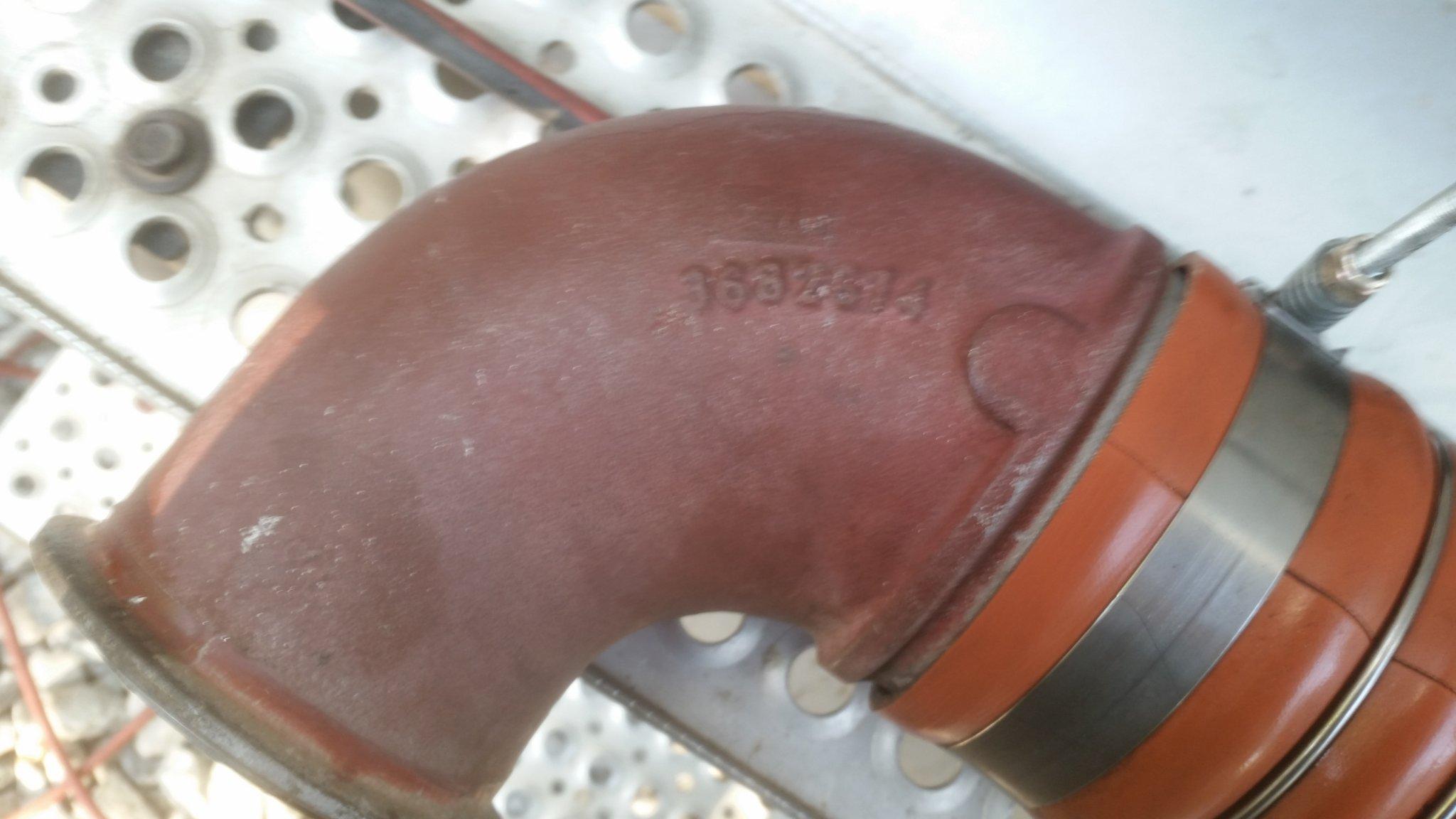

And here is the one that typically belongs to the not-so-common 561 with its alternate impeller ... They are common on internationals.
I have seen guys go from the 551 to the 561 because it has bigger housing and elbow, thinking they can get some gains out of it. -- Everyone I have seen try this, they ended up loosing fuel mileage and had to eventually switch back. - Its funny though how it works so well on a Prostar and small tier engines though. I am thinking it was designed to be optimized when using slightly restrictive CAC units? -- Just a guess.
The truck VIN is stamped there or the engine serial number is stamped there?
Chamberpains was suggesting using the truck VIN, I believe, which I don’t have for my engine
Looks like 94 3C
That is not the cummins part#. In the pic you provided though,.. it is there .. it is very faded, located below the set of numbers u mentioned. Yours is the 561 model housing, 3682614 (hard to see but this is what it reads). That elbow is the one commonly found on trucks like my Prostar... A 561 with its alternate impeller, not a typical 551.
Here is a Typical 551 elbow pipe... (this is the most common one). they are found on pete's and other trucks with larger, more free-flowing CAC units. ...

Ok daylight and not being in a hurry helps. Looks like 3682674, it’s faint but it’s there
Outside of clamp to outside of clamp is roughly 4 1/4” where it meets the turbo

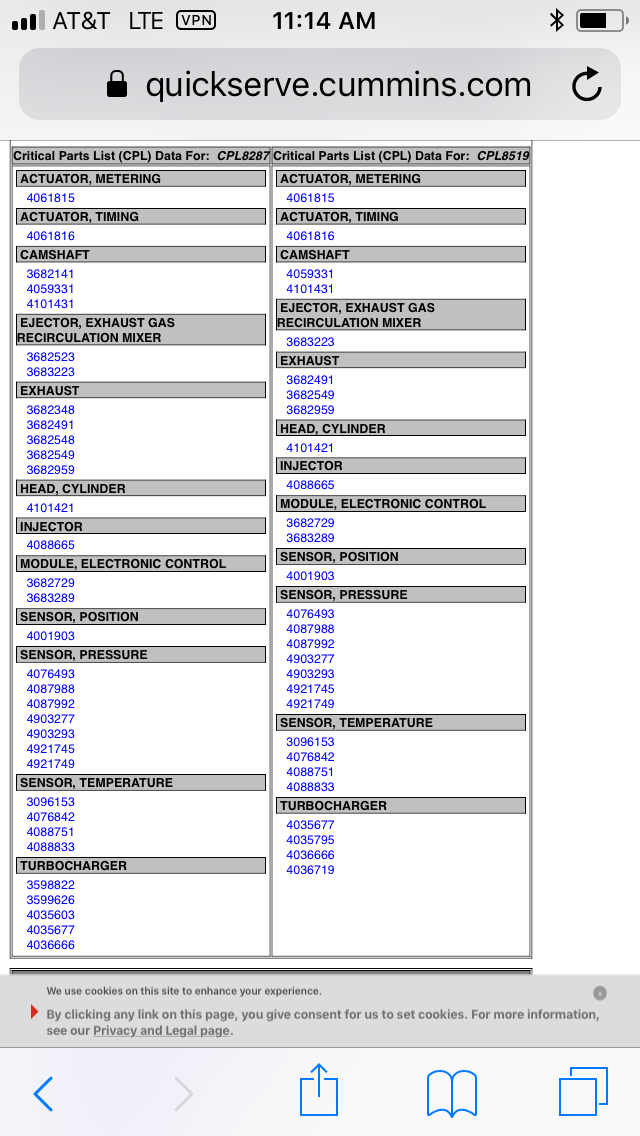

./uploads/201911/post_2980_1574606800_9ca79a3575f907e918fd30c5fce5dd79.png
I did compare the the CPLs but other than matching part numbers I don’t know how to dig deeper

The VIN gives this ESN
./uploads/201911/post_3200_1574616439_811ae83497ed256450e93cc5e63756ed.png
Which gives a superseded turbo assy of 2881993 for a family 2
If I go try to build a 8287 engine the best they offer is a long block which does not include a turbo... the 8287 long block also includes 8288, 8520 & 8523 which all appear to be family 1 engines and would be a different turbo (2881994)
The engine number would be back here if it's accessible.
 Thanks given by: DDlighttruck
