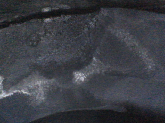

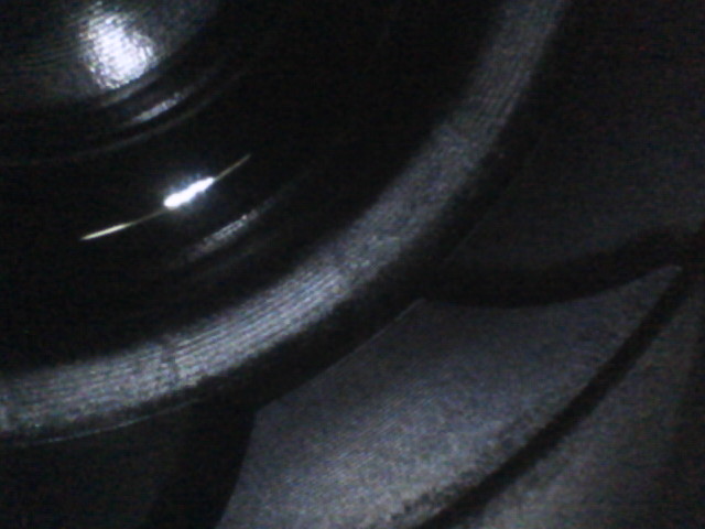

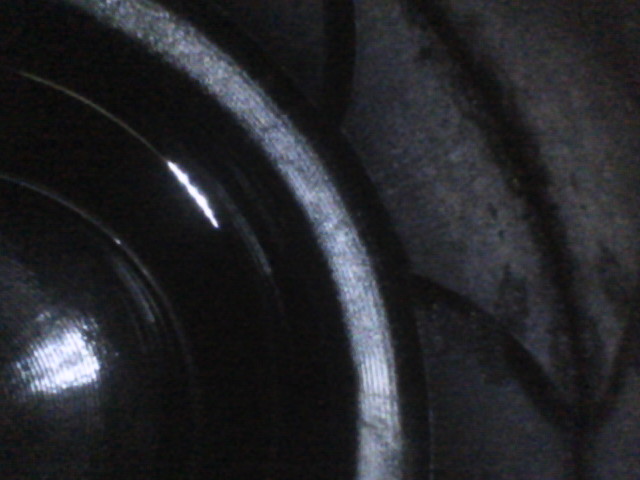

After I did an EGR tune up, and an overhead set, inspected cam lobes etc. I found the injector in cylinder num. 1 failed a Leak test, and all others passed. So I changed the bad one. Easy fix right? Wrong. The truck still smokes and has low power under heavy acceleration(with a load on). So I did the leak test again, this time all cylinders passed. Now what?
I bought a Snap on bore-scope tool to inspect each chamber.. I looked into cylinder num. 1 and found the sad sight of a slightly melted piston =(
./uploads/201911/post_4399_1574901759_2ee385a6d76c26cae36d3cbe2d346dd9.jpg./uploads/201911/post_4399_1574901858_361ebfccadcdd94bc1cb6cd72edcfcc5.jpg./uploads/201911/post_4399_1574902364_f3eb03049fc5a1a05a53c79e2118e459.jpg

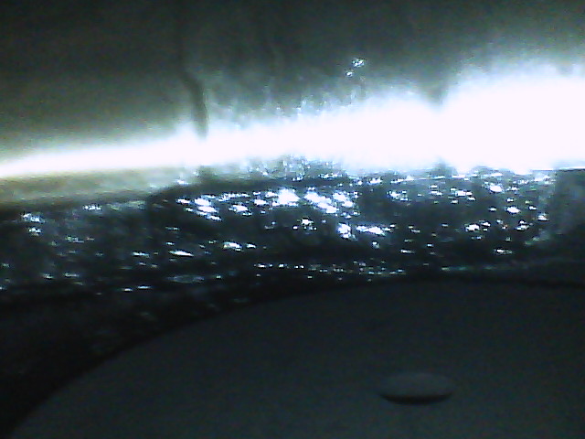

Slightly leaking oil also it seems..I’m assuming the bad injector caused this? but I’m not an expert
Cylinders 2-3 looked pretty normal, with some signs of age. I didn't continue to 4-6. ./uploads/201911/post_4399_1574901938_8f7dec560092e46529b7ef4b9ab05c96.jpg./uploads/201911/post_4399_1574902011_4c3c942b3d360abb6b8e7b9bb8ce8db3.jpg

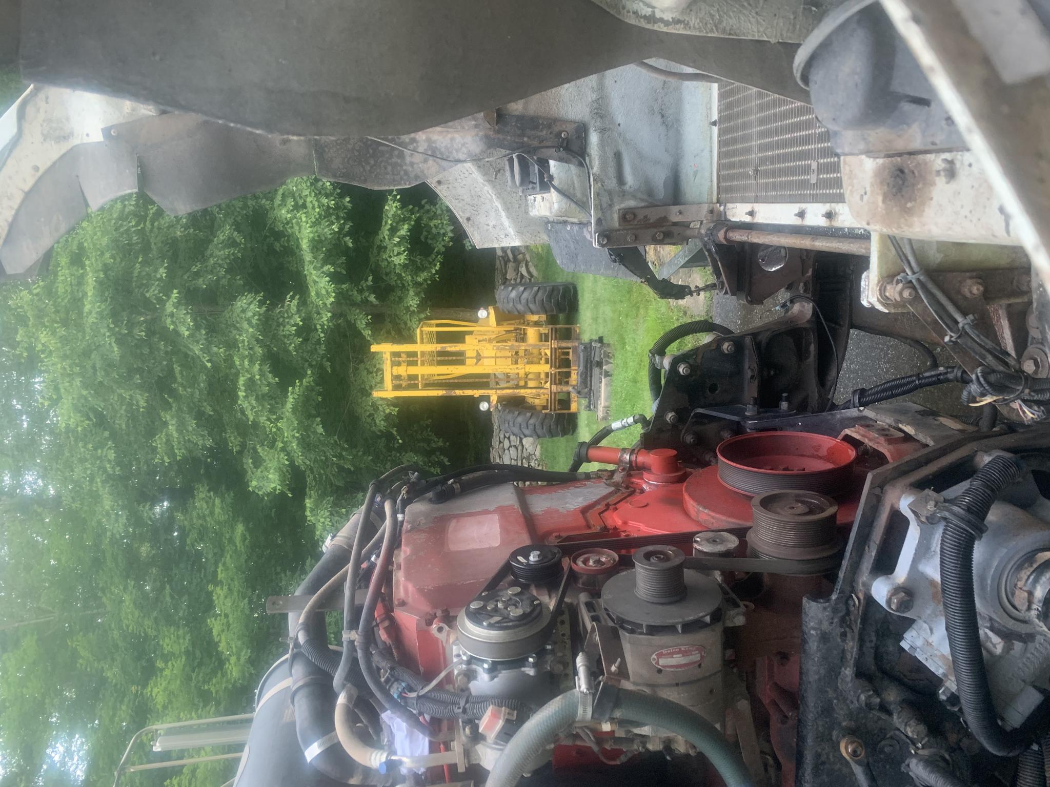

Sadly It looks like I need to plan a rebuild/ Inframe in the near future. Which sucks because the truck isn’t even paid off until April. I’m going to try and drive it “as is” for now, and hope for the best. Going as easy as possible..
I'm curious about the pros and cons of driving it like this. And was hoping to find some answers to some probably dumb questions. Like, what other components do I risk damaging? If I were to rebuild the engine wouldn’t we put all new internals anyway? Or do I run the risk or ruining the block? Should I go back in with the borescope tool and try to take more pics of anything specific? Should I preform anymore tests on the engine? should I stop driving it and get it rebuilt ASAP? There is some air coming out of the oil fill cap, but no smoke or oil spray. The truck doesn’t leave the state (Connecticut) so if a break down occurs it’s not a big deal. Hopefully I can get a second loan, or at least be able to put all the parts on a credit card to pay later. Is there a ballpark inframe $ number?
I want to personally thank everyone on this site for so much useful information. I am truly blessed we are full of active, knowledgeable members. I would be so lost right now if it wasn't for the information on here.
Hopefully my pictures and story help someone else one day, on things to look out for (such as high engine hours) And also not to let an injector leak very long if you think one is. (If that’s really what caused this) Also, even that your dad can be wrong LMAO just kidding.
Skip to here-
But the Most important question... how should I go about my overdue engine rebuild? I’ll be working outside, next to a double car garage for lots of bench room. I should be able to remove most things myself. I have a friend who can help me with the gears and static timing part. He has the pullers and wedges. But I don’t feel confident enough to counter bore the block. Nor do I want it done in the elements. Do any reliable company’s offer long blocks? Or short blocks with a core refund? I do want a brand new head, my cams and rockers are smooth but discolored. Should I re-use them? I will be spending a lot more time on here, reading and trying to educate myself. Is there a ballpark inframe $ number?

You should be good outside, just make sure you have something to remove and set the head with, a fork lift or some sort of gantry crane, it is heavy, and don't forget to remove the plugs from the old head which need to be installed in the new head...

Like Rawze said, get a canopy, I brought my own, the 8x8 one that Home Depot sells for around $79. Secure it to the truck with a rope from the center and you will have a nice work area. Or get the larger 10x10 and you can wall it off, which may be a better alternative to the smaller canopy.

Awesome, thank you for all of that information Waterloo. My neighbor does have an old forklift we used to remove my radiator once, but idles high and is jerky. Maybe ill try to fix it for him sometime soon. I think he said its a carburetor issue?
