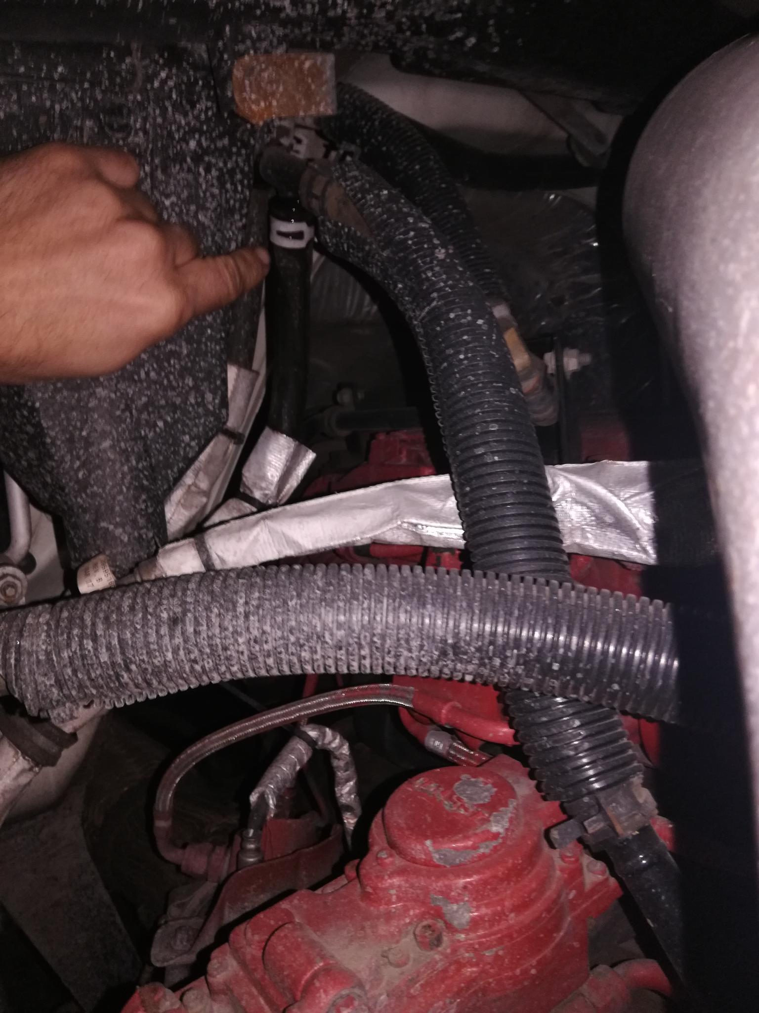

Could someone please point me to a diagram with precise detail of all the components of a CM2350?
It's on passenger side running from lower pulley from a black metal pipe up into the cab and back down into the small looking AC pipes leakage is reddish brown tint not too greasy.

pictures are horrid for id and no information which side its on but maybe the high pressure fuel pump?

Running through Utah that's why there's white sh*t splattered everywhere.

looks like heater core hoses for cab and the hose going down goes to bunk

100% coolant line. The main is heater core, this smaller could be bunk heater or DEF injector cooling.

If you are seeing rust color coolant and it is leaking, do you have heat in the cab through the front vents? Leakage is sometimes blockage, and that sounds like coolant, if it is, it sounds very old... When was the coolant system last flushed? I am thinking a possible heater core, not saying it is... Just going from my experience. Any water on the floor on the passenger side? The heater core is located in the dash, passenger side, you need to pull the AC box apart, there is a condenser in there and then your heater core. If the truck has sat, it is not uncommon to have those gunk up and fail. It is a $435 part last time I checked with International, I found one from Peterbilt for $200. This is a good time to familiarize yourself with your local FleetPride parts dealer...
When you get this truck home, it would be a good idea to drain the coolant system, and really inspect it. Drain out the coolant, all of it. Inspect the hoses for softness, pressurize the system to check for possible leaks and weak areas, bad clamps, cracked fittings, etc. Only you can do this right, a shop will just steal your money. Winter is coming and that is when everything fails under the hood.
Your coolant system, you cannot refill these systems like you would your car, this is an EPA truck, so you will need to pull a vacuum on the coolant system to refill. If you do not use a vacuum to refill, you risk an air pocket and possibly damaging the motor. Always fill with a vacuum.
Where to buy coolant, call FleetPride, they sell it by the case, usually around $9 a gallon for the red house brand, they call their house parts OTR. That is what I use. After two in frames, one learns quite a bit...
