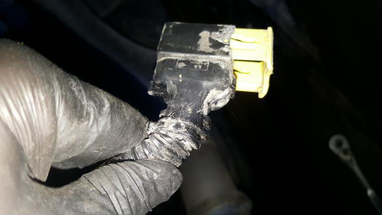

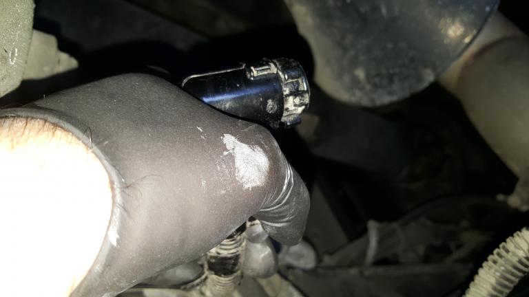

In case anybody gets stuck working on their def pump I took a pic of the clips that hold the def supply lines in place. They look like C-clips that you would pry off. DON'T PRY ON THEM!!!
You squeeze them together at the opening of the C and pull the line apart.
./uploads/201612/post_1421_1481986545_afce836c219a3547d6e8d30bd885239a.jpg
Also the wiring harness at the bottom of the pump has a locking mechanism that is yellow. You pry the yellow lock straight down to unhook the harness.
./uploads/201612/post_1421_1481986938_5856d3ec10f27b19421132426ae2d7bb.jpg
It's the "little things" like these that would be helpful to me so hopefully they'll help someone else too.
