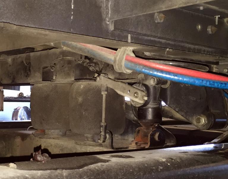

./uploads/201606/post_602_1466610164_55e3db3310c3db559b46be8e319a7030.jpeg

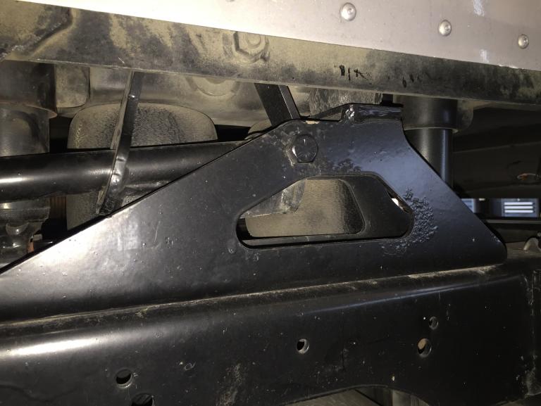

./uploads/201606/post_602_1466610330_69660553c70592688021c5eadf36e943.jpeg

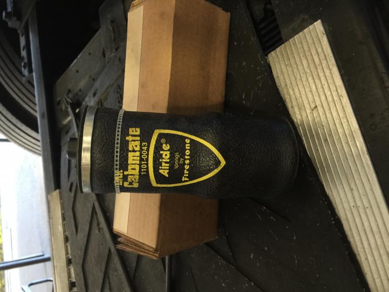

./uploads/201606/post_602_1466610405_4de642117ae5b68fa6a98eed641188ba.jpeg

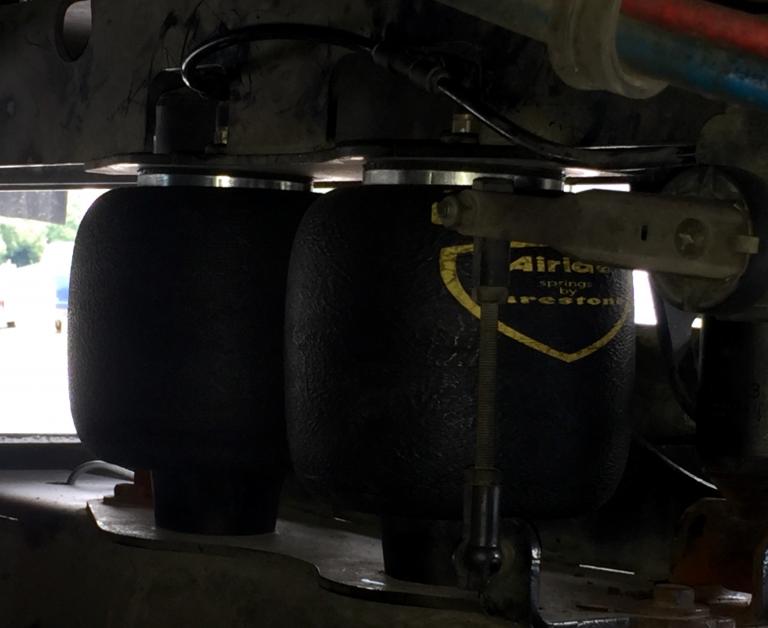

./uploads/201606/post_602_1466610469_e51d6372ddcdababfdbdd6c1c54a1c5a.jpeg

The new air springs fill up and mushroom out to a short and fat appearance after they fill up. So if your worried like I was about whether or not you got the right ones, you probably do. You just have to buy them by the VIN number and make sure they have the correct air fittings at the top.
