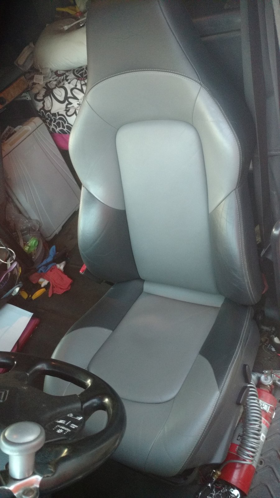

I have an 08 Prostar, I bought two six way heated seats from a Chrysler Crossfire for 400.00. They are both set up the same as far as controls. I only put the driver side in because I have one of those junk collectors on the back of the passenger. Besides the dawg is the only one who sits over there anyway. I made a mounting plate and wired it up. Looks great and everyone who sees and has sat in it loves it. Plus I have another when that one where's out.

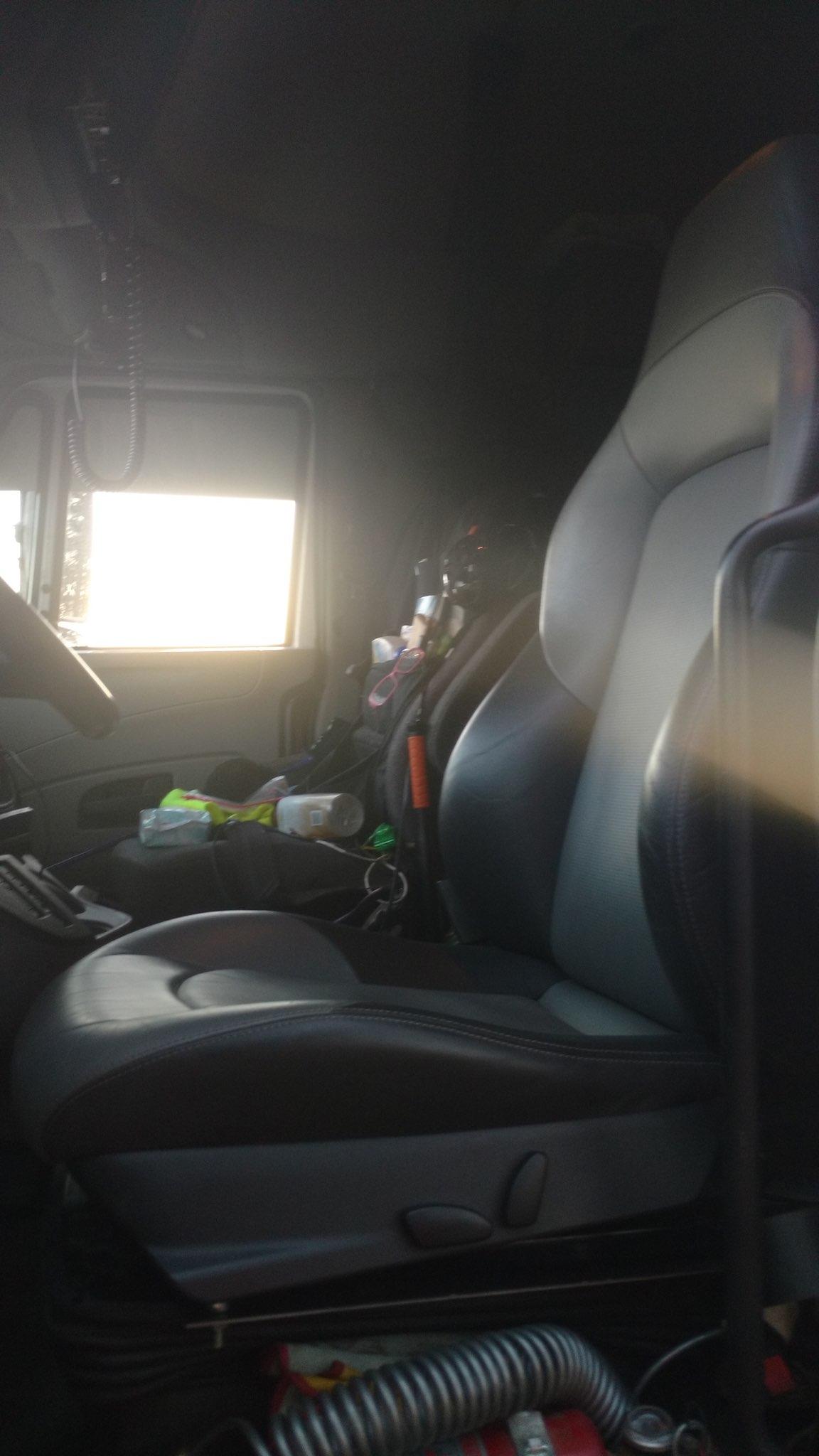

I know I'm glad I took the time and looked around and did the Crossfire seat in mine. I got them from a guy in the Charlotte NC area off of Craigslist. Not sure where he gets them but they are like new. I bought another set of Mazda 6 the speed addition and put them in my 06 Charger RT. But putting it in the prostar was easy. I removed the old seat and bolted a cut to size plate to the base of the air ride. Then bolted the seat to the plate. It sets lower but I still have the air ride if I want. Seat belt is still on the base so it's a safe and secure. I was going to get a set from him from a CTS-V but they had legs and I didn't want to mess with a bunch of fab work. But in my opinion it's worth looking at car or SUV seats. But I like making stuff and thinking out of the box.
