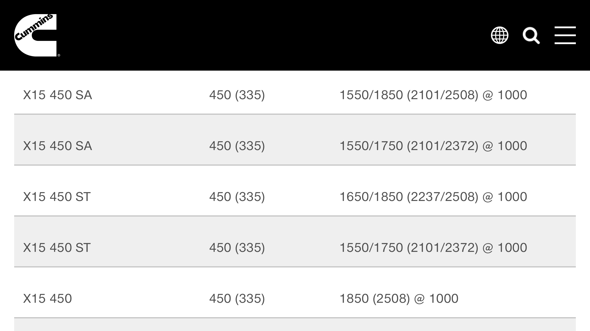

(12-17-2019 )marek4792 Wrote:  Not sure what your specs are but it's pretty much known here that you do not lug a Cummins below 1300 under any circumstance, have you ran an overhead yet you very well could have a bad camshaft already yes it's very common issue, also its about that time to rebuild that fuel pump they still fail like the older isx's but will not contaminate the oil passages. Have you done an egr tuneup yet?
Then why does Cummins list specs on there own website like this on the X15?
X15 450 SA
450 (335)
1550/1750 (2101/2372) @ 1000
Every X15 listed has its rated HP and Torqu at 1000 RPM. I would not think they would give the engine rating (the only engine rating) at an RPM that would damage the engine. That would be financial suicide.
./uploads/201912/post_4351_1577247903_af83e0b9effa059d4af661d3e2805bf0.png
12-25-2019, (Subject: X15 noise and lack of power on a hard pull. )
RE: X15 noise and lack of power on a hard pull.
It can run that low, the problem is that the liner and block design cannot handle low rpm high torque operation. The ISX and possibly X15 is known to sink liners because the way the piston and rod is moving in the cylinder, it is actually pushing the liner towards the exhaust side where most failures become obvious. Lugging the engine causes most of the liner vibrations making it eventually sink on the exhaust side. Also poor deck height plays a role amplifying the issue as well.
Sounds like your gearing is right for direct drive sucks it's a 10 speed, 13 or 18 would greatly benefit the truck especially if you get it reprogrammed or put a manual in it. Another thing, cummins could give a less of a poop about the initial sales because they make their bank on aftermarket parts! Design it to last long enough for it to fail conveniently outside the warranty period so they can screw you dry on a $25-30k overhaul at 500k miles. My buddy went through this very scenario at 450k miles sunk a liner causing head gasket failure, decided after the overhaul and having to start replacing parts he'd be more financially viable trading it for a brand new one (Cali based) and starting fresh again.
