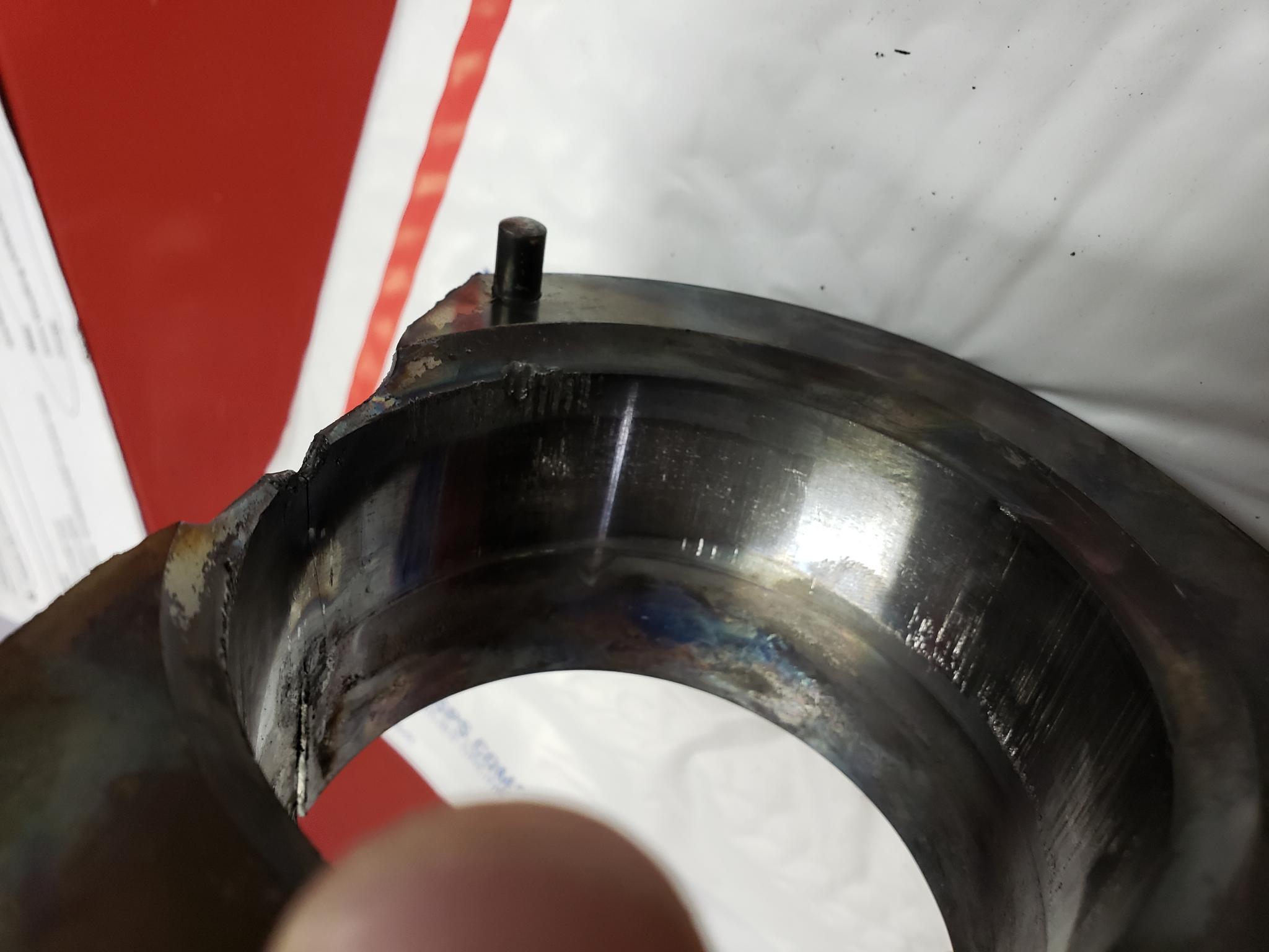

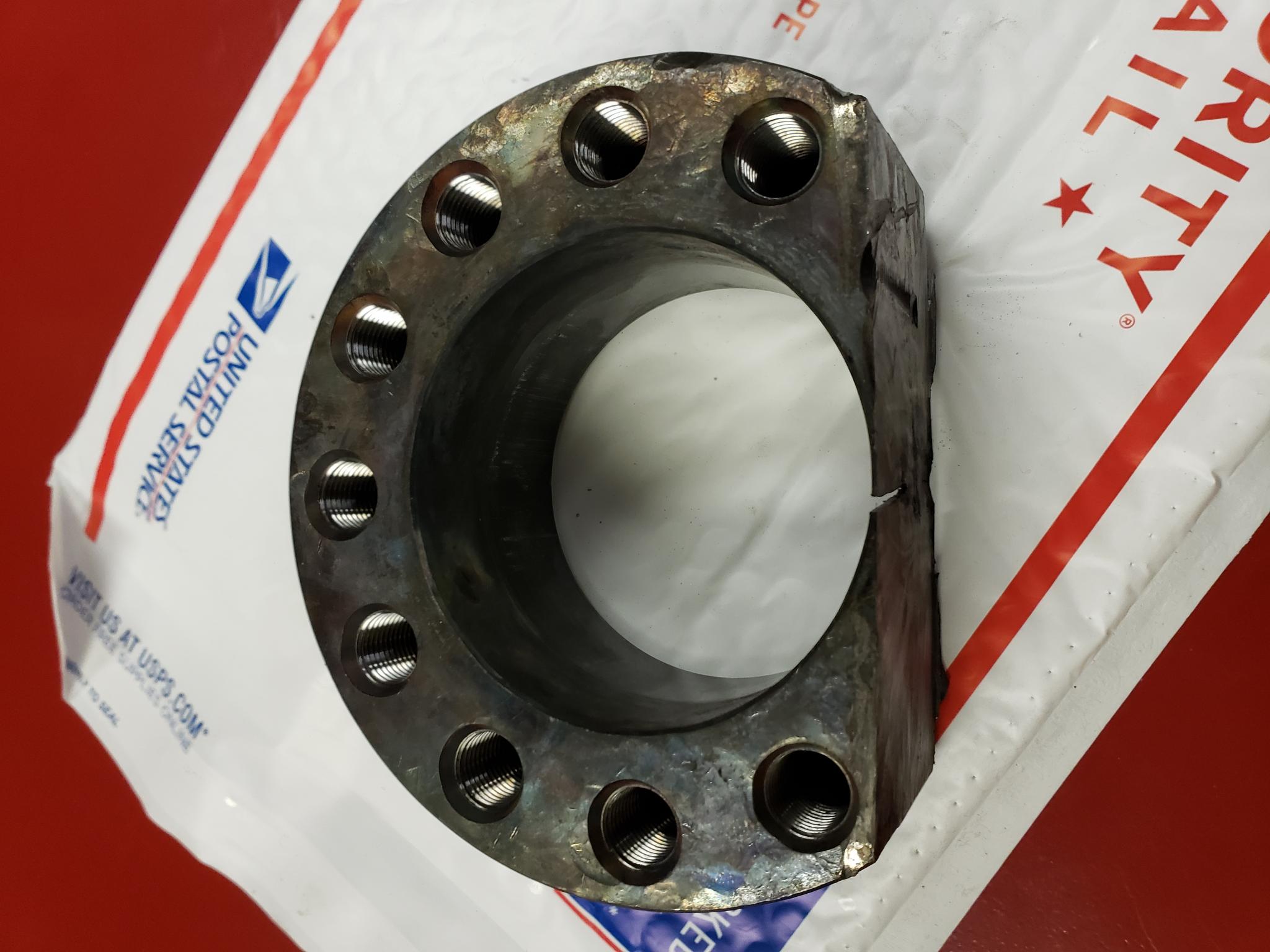

Anyone done this, it's a motherfcuker. I got the adapter off. I ground down a slot and cracked it in half. I also did the same thing to the brand new one I did not get hot enough to slide on all the way. Heating it for 5 hours in my oven at max was not enough. I'm going to bake this one then blast it with a propane torch with a large 3in tip for half hour or so prior to this next try. I'm also going to put dry ice on the shaft and keep that wrapped tight until I'm ready to install again.
Any pointers are appreciated.

Baked in the oven 6 hours to 500F then the torch got it up to about 700 and it went right on. Shes up and running, heading out to pick up a load in a few hours.
If anyone ever has any questions about this fun procedure I'm happy to help with anything I can.

It wasn't hard at all. If it's hot enough it will go right on and it will rotate freely. I had to hold it in place about 30 seconds until it cooled down. I hope I can help someone down the line. Bake it for 6 hours, then blast it with a rosebud. I also setup a space heater to try to warm up the air around the front of the motor. I did it outside in about 40F temps.
As long as it's hot enough you won't have trouble. doesn't need to be entirely red hot but it should be glowing a little. 700 F is not going to hurt it. I've got 200 mile son it so far, all is well, next I'll be doing the leaky rear main. haha. I sure am looking forward to my new quickserv account!!!
