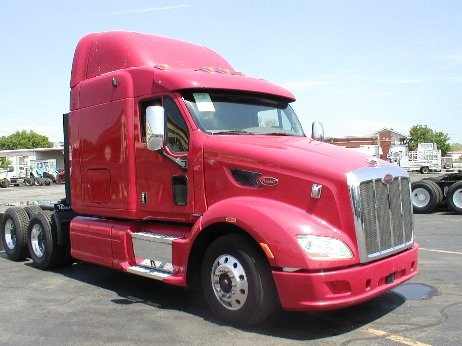

2012 Peterbilt 587 Mid-Roof
Cummins ISX cm2250
Eaton 13 Speed
3.42 Rears
220" Wheelbase
Dual 100 80 gallon tanks
