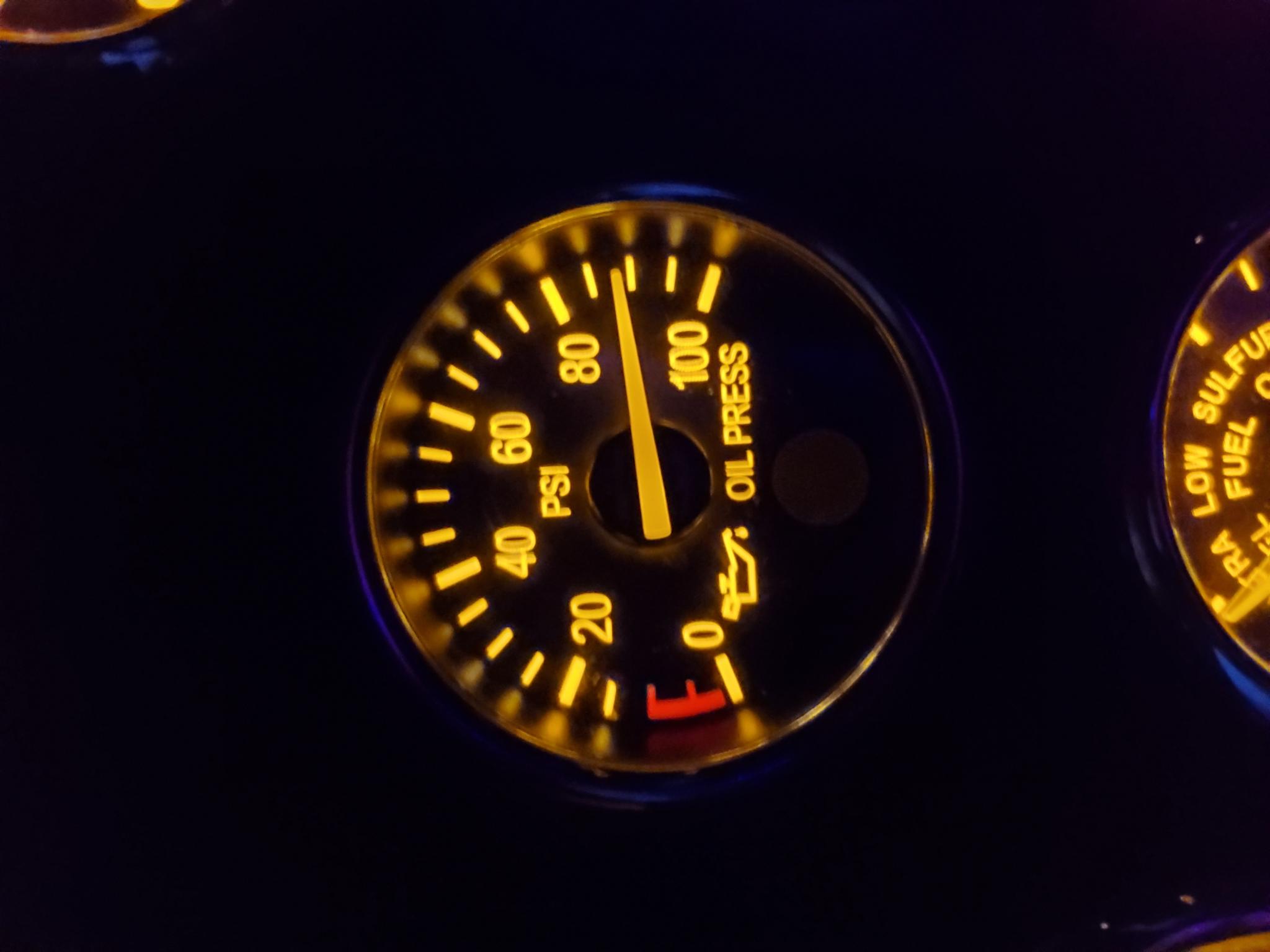

(01-23-2020 )Billy7871 Wrote:  The past 2 mornings 21 yesterday and 40 this morning my oil pressure at start up was 90 psi. Stay that high about 2 or 3 minutes then started coming down. Any thoughts?
replace the oil pressure sensor on the engine.
If that reading of 90 psi is correct, you have some kind of serious issues there and it needs to be looked at. ISX should not see much above about 40-45 or so, or things start to fail like the front or rear housing gaskets.

I replaced the pressure sensor and it took care of it. It had about a bottle cap of oil in the plug. Thanks for your help.

Don't be surprised if that sensor only lasts another couple years. I just replaced my OEM sensor again after 2 years. It had oil in it again.

Start the truck this morning and 90 psi on this sensor. It stays that high for 3 minutes or so and comes back down.

Just for reference, my cm2250 usually reads about 42-48 psi (725 rpm idle) on a cold start, then it slowly drops down to about 19-20 @ 725 rpm idle or 34-38 around 1500 rpm. However it can take up to 10-15 minutes before it gets there. If I increase the rpms or start driving sooner then it will reach it's typical operating range quicker. I'm running Delo 15w40, no gear lube. I haven't changed the oil pressure sensor yet but I will probably do it soon as I just noticed some oil build up around the area of the sensor.

(01-27-2020 )Billy7871 Wrote:  Start the truck this morning and 90 psi on this sensor. It stays that high for 3 minutes or so and comes back down.
you need to get that fixed asap.
if u cant figure it out, maybe make appointment w mr. hags?
most likely, if it is actual pressure and not mis-reading,.. is is going to the regulator in the oil pump that is bad,.. or you have a restricted passageway that feeds it behind your front gear cover.
Has the head, cams, valve train, oil pump, gear cover, or anything else been worked on recently?
