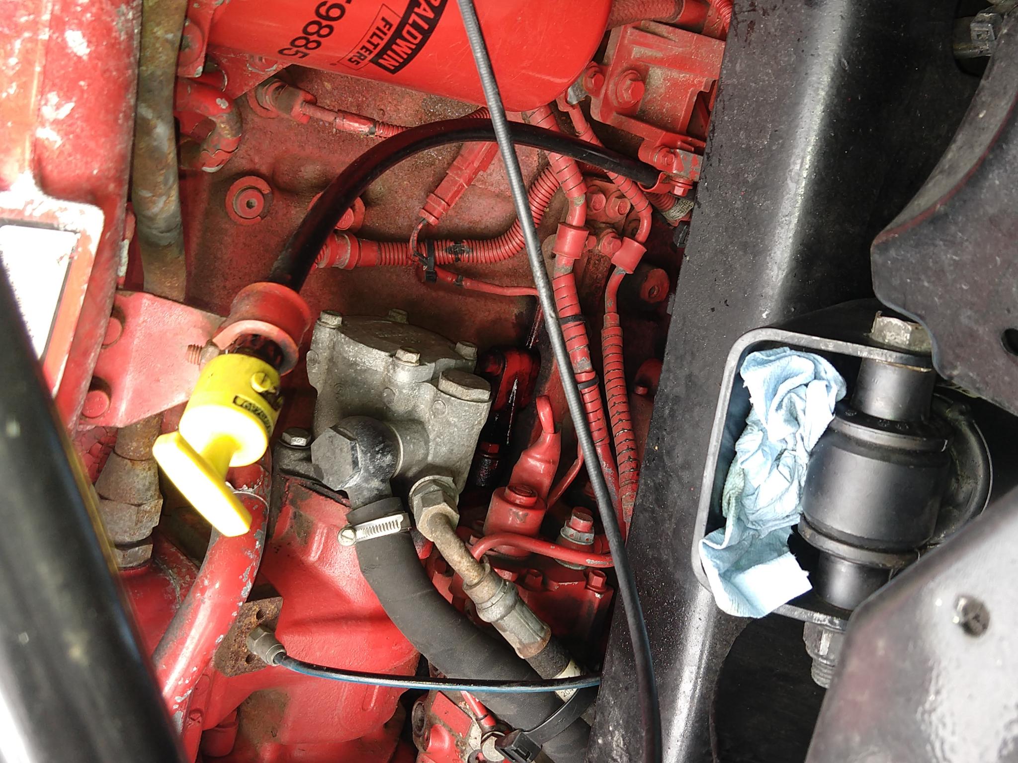

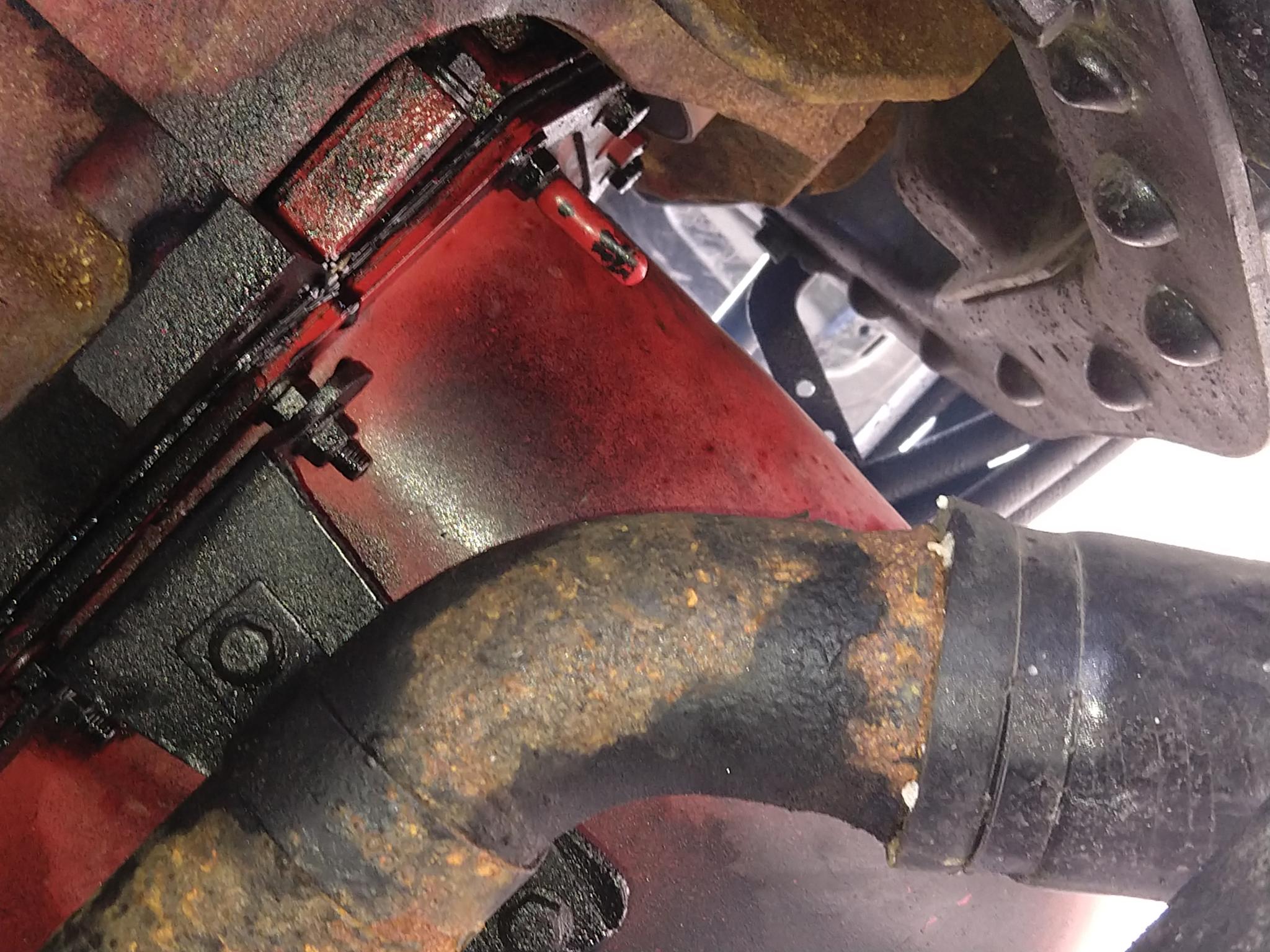

@waterloo thanks guys for the quick response! I took some pictures, and I yes it seems to be coming from the back of the air compressor down to the bottom right of the oil pan not sure. But it only does that when it idles to warm up and then it stops. I will bring it to the shop asap.

RE: Severe oil leak...ahh sh*** here we go again
Need to wash it good. Make sure its not the crank seal...These are prone to front cover leaks when cold when heated up it swells the aluminum housing and stops...
