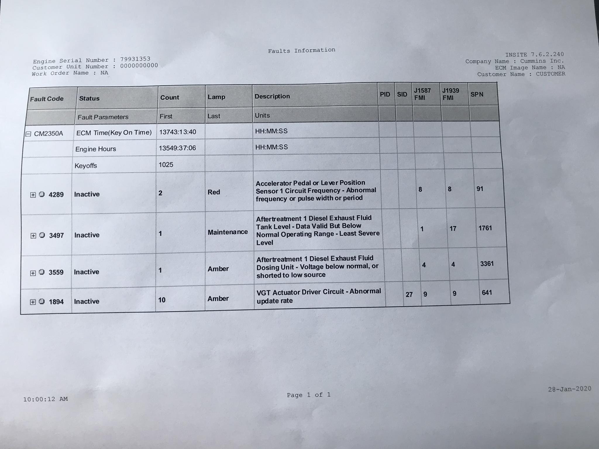

      What’s the first thing to do now that I know I have a code 1894? 2016 ISX 500 cm 2350. Check engine light came on once yesterday and once today. Paid a local shop $50 to read my codes. After he did that the truck cleared codes and shows no active faults on the message screen. Thanks in advance! I really appreciate all your guy’s advice. Can I take the top off and look in the actuator?

Yes this is a continuation. I guess I’m too dense to understand why the truck clears the codes to read no faults found. So do you think the Turbo and actuator are possibly going out or could the fault be caused by electrical problems?

(01-28-2020 )farmer70 Wrote:  I guess I’m too dense to understand why the truck clears the codes to read no faults found.
The truck doesn't 'clear' the code per say... The OEM side display is programmed to just annunciate any active codes present in the ECM. If they "go away" on the dash it just means they have gone inactive. All the inactive codes remain in the fault code history inside the ECM until they are reset with insite.
 Thanks given by: JimT , farmer70
01-29-2020, (Subject: Code 1894 Now what? )
RE: Code 1894 Now what?
So it can be inactive and everything will work ok? But if it is something really serious it will stay active? That code about the DEF unit was weird because it was full of DEF truck was bumped up to about 1100 rpm and out of nowhere the DEF light inside the DEF gauge comes on, the message center screen says DE RATE eminent. It was cold that night I wonder if it had something to do with that?
