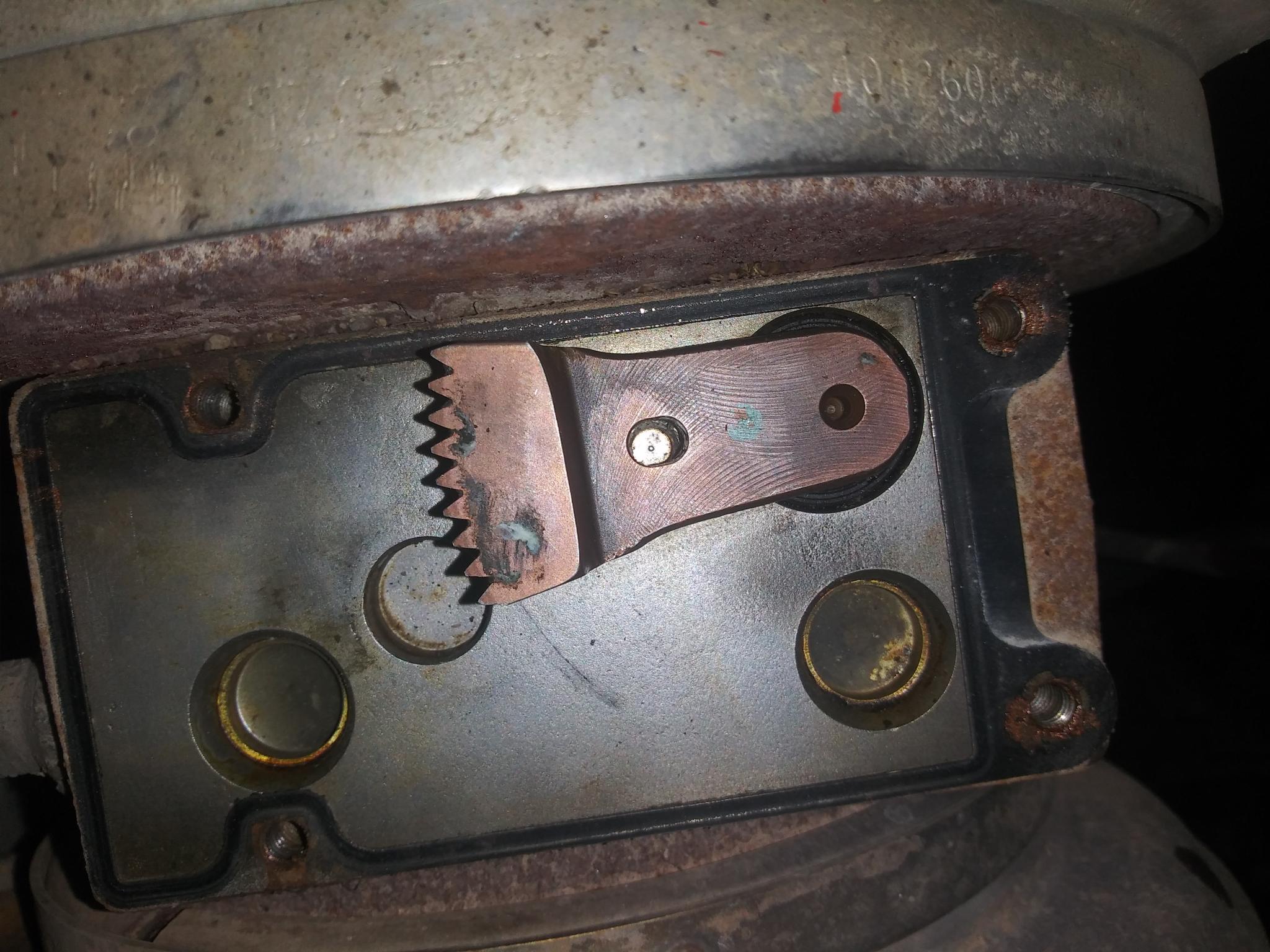

Wow.....that's alot of "rattling around" ;-). It sounds like a stock re-man is all I would need.
I have taken the actuator back part and here (I hope) is a picture of it. This first pic is with the actuator arm all the rear of the motor, which after watching Rawze's videos I don't think it is going all the way back.
You can see it has rubbed the top of the housing and has gone farther back in the past. It moves back and forth without any hesitations, but firmly. It also makes a little metal to metal noise when moved.
My actuator will rotate with your fingers, but very firmly without any play back and forth. My actuator will also calibrate with insite, so do you think my actuator is still good?

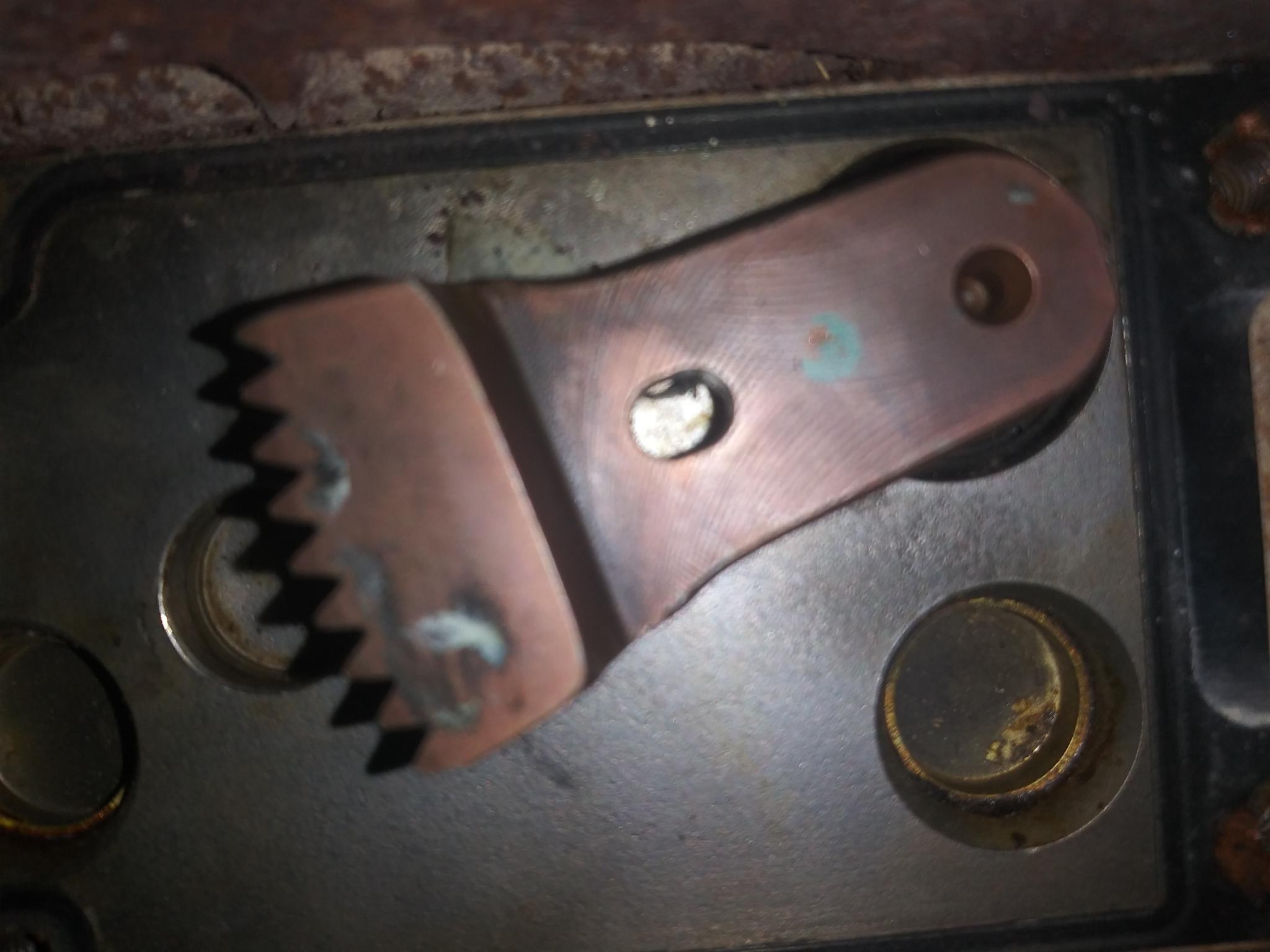

This second picture is of the actuator arm all the way forward.
I tried to put both pictures in one post but it wouldn't load 2 of them??? Can someone give me some tips?

turbo is toast. It is hitting the VGplate and it is not moving all the way to the left like it should.
 Thanks given by: Roysbigtoys
03-19-2020, (Subject: No boost......no power )
Post: #35
RE: No boost......no power
(03-19-2020 )Rawze Wrote:  turbo is toast. It is hitting the VGplate and it is not moving all the way to the left like it should.
That's what I was thinking also.
What are your thoughts on the actuator?
