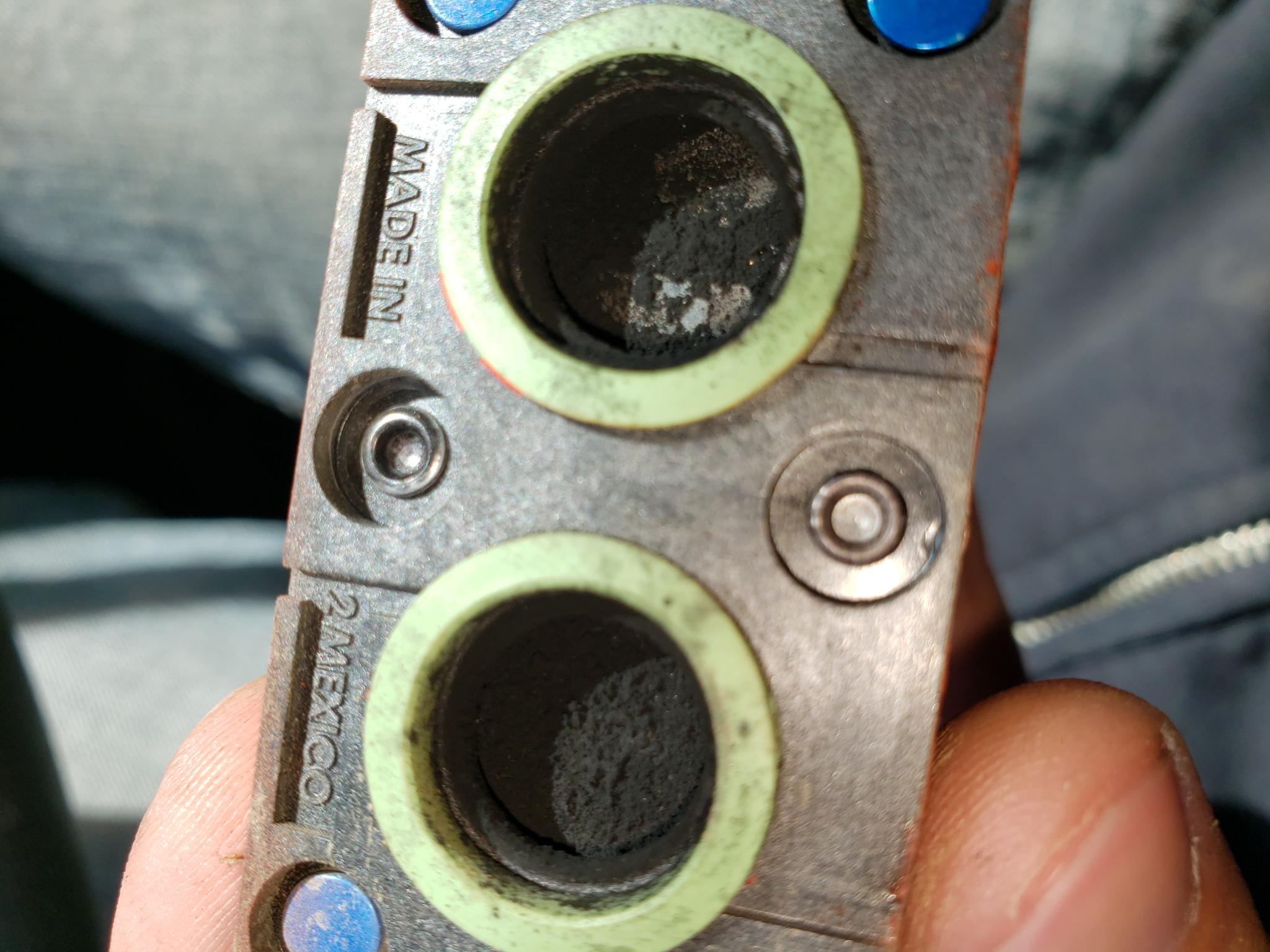

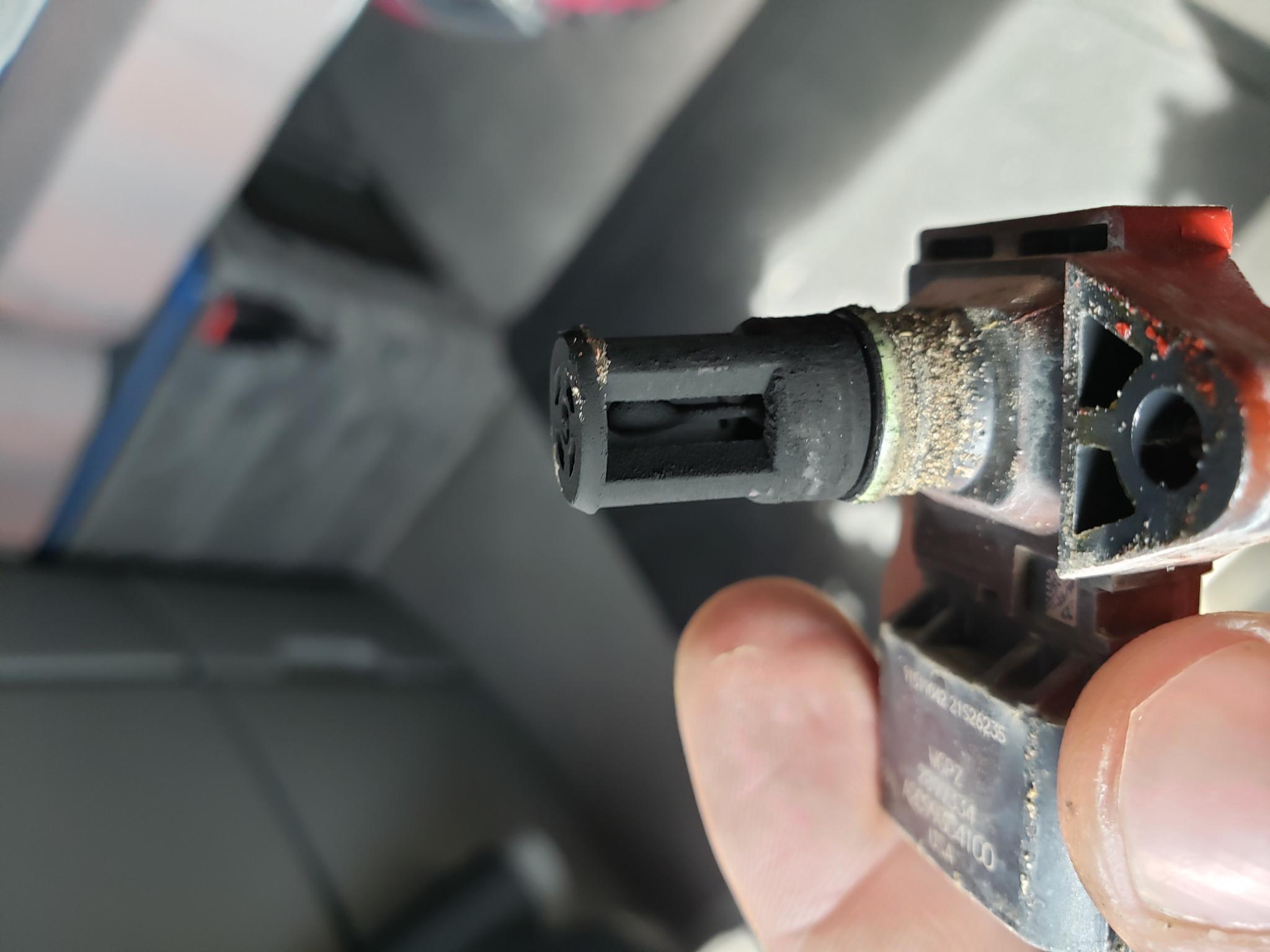

X15 EGR tuneup So I've posted the part numbers a few times here so I thought I'd post them in a new thread here just changed mine out at 113000 miles to see how they looked. Pretty straight forward like the 2350 ISX but there are only four sensors to change instead of 5. I did not remove the EGR crossover as I intend to clean it when I run the overhead. Egr temp #5461596 Egr differential #4358939 Exhaust pressure #4928594 Imap #2897334 | |||

RE: X15 EGR tuneup seeing that much build up on those parts just makes you cringe at how much the motor ate. User's Signature: 2010 Lonestar - CM871 - 13sp - 3.70s, 2016 T680 - cm2350 - 13sp - 3.36s - skateboarder | |||

RE: X15 EGR tuneup ^^—— That’s what I was thinking...at only a 113k. Def the reason engine life expectancy is half or less of what it once was ...smh. | |||

RE: X15 EGR tuneup I’m hitting 125k miles on my X15 this week and figured it’s time. Is it recommended to replace these sensors or can some of them be cleaned and reused? Are these all relatively easy to find/access, and do you remember what tools are needed? | |||
05-27-2020, (Subject: X15 EGR tuneup ) Post: #7 | |||
RE: X15 EGR tuneup all easy to get to, can't remember exactly what tools you'll need but nothing exotic. I didn't bother to clean any of them i just replaced them with new. I also replaced the short steel tube from the exhaust manifold to the exhaust back pressure sensor because they get Carboned up inside. If you decide to do that you'll likely need a little help from the fire wrench to get it unscrewed from the manifold. User's Signature: im_seeing_parameters_in_my_sleep 1 | |||
