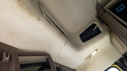

In our search for a HDT, one rolled into the Volvo dealership (consignment) just off the road. 2015 630, bit over 500k miles. The small trucking firm has bought all their trucks from this dealer over the years, so they know him well. He runs 5 or so rigs. The nice thing about this truck is that it has not been detailed.. It is what it was when it drove in. Outside looks like a truck off the road during winter. Under the dirt is a really good looking exterior. Minimal rust on the rear frame and drive gear. The interior is another story. It's really, really dirty. And the dude was a smoker. So there's that.
Question(s):
- smoke smell, can it be neutralized?
- I have a link to show watermarks on the interior fabric. Link to a .zip file of the images . Some water marks around the rear ceiling speakers, overhead windshield storage. Thoughts on what caused those and can the source be sealed? The salesman said it is common for these trucks that run on the east coast (it has a NY road tag on the front and Utah plates), and the top seam can be resealed. True? False?

Volvo notorious for ceiling leaking. Water got inside the cab structure thru bad seal on side top windows. Every time I got in area with rain and blowing wind or snow some water gets in between cab and fabric panels, it's leaking toward front and down. You can easily clean it with dump sponge and Oxy for laundry.
Every truck has NY sticker on the front. If license plate is UT truck is from UT.
