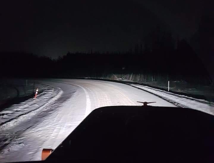

(03-21-2020 )Mattman Wrote:  T660 low beams are weak if you have one of these trucks. They use the projector style headlight. Got me some fog lights that really helped.
I am 95% sure that t660 projector can be pulled out the back and replaced with a bixenon evoxr 2.0 from the retrofit source. You would then need to buy a hid bulb and ballast but it would give you absolute savage light output low and high beam.
