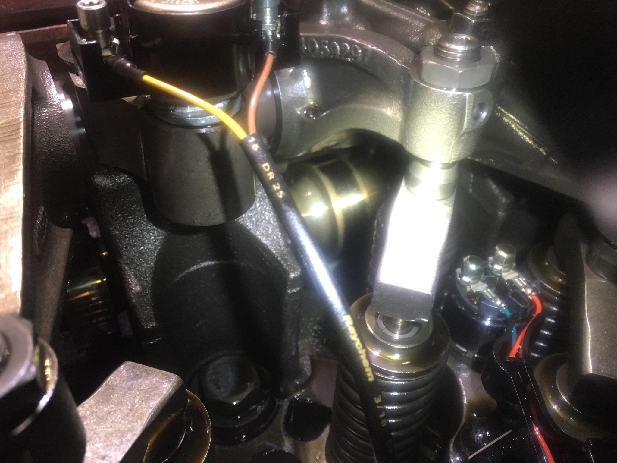

The oil pan went back on today!! Woo hoo! I enlisted my brother to help. I had a plan to use a floor jack if I had to do it by myself, but I am glad it didn’t come to that.
The bottom went together and the top came apart. My beautiful wife helped me do an overhead. The cam looks good. I do have a little brass showing but at 764K I think it looks pretty good.
Now I am trying to decide whether I should pull the exhaust apart to test the exhaust/ intake, turbo, and CAC for leaks? I don’t suspect anything is leaking so I don’t know?

What was the detent clearances after adjustments?. At nearly 800k miles, it is time to check it while your in there and see how much valve seat wear there is in the top end.

They all seemed to have ample detent, but I’ll throw the caliper on each one tomorrow before I bolt the cover down and post my findings.
