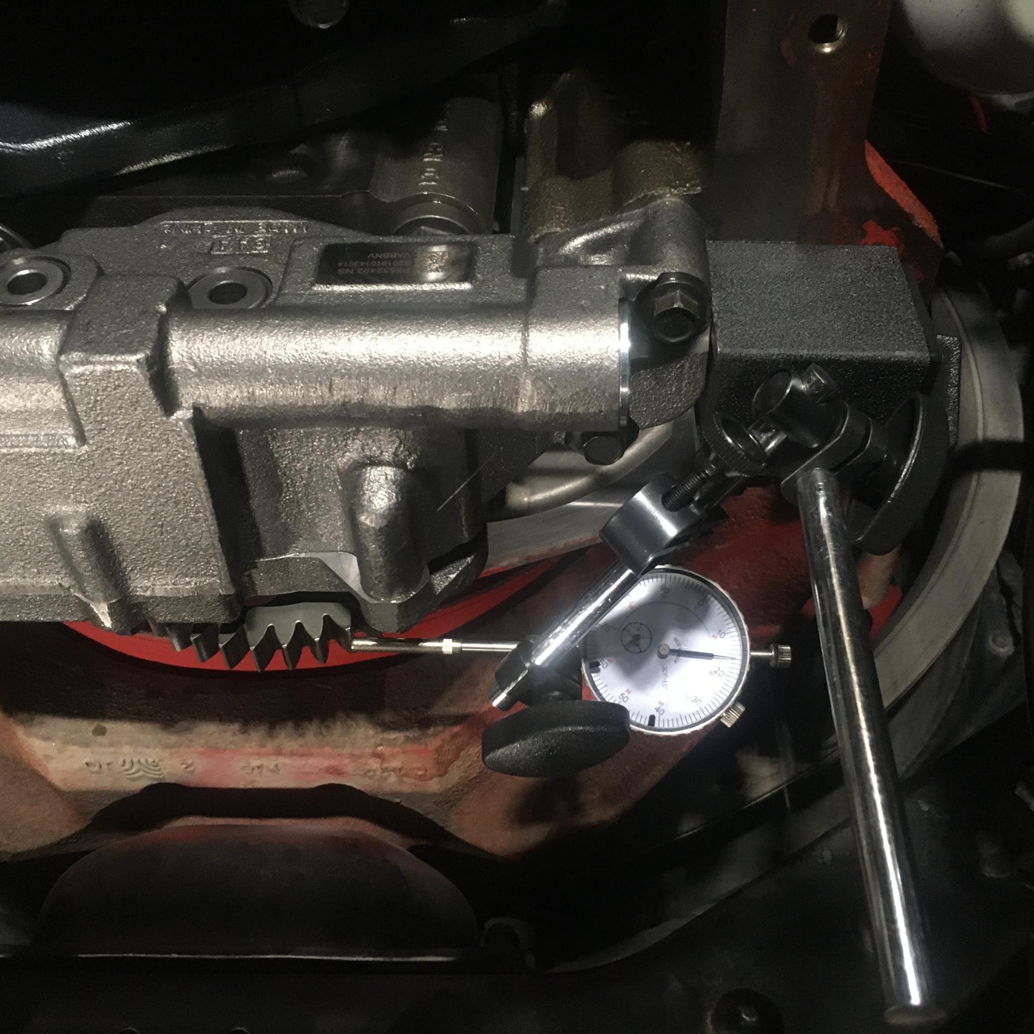

The gear lash was well within spec off the truck and also when mounted. I also pre-lubed it so it didn’t start dry. I did notice the wider gears of the new pump run at a different spot on the crank gear. Could that be the howling? Or did I get a brand new but bad part?? (I just read an article claiming nearly 30% of all new parts are bad) or maybe it is fine but it’s just going to be noisy?

Thanks Uni, I’ll look for the TSB. The lash seemed fine though. The pump itself idler to drive gear was .006” off the truck. Then mounted up it had .017” at the bottom gear. Which makes the idler to crank .011”, the spec said .003”-.022” Where I am showing .011”

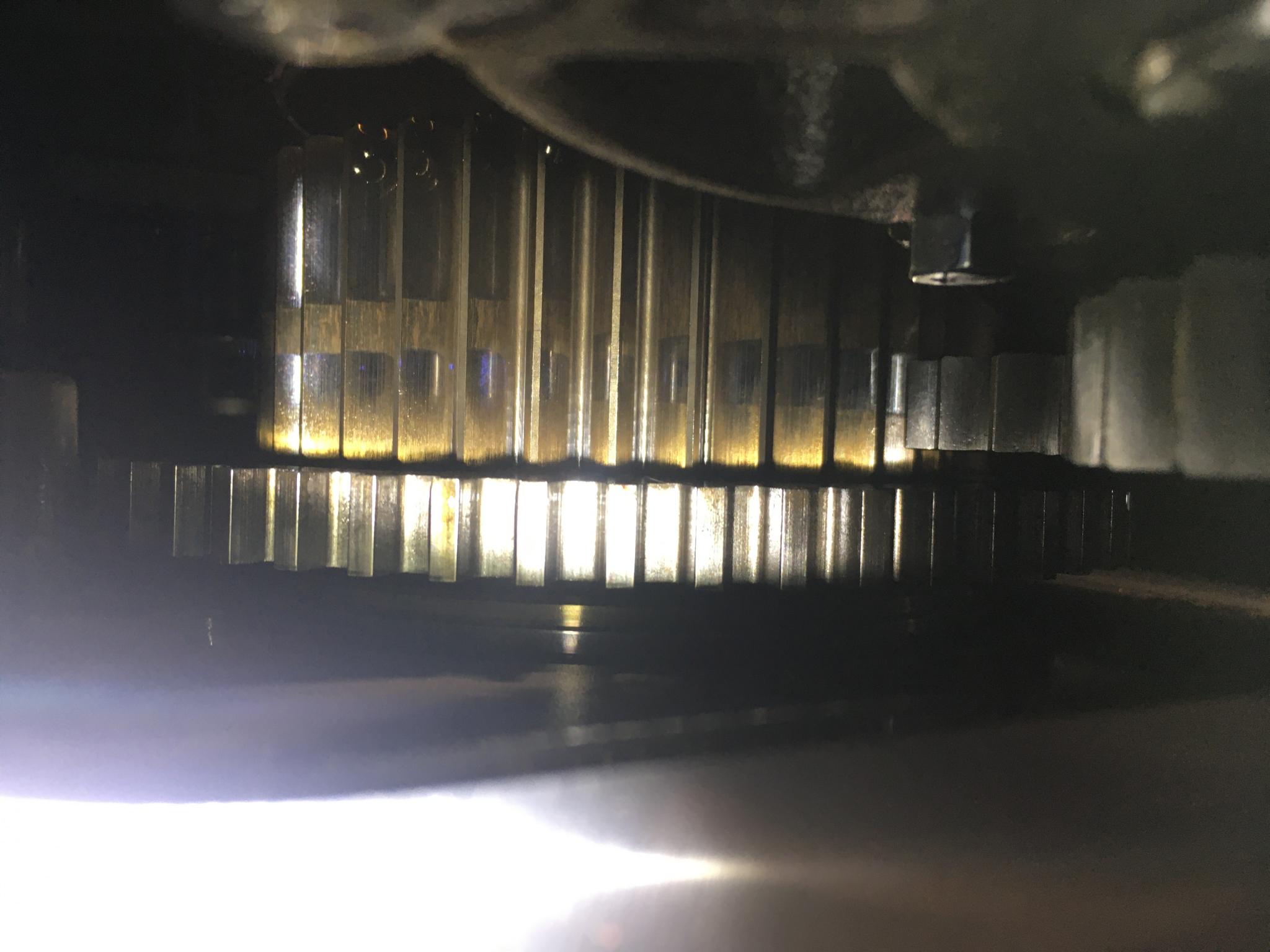

I just keep thinking when I put the new pump in and looked up at how it mated to the crank gear, I noticed that because it’s gears were wider then the ones on the old style pump,***(not correct)*** they touched the crank halfway on the wear marks left by the narrower gears of the old style pump and halfway on “new” previously untouched surface on the crank gear teeth.*** Zoom way in on the pic and you’ll see it. Sorry for the weird angle.

Thanks marek4792! Well by that bulletin they say just leave it alone because they don't have a fix for it yet. Man I wish I would have seen that before I replaced my old style pump. I think if the pan comes off again, I'll put the old one back on....
