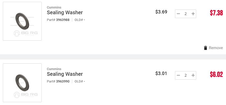

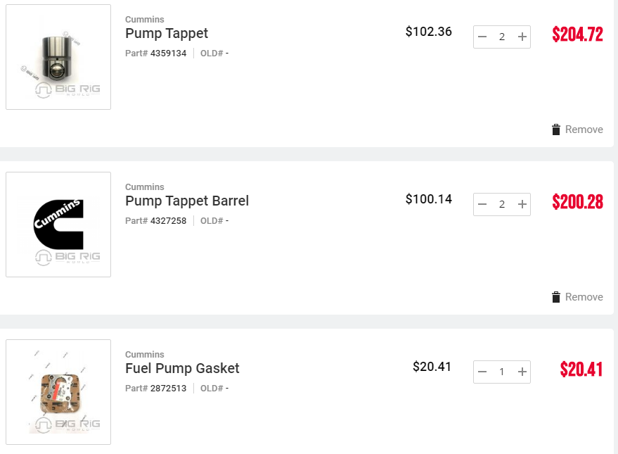

At Rawze's direction I am going to rebuild the fuel pump on my 2350. It's setting north of 300k miles since it took down the engine back at 245k or so, which was before I owned the truck.
Can someone who has done this please take a look at the parts lists I came up with off of quick serve and perhaps confirm that these are correct and is there anything else I need to replace while I'm in there?
If there's anyone who may have a better source on pricing, please let me know. The total on these is about $440. Rush Truck here in Dallas is over $500 for the same items NOT including the gasket which they don't even have.
./uploads/202004/post_3209_1586886796_3f91a5447e097265283d8ee4bbfc0891.png./uploads/202004/post_3209_1586886814_6cf5e686d0fcc6a1d7af3cf010f02e2f.png

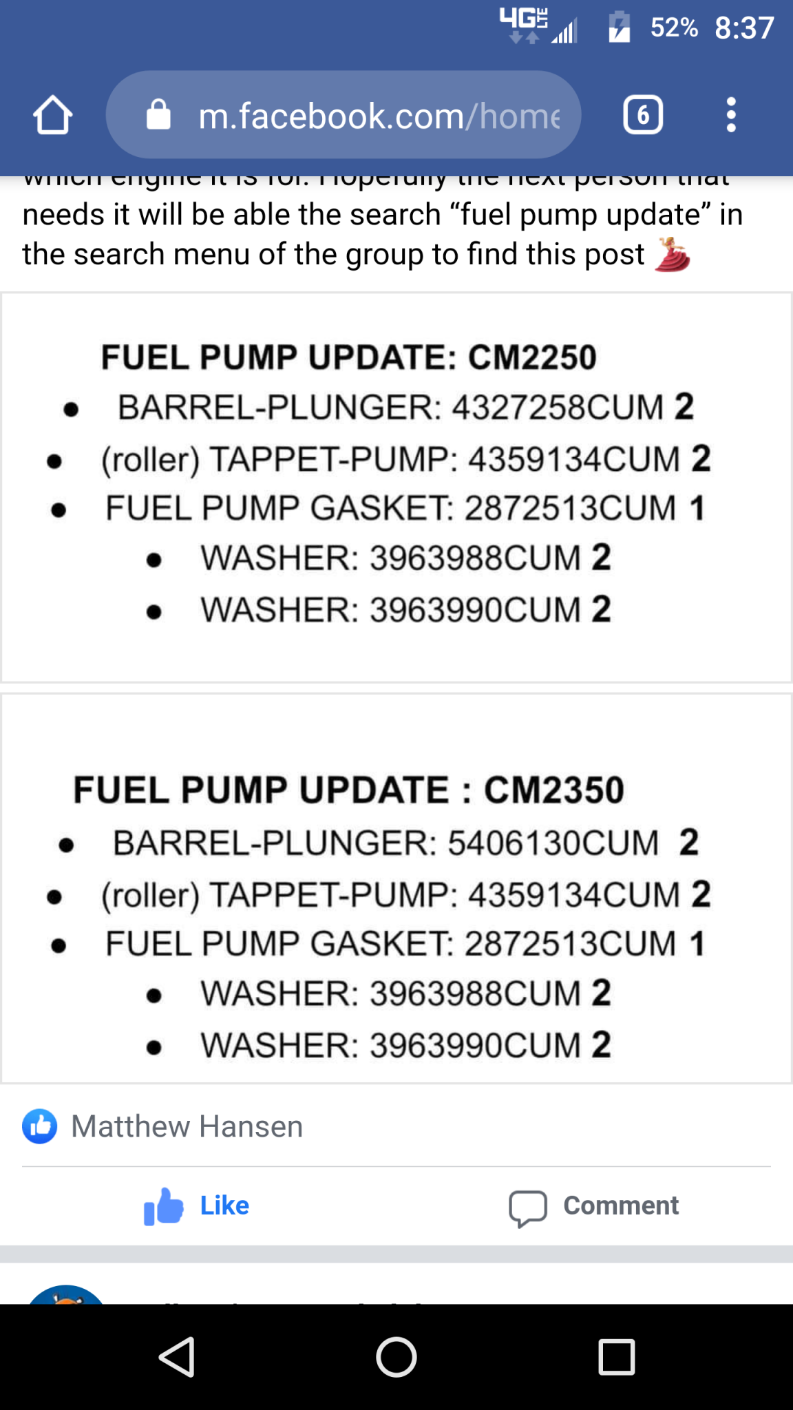

2250 and 2350 barrels and plungers do not interchange. Off the top of my head i think the barrel/plungers you have there are for 2250 not 2350. I would have to verify.

You can still buy Barrels, but plungers(they go into a pump head) are not available. Maybe you can buy those somewhere under the table, but no dealer or Cummins shop cares them separately. Whole pump head has to be replaced.
And ,yes do not try to install plungers from 2250 on 2350 pump head, you will have fuel in your oil pan. A lot of fuel...

(04-14-2020 )Unilevers Wrote:  2250 and 2350 barrels and plungers do not interchange. Off the top of my head i think the barrel/plungers you have there are for 2250 not 2350. I would have to verify.
That would be great if you could. I put my engine # into quickserve and one place it gives that number I showed above then again in another location it gives me 2872226. So yes I'm wildly confused.

I believe these to be the part numbers you need. I would verify before purchase and installing.
 Thanks given by: kozakvod

Mattman YOU DA MAN!
I spoke with Cummins and the numbers for the 2350 are correct.
He also told me that it's only certain engines that the rebuild is NOT available. Thankfully my engine all rebuild parts are available.
#5406130 Barrel-Plunger $71 ea
#4359134 Tappet-Pump $113 ea
#2872513 Gasket $23 ea
#3963988* Washer $3-5 ea
#3963990* Washer $3-5 ea
* Two different part numbers available for my engine and need to confirm
So the total would be $407 + Tax which ends up being almost $100 less than buying from those jack-offs at Rush Truck.
