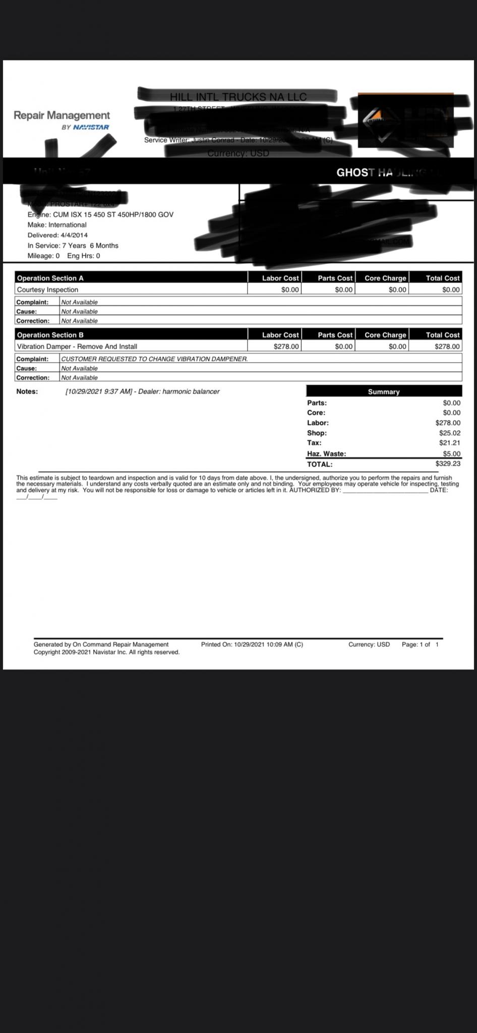

So after buying the part The shop manager sent me this estimate LOL this is what I was saying in my previous posts they give an estimate and then you think great that’s not bad so you drop the truck off expecting to get it back later that day and then they keep it for three days and then tell you it’s $2000 that place never honors their estimates and the final price has never been close.

I'd tell that shop to stuff it they can't exceed a written estimate by more than 15% without written consent. I used to work in a shop.

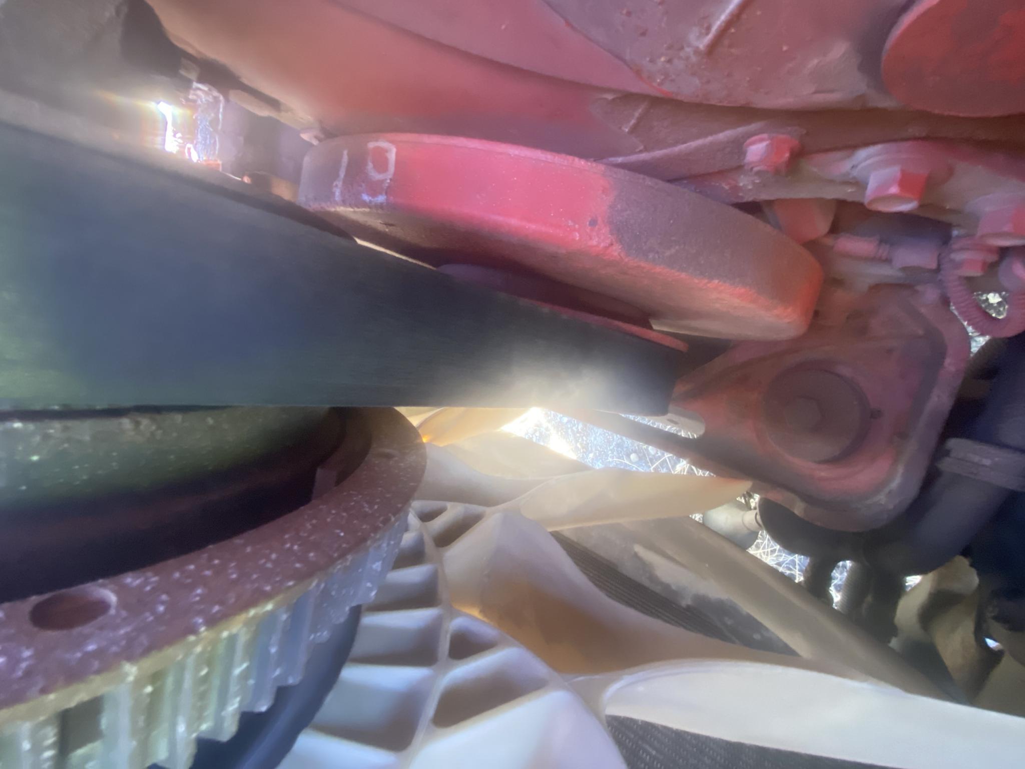

Here a pic of mine. It looks like somebody wrote 19 on it I don’t know if that just means they inspected it or if they changed it in 2019 either way I have no records and neither does the Steeler ship of it being done. 2019 is when the inframe was done. It had 398k when it had the Inframe under warranty by the dealer
10-29-2021, (Subject: vibration damper thoughts )
Post: #45
RE: vibration damper thoughts
(10-29-2021 )GhostHauling Wrote:  Here a pic of mine. It looks like somebody wrote 19 on it I don’t know if that just means they inspected it or if they changed it in 2019 either way I have no records and neither does the Steeler ship of it being done. 2019 is when the inframe was done. It had 398k when it had the Inframe under warranty by the dealer
Well, the best way to know is to change it yourself with a new OEM dampener? Looks original by the picture…
