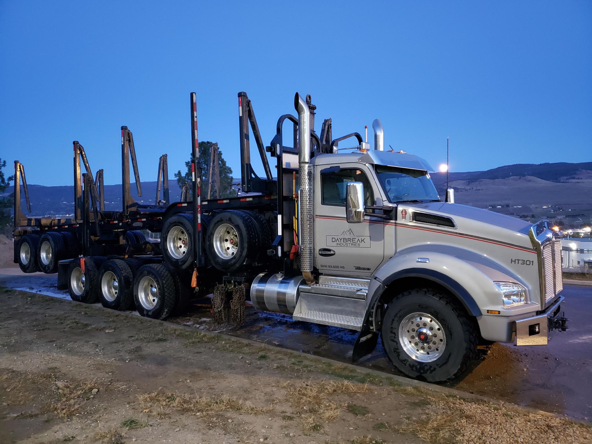

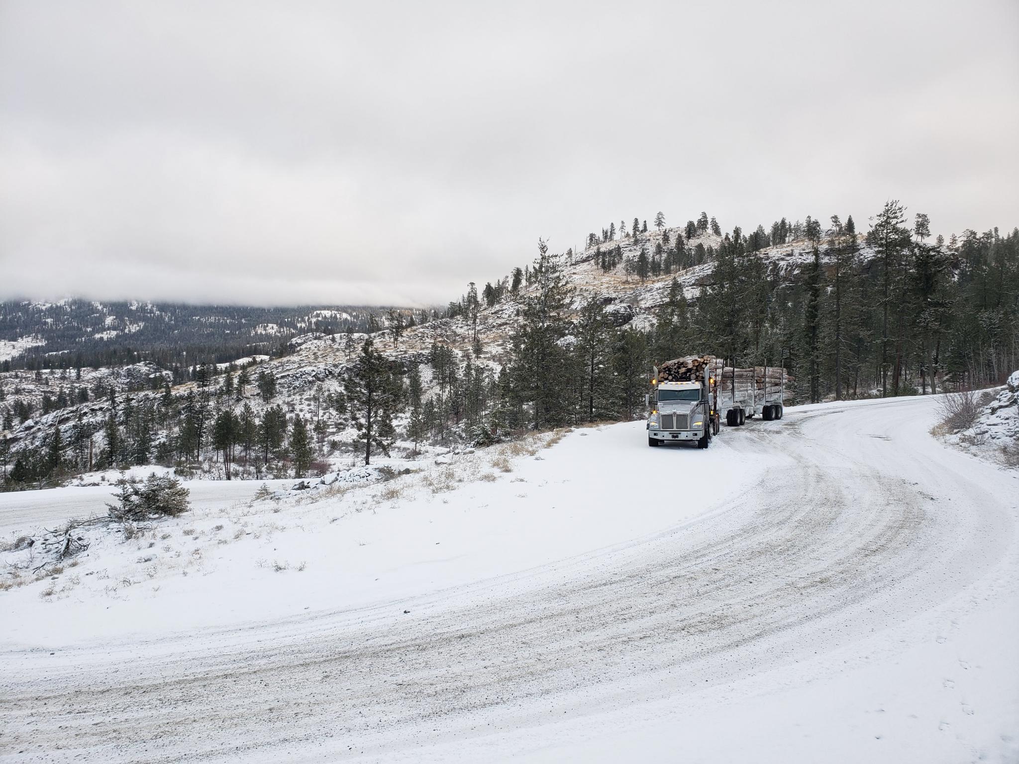

Heavy Haul - Fuel Economy and Engine Life All, I have a; 2019 Kenworth T880 with a X15 565/2050,18sp, 4.11 gears, 24.5 tires 2450 hours and 60,000 miles/98,000km 8 axle set up - Tri drive truck with a quad wagon logging truck Loaded - 140,000lbs/63,500kg Empty - 43,000lbs/19,500kg Cruise speed - 55-60mph or less depending on the road Fuel Economy - 3.7mpg avg I run in extremely mountainous terrain, from 8% on the highway to over 15% off road All this leaves me with terrible fuel economy but being an O/O I want to try and maximize the fuel economy as best while trying to minimize engine wear. I keep seeing "keep the boost under 15lbs" but with my application, weight and terrain that isn't a reality for me, I would go backwards down a snow covered bush road. I try to keep it as low as possible while maintaining enough speed to keep going forwards. I also try and drive as slow as I can while still making my multiple trips per day during the available mill scale hours and HOS. The truck is still new but what sensors should I be cleaning or checking? What EGTs should I try to stay around? What help, advice, tips can you guys offer me to help me keep more money in my pocket? I've added some pictures for you guys to check out. Thank you | |||

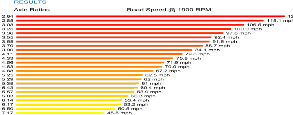

RE: Heavy Haul - Fuel Economy and Engine Life you want it to last longer? --- drop the torque to just about 1790 ft-lbs, set the power to 605HP, and re-gear it taller (maybe 4.63's or 4.88's thereabouts) so that it can stay in the 1600 - 1900 rpm ranges all the time. Maybe also put a 500 series VGT on it to go with that for better heat xfer out of the engine too. (18-speed w/24.5's)... ![]() ![]() HP does not wear out the isx... torque does, and that 2050 torque in that X15 is all below 1300rpm where it tortures it. some related info: http://rawze.com/forums/showthread.php?t...3#pid17353 User's Signature: ->: What I post is just my own thoughts and Opinions! --- I AM Full Of S__T!. | |||

RE: Heavy Haul - Fuel Economy and Engine Life (as someone who hauls exactly the kind of stuff like this and in those conditions) ... What he said ^^^^ ... In my opinion running offroad as much as you do .you could even go to 4.30 or with 24.5 go to 4.56 and be turning about 1650 at 95 km/ he. Keep in mind I never ran the numbers . Just keep in mind that you would be making more power to the ground so you could back out more . Now I highly dought you will regear the truck .so keep the truck at 1650 or higher as much as you can when running any boost at all . Aside from a tune ,that's about it . By the way I do know the country your in and what it's like to pull heavy . To do your job ,you need to make power , but if you can drop a gear or even a half a gear on hills it all helps . As far as sensors ,do a little reading on here . I dont know those newer motors ,but your imap and backpresser . Oh , depending where you at there is a guy up in your area ( starlight I believe) . He is a great guy . Somebody should have his info . User's Signature: The missing link | |||
