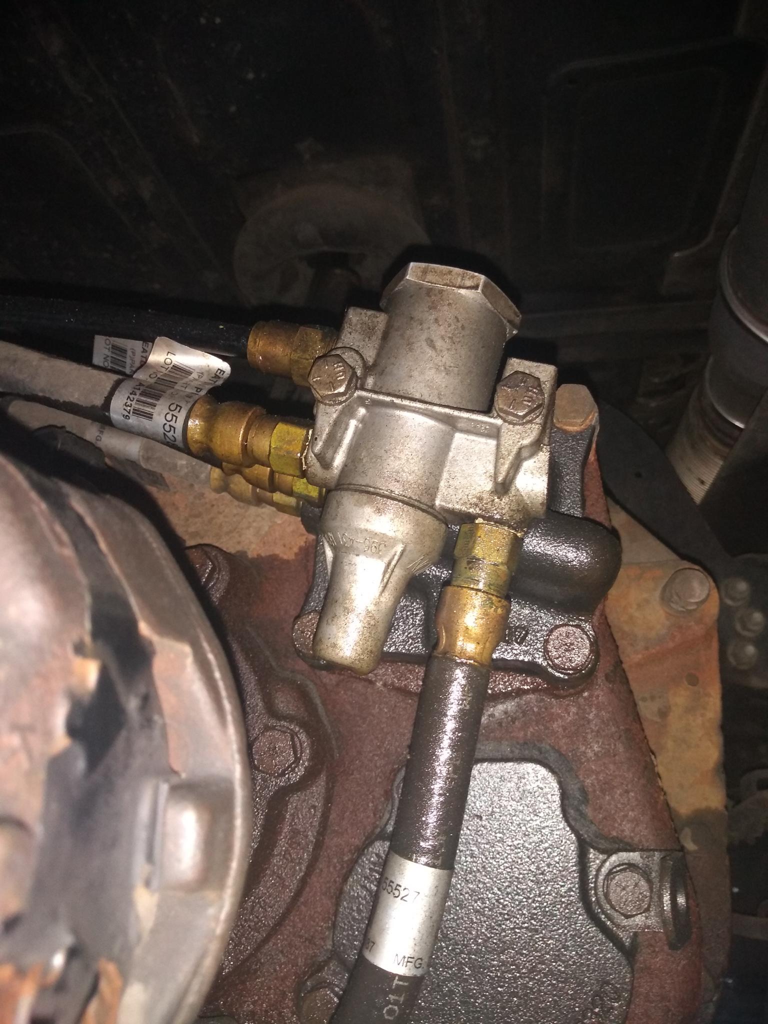

Have inspect under truck today and found my tranny start leaking from splitter. Can i fix it by myself without taking tranny down.
Appreciate any advise. Oil level still Ok but oil is foamy. Can I drive it back to home or place where to fix?

That's actually the range change cylinder. The auxiliary section of the transmission needs to be removed to disassemble. It's only a weep so I would think keep an eye on the oil level and get to somewhere you can repair it. Just check there's no underlying issue. By the looks of the amount of oil it would take a long time to affect the level.

I don't know how badly leak is. It's fresh as just yesterday everything was dry here. Cleaned area with brake cleaner to check where is leak exactly. In case I need to fill up can I add regular gear oil to synthetic?

No don't mix mineral and synthetic

I may be wrong but I don't see any reason that can't be pulled apart on the truck with the trans and auxiliary section in place. Drop the drive line to get up in there. And it should just unbolt and then seal with RTV silcone on the plate or replace the oring gasket if thats what that has behind it. There may be a "doughnut" rubber piston behind there that can be unbolted and replaced. Some times air and oil sneak by and get pushed out when they get worn or frozen.
Also make sure that isn't oil getting slung off the transmission output shaft seal. It may be a good idea to just throw a new seal in the tail shaft while you're up there any way.
