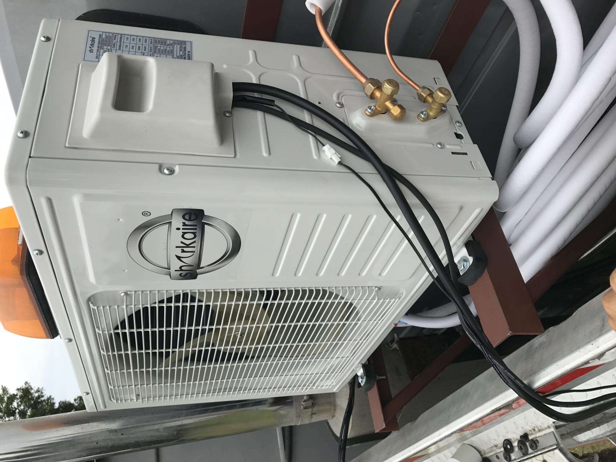

Some words I have to say about safety.
Please immediately wrap all wires and zip tie them so it will non rubbing against the frame or cab.
We don't need fire or electrocuted.
08-26-2017, (Subject: Anybody running electric APU? )
RE: Anybody running electric APU?
(08-26-2017 )snailexpress Wrote:  Some words I have to say about safety.
it is also against DOT regulations not to have all wires inside a protective cover such as split-loom

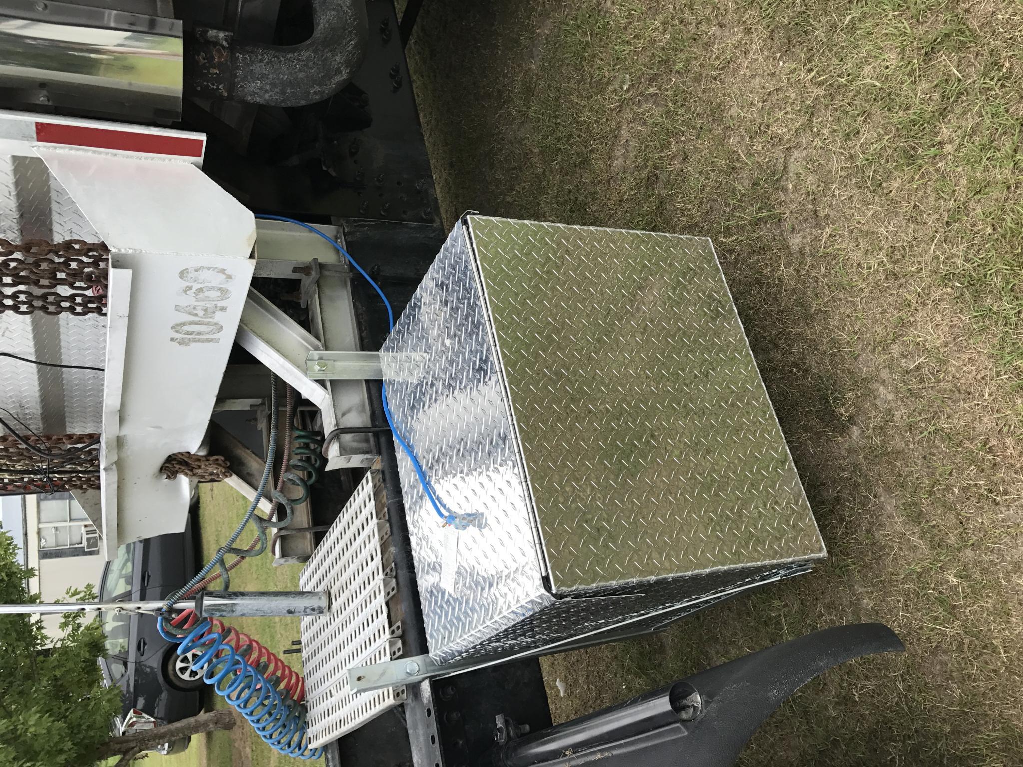

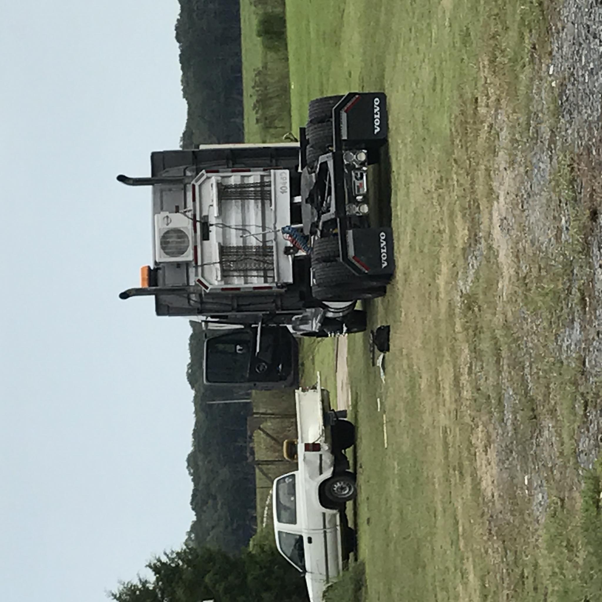

No doubt! I took these pictures before the final "button-up"
Wrapped up the wires in electric tape first, then wire loom, then zip tied to bracket

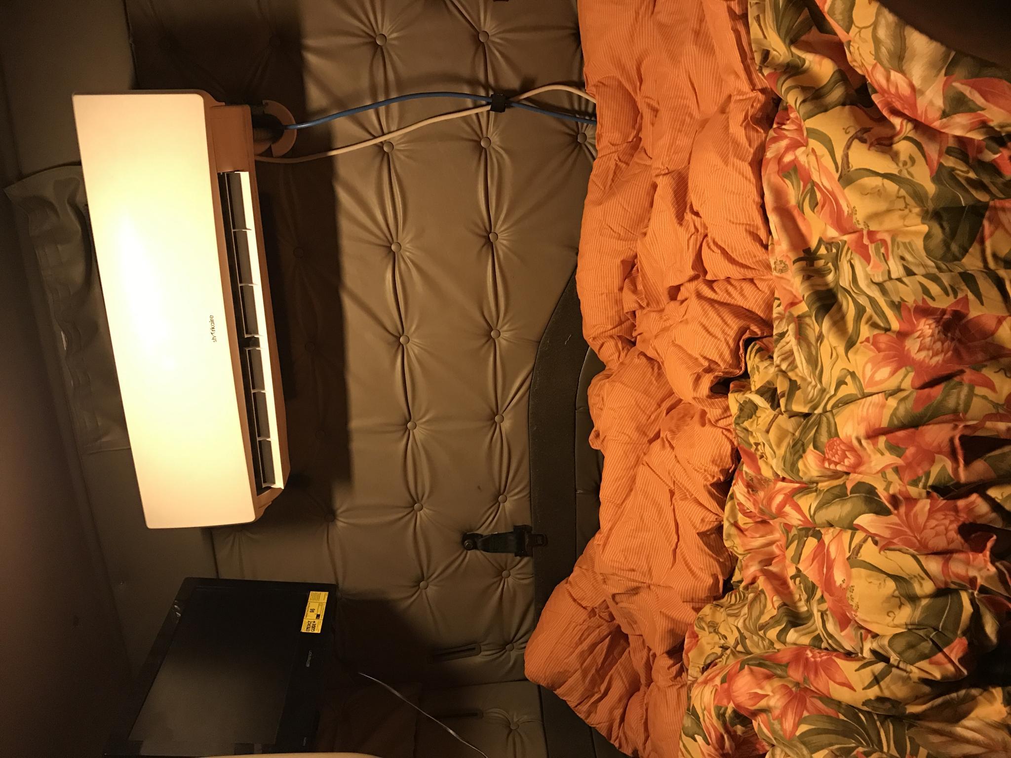

I didn't realize how nice the sharkaire was over its competitors until I started watching YouTube instal videos...
Some mini splits didn't come with wiring, some came with wires but were not stripped or crimped, some of the units had copper lines that were not pre flarred
But the sharkaire had real nice color coded wiring that was pre-crimped with the right fittings, copper lines were preflarred. Real nice- thanks for the idea... even the controller is nice
The hvac man that came to pull a vacuum agreeed , he said it was nicer than the ones they sell lol
