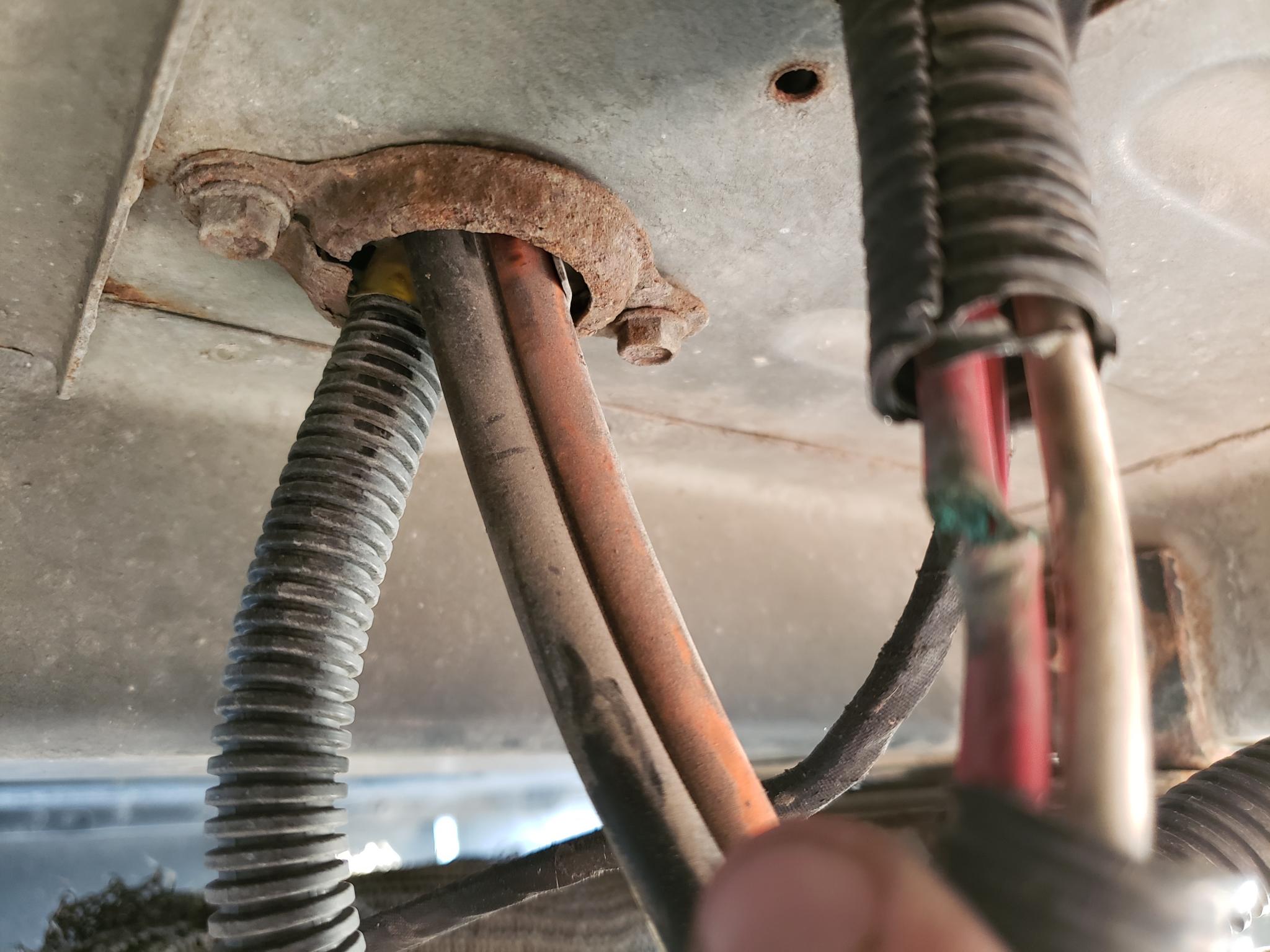

FOUND IT! Wire rubbed into where it goes thriu the sleeper floor. Hot side was not touching an longer but the load side of the break was grounded to the cab causing me to really scratch my head about why everything that shoulda been hot was acting as a ground. Got to wiggling the main harness and voila the fan comes on.

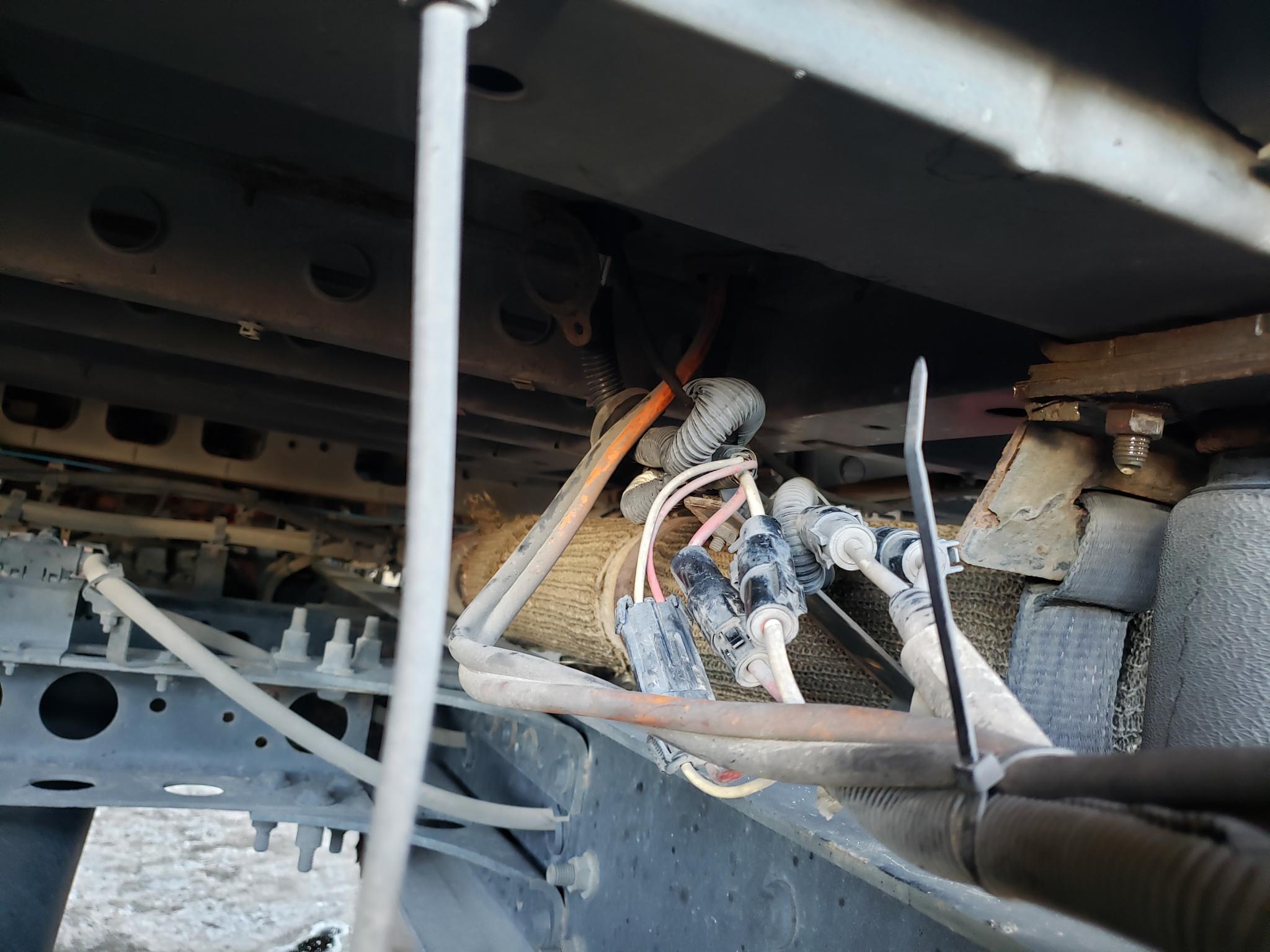

maybe a pic of the location/area so that others can know where to look?

Yes please, a photo.

Excuse the mess of wires there, I untied em hunting the problem. Thats the sleeper hvac power wires goin up thru the sleeper floor under the bunk. In an idle free truck the entire sleeper hvac is powered from there. Time for a butt splice, copious amnts of electrical tape and new grommets.

Also should note. Theres a 3rd fuse block attached to the sleeper hvac unit. Mine was a galvanized cover has 2 relays and 3 or 4 fuses in it. Another fuse is inline in the apu battery box, it powers the control side of the switches/ relays.
