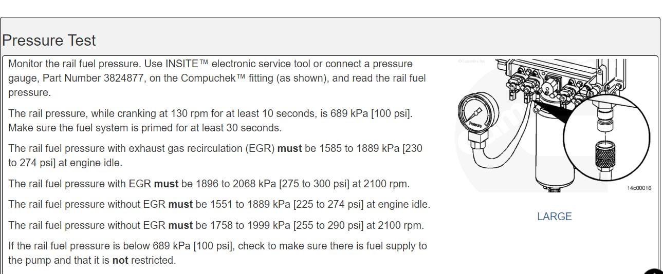

Fuel pressure testing May be a dumb question, but...There are two sets of specifications. One for WITH EGR. The other WITHOUT EGR. If someone has an 871 where egr is just for looks, which specs do they use? | |||
| 06-19-2020, (Subject: Fuel pressure testing ) Post: #2 | |||
| RE: Fuel pressure testing 275-300 on 871 User's Signature: 2010 Lonestar - CM871 - 13sp - 3.70s, 2016 T680 - cm2350 - 13sp - 3.36s - skateboarder | |||

| RE: Fuel pressure testing my 871 ran in the low mid 280s at full chooch. User's Signature: 2010 Lonestar - CM871 - 13sp - 3.70s, 2016 T680 - cm2350 - 13sp - 3.36s - skateboarder | |||

| RE: Fuel pressure testing The test says 2100 rpm. I guess mine is governed at 1900. Would the extra 200 rpm bring the pressure up a noticeable amount? It was right about at the low end of the spec. The needle was jumping a bit. | |||
