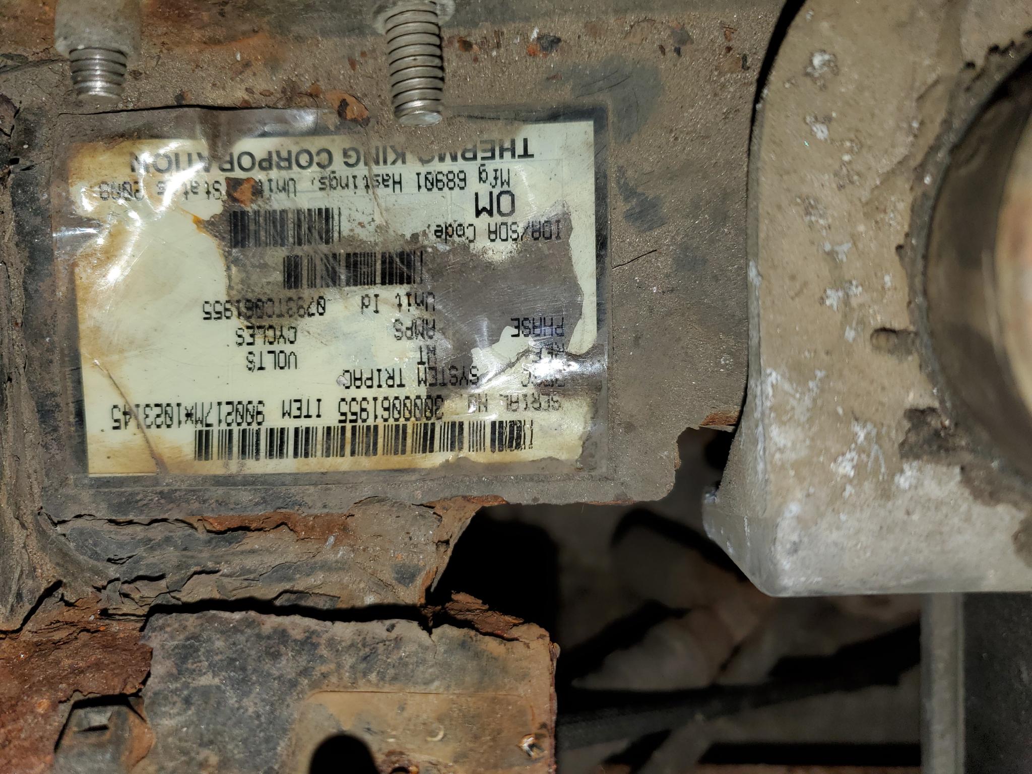

The truck I just bought came with a Tripac system. I doesn't run and I'm trying to troubleshoot what all is wrong with it. I know nothing about these things. So any info would be helpful. Like what model am I dealing with. Where can I get technicians level diagnostic stuff (including software and interface if it has any)
This thing is said to still be functioning with some component failure. Im finding they disconnected a bunch of wiring and sensors but everything looks like its where it should be.

Inside the Apu case is normally a one of those big maxi fuses on the incoming power cable that connects to it's alternator. Check that
Also near back of alternator is a stud that a bunch of grounds attach to for some sensors, fuel shut off, and fuel pump.
If you want send me your email in PM and I'll get you all the documentation I have for tripacs.
