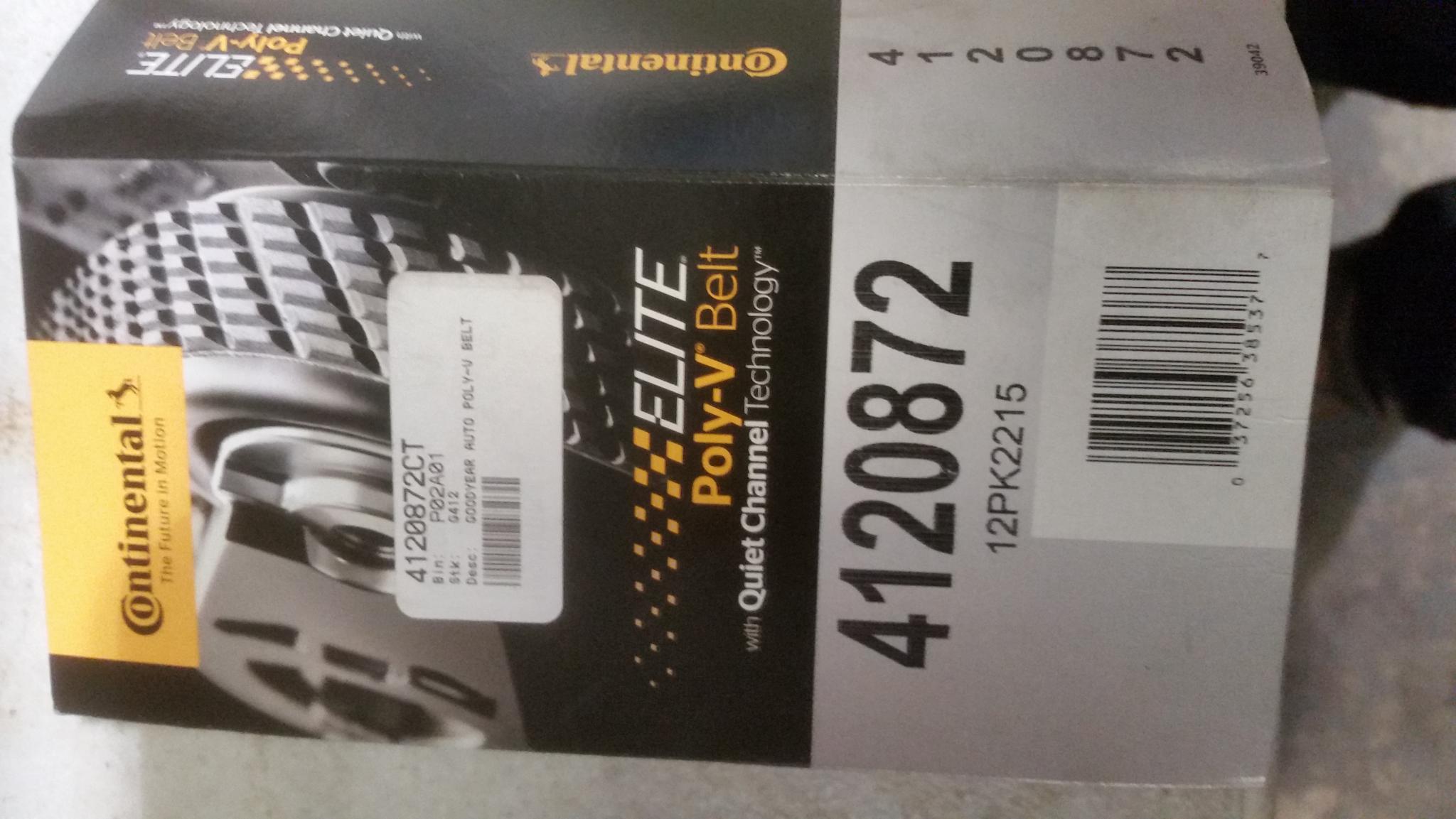

* A 325-Amp alternator. It is a standard size and is big enough to hold the continuous loads of 2100-2800 watts. I got one for my own truck at fleetpride a few years back. A standard pad-mount 315 or 325 leese-neville alternator works just fine.
* A high-torque (or toothed) belt for the engine. ..
I use this belt. It is difficult to find the exact one with the extra gripping-power, most places sell the cheaper non-gripped version of the belt. Here is the correct one...
https://www.summitracing.com/ga/parts/ce...2/overview
or
https://www.walmart.com/ip/Goodyear-Belt.../473358550

I want to thank everyone for the great advice. So first off I'm going to get the 325 alternator and enough cable to go to the batteries and the inverter. I really like the belt too, that's also on the list. The wire to the roof mount is a heavy outdoor house wire.I also used it from the inverter to a wall plug I added. So I should be good there. When I added the bigger inverter I kinda figured I would have to do some upgrades with it. Yesterday I took the cover off the AC and cleaned the coils on the roof mount and the truck. I was able to turn the roof down to low so it's pulling about 1150 watts gets it down to 11.5 volts. I need to get everything rounded up and get it done over a weekend. Will the ground wire be ok if left factory?
