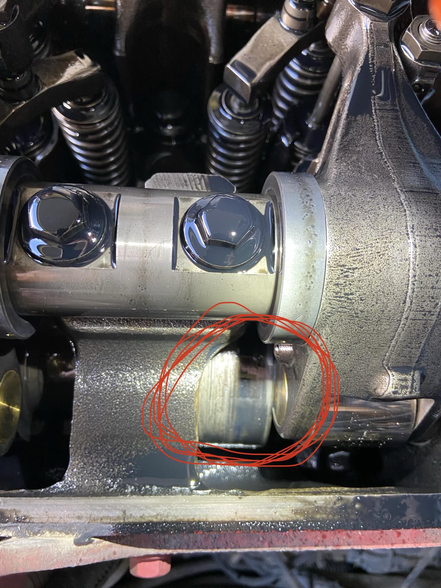

| Cm870 low oil pressure Have a 2006 cm870 w/ 647,xxx miles. It’s been showing a steady 5psi lower than average on the gauge, having trouble figuring it out. Truck seems to be running with a little less power too At idle it’s about 10-12 psi, going down the road it never gets over 25-27psi. I run delo w/ sta lube in it and have for years. Pressure has always been good up until 6-8 weeks ago -Changed the oil pressure sensor -cut filter open to see if there were shavings from worn rods/mains; hardly any metal in it -did an oil sample ~4,000 miles after changing and the sample showed minimal/normal wear -updated oil pressure relief valve but no change Any suggestions as far as what we should look into next? Could Oil pump be on it’s way out? | |||

| RE: Cm870 low oil pressure something is hemorrhaging oil pretty badly internally if it is that low. -- or the pump is worn out. pull the engine cover and look for a spun cam bearing. - Leave cover loose and crank it up.. see if there is some place in top end oil is flowing too rapidly than it should be somewhere. User's Signature: ->: What I post is just my own thoughts and Opinions! --- I AM Full Of S__T!. | |||

RE: Cm870 low oil pressure (07-21-2020 )Rawze Wrote: something is hemorrhaging oil pretty badly internally if it is that low. -- or the pump is worn out. We just found 2 spun cam bearings..I don’t know why we didn’t check these earlier but thank you for bringing that to our attention. One is almost all the way out | |||

| RE: Cm870 low oil pressure We’ll be starting to disassemble it today/ tmrw, I’m concerned that it might need a new head if the journals are worn from the bad bearings In a situation like this w/ 2 spun bearings on a 650k never touched motor, what're the odds it’ll be a can of worms once we pull the cams...? | |||
