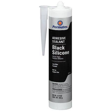

(08-10-2020 )Chamberpains Wrote:  Not unless you're actually rebuilding and replacing the gears yourself, they are just shove them in with some RTV silcone around the edge.
This stuff I am guessing right?
./uploads/202008/post_3100_1597103199_7cb9fee05b89181369c41ccfae031d89.jpeg
08-11-2020, (Subject: Turbo upgrade for x15 )
Post: #22
RE: Turbo upgrade for x15
Yup, red is a good one too. I think black has the most oil resistant design. But they all fall well within the heat range of what the rear will ever see. Just remember too much is too much. A nice thin coating on the mating surfaces is plenty. I prefer to put it on after the rear is up in the hole. I pry the rear out a finger distance and apply it with my finger. But I also used to put it on the rear 1st and slide them in. It just usually ended up with me having to touch up some area's from bumping and wrestling the rear in place.
It all depends on how much room you're working with and the lifting apparatus.
Post: #23
Most manufacturers call for Ultra-Grey in their service manuals ...
https://amzn.to/3itO0U3
other oil resistant types should likely work too though.
