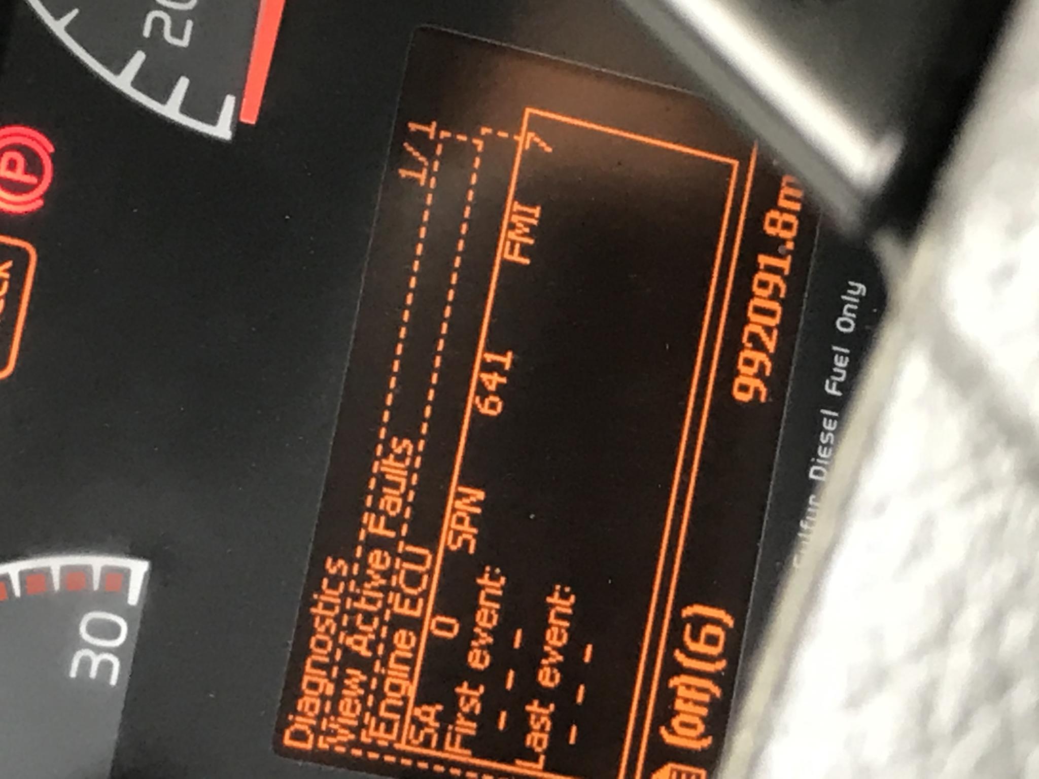

I own Volvo Vnl 670 2011 with cummins isx 15 500hp. Dpf egr deleted. I live in columbus, OH and i was getting loaded with beer heavy load. After i started to drive some 15 miles i had to stop on a red ight. When i came to the fifth gear my truck start jerking and the whole engine was shaking like when you have bad injector, but no code poped up. Park on the shoulder i turned off and statr again same thing. I couldn’t go more then 45mph after that if i accelerate it was shaking. I went to go back to the mechanic and right before i get there the truck start to run like nothing happend so i thought maybe it was bad fuel that i fueleded the other day. Just to be sure i went to one shop replaced the fuel filter and when i start the truck i got this code SA 0 SPN 641 FMI7 and sometimes SA 0 SPN 641 FMI 13. I drove to michignan and back code is still here but truck runs strong. Went to cummins they are telling me turbo or the actuator or maybe wiring ( and i dont want to put it in a cumnins shop cause once they opened they be like u need new turbo and they qouted me $9.000 wtf. ) i have gauge boost under pressure goes to 26-27 i thing acts normal. Please any help or advice. Is it possible bad fuel to confuse the ecm and somehoe poped up this code ? Thank you for any replies!

Who did the delete? I am assuming it is a CM-2250? Looks like a code for the turbo actuator. Have you taken the intake and exhaust side of the turbo off to inspect the actual turbo itself? As far as an actuator, or turbo, YTS Turbo in Griffin GA. Do you have an inline reader and Insite software to run some diagnostics? If not, you will need that, or the dealer will rape you. And back to the delete, how many miles on the truck? has any work been done to the truck? If you do not know who did the delete, have you at least removed the cans to inspect that they have been properly hollowed out? All three cans? Many delete outfits do not hollow out the cans, and you slowly cook your motor, and turbo...
I saw the mileage on the photo, close to one million... Ouch.

On quickserv, SPN641, FMI7 comes up as ...
Cummins Fault Code 2387 - VGT Actuator Driver Circuit (Motor) - Mechanical System Not Responding or Out of Adjustment. The smart VGT controller has detected incorrect stop limits, or the VGT is unable to move to the closed position.
The code is usually indication that the turbo is going bad and is hanging up, but ...

(08-30-2020 )Roadranger Wrote:  ... i have gauge boost under pressure goes to 26-27 ...
Boost under full operating load on a CM871 is about 37 psi or so, and about 35-36 psi for a CM2250 engine... if your only getting about 27 psi boost, something is very wrong.
