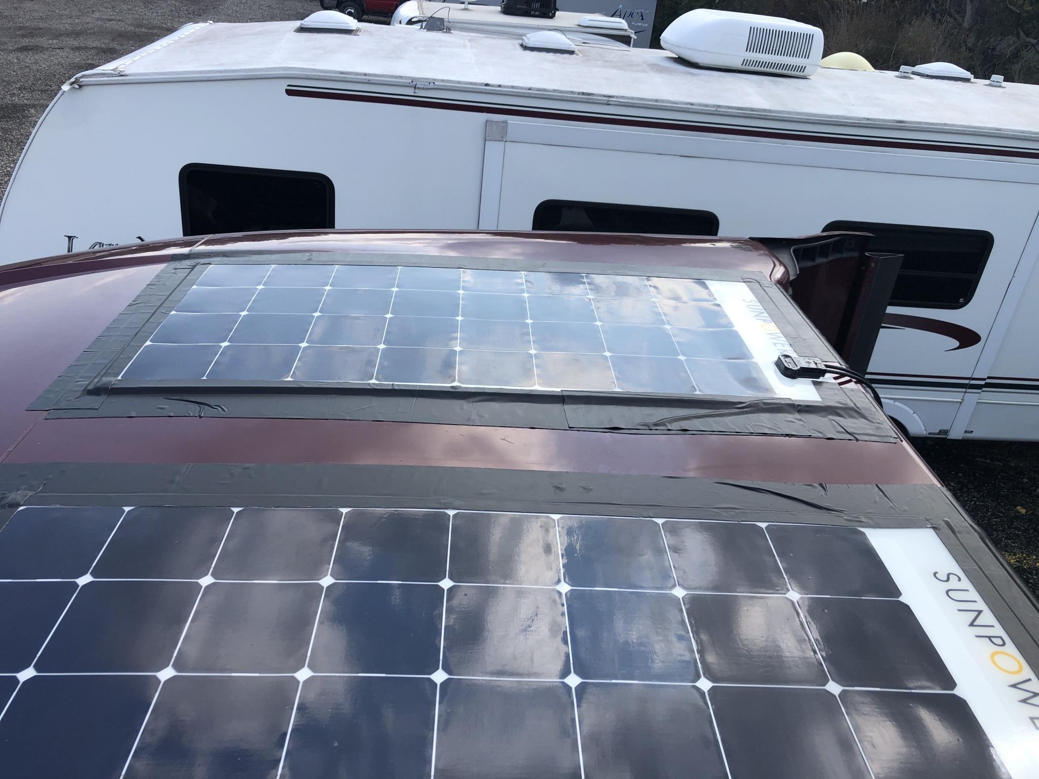

Well, installed the panels on the roof! Windy, and rained out yesterday... Windy again today, and hot, got to the truck at 0900... I miss my driveway under the trees.
And yes, it is that easy to mount these! Tape them down and run the 10awg cable... A couple of connections and you have power! You need a few other pieces, but nothing that will break the bank.
That is roofing tape, waterproof, like they use in the RV industry to patch and seal a rubber roof, the same outfit makes the trailer patch tape we use on the commercial stuff. It is not coming off. I did discover that the Gorilla Tape, 4" waterproof stuff, is the same as far as I can tell, Home Depot sells it, as I came up a little short, wind got me, not fun on the ladder with no trees around... Those panels are not going anywhere.

If you wanted a much cleaner look to hold those down you could use heavy duty adhesive backed Hook and loop (velcro) 10lb rating or better. I used the stuff on my 2 roof mounted strobe lights. Clean the surface with some alcohol. Peal 1 side of the velcro and stick it to what your putting on the truck then peal the other side and stick it to the roof. For an added layer of securement and longevity run a bead of RTV silcon around the entire edge to seal out water and dirt from getting in and under the velcro. Those strobes never came off the roof in 6 years and are still up there.
The bigger strobes I had on the previous truck to this last one I added a bead of 2 part epoxy to the leading and trailing sides. This was waaaay over kill but I was afraid a tree strike would tear them off. I whacked quite a few and they never came off. But I also had a hard time getting them off by breaking the bead of epoxy with a chisel and it left 2 small lines of it on the roof. But it was on the roof. The only people that can see them are the government agency tracking you....

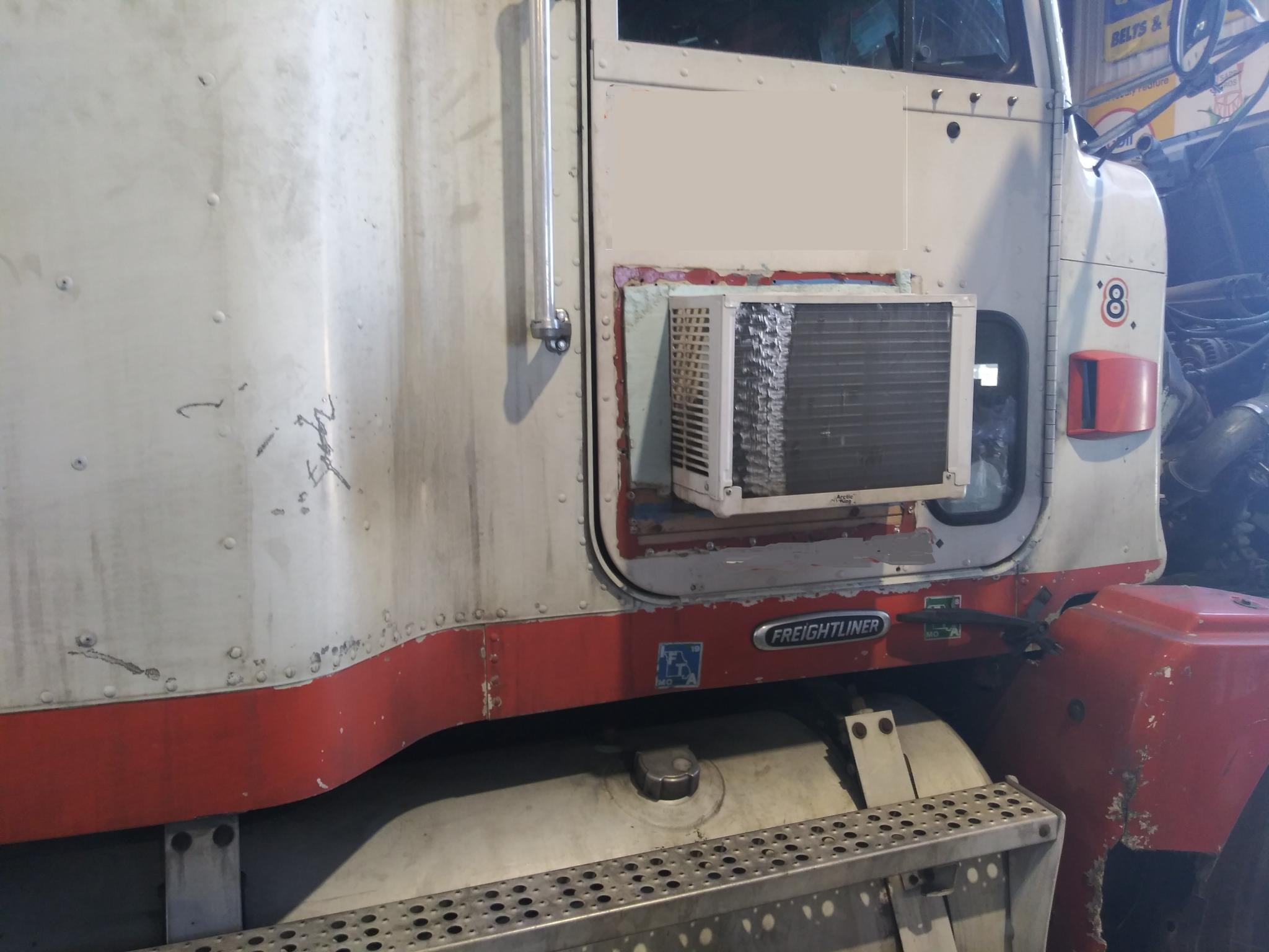

Mr. Loo with solar power you can run AC now.
I have an idea.
:big_smile2::big_smile2::big_smile2::big_smile2::big_smile2:

(09-07-2020 )snailexpress Wrote:  Mr. Loo with solar power you can run AC now.
I have an idea.
Poor folks have poor ways
