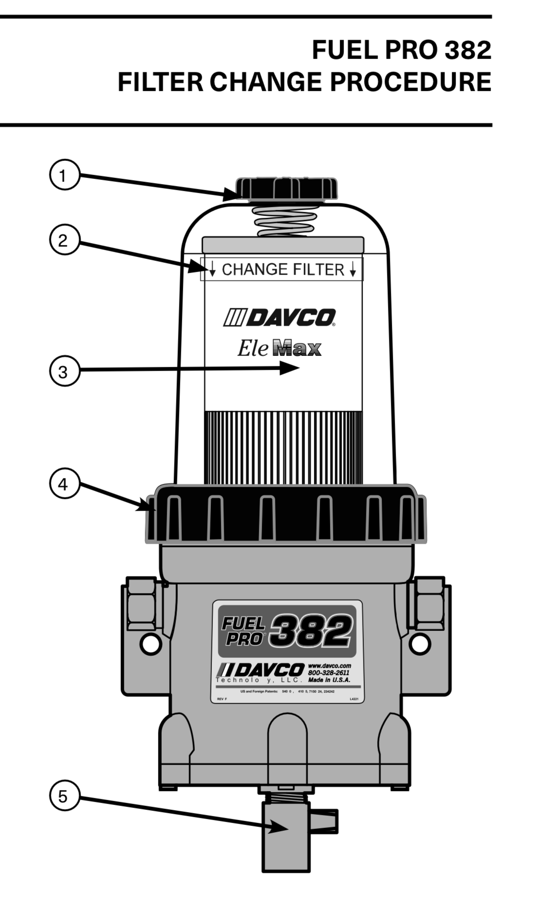

After all the continued hell Ive had with mine I thought Id post this in case any of you have this FWS on your truck.
Davco gives very specific instructions to install new filter to prevent fuel related issues. My guess is that 99.99% of all Prevent Maintenance Oil Change locations dont have a clue how to do this correctly. I know mine doesn’t and they won’t install mine again!
Hope it helps someone else.
