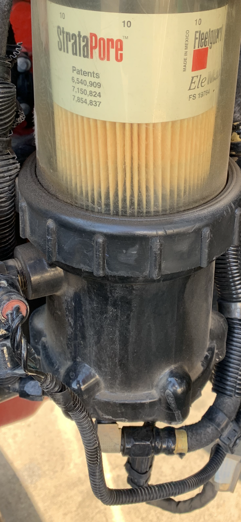

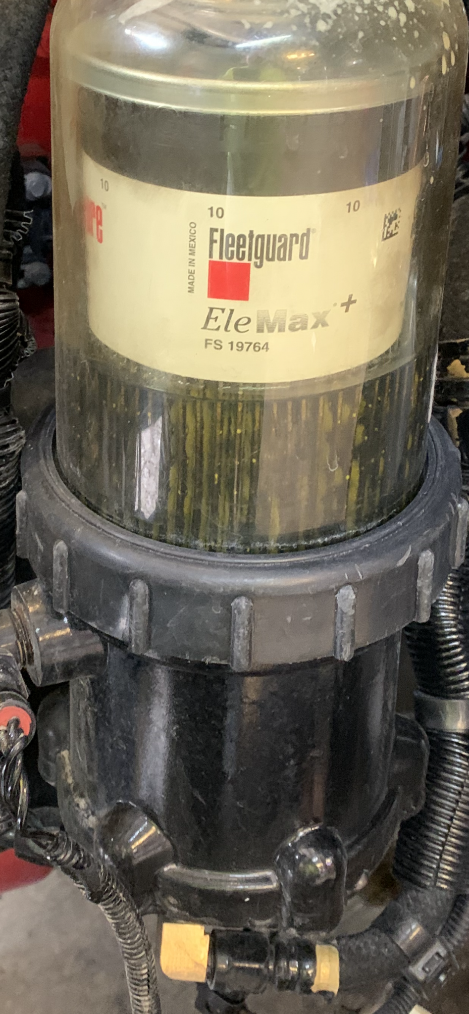

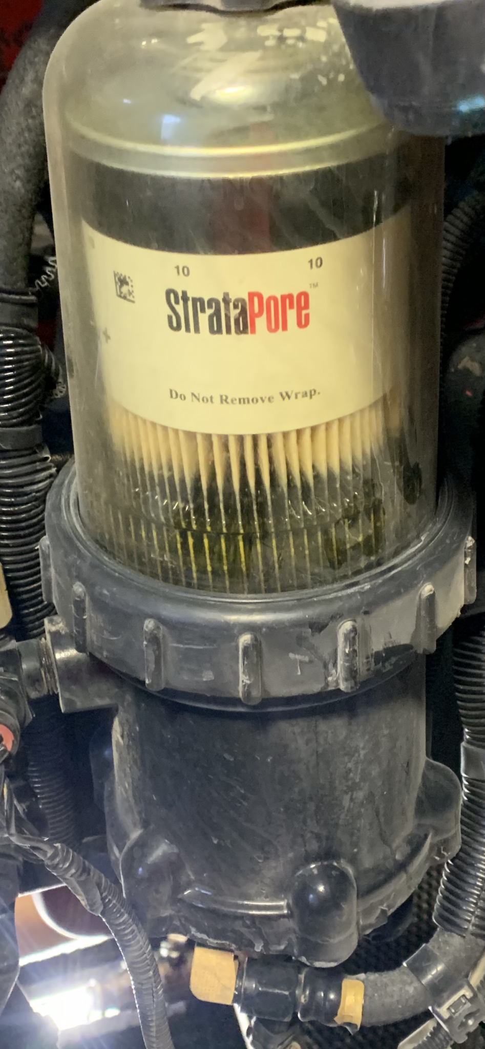

I have a new to me 2019 565 X15, 177k. My fuel/water separator keeps turning black. Thought it was algae, but the tanks are sparkling clean. I just had Thermoking install a new tri pac, thought maybe they got trash when installing the pick up tube. Changed it at 5k miles, then it turned black again. Changed it at 5k miles again. Now I’ve driven 1k miles on this filter and it’s turning black again. Any suggestions?
1st filter
2nd filter
3rd filter

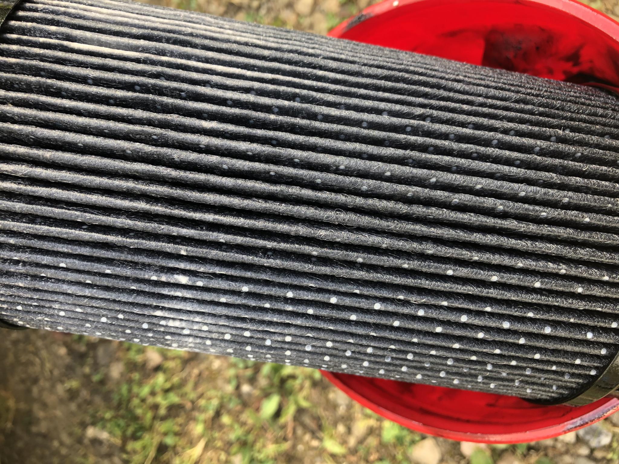

I've got the same issue with my 2250 but it has the cartridge type filter. There are threads on here about Asphaltene, I assumed that this is what is going on with mine. I normally just change my filter mid oil change. Here's a picture of my filter at about 7,500 miles.

looks quite normal to me. I have never sen a davco filter that was 10 microns "NOT" turn black... its doing its job.
