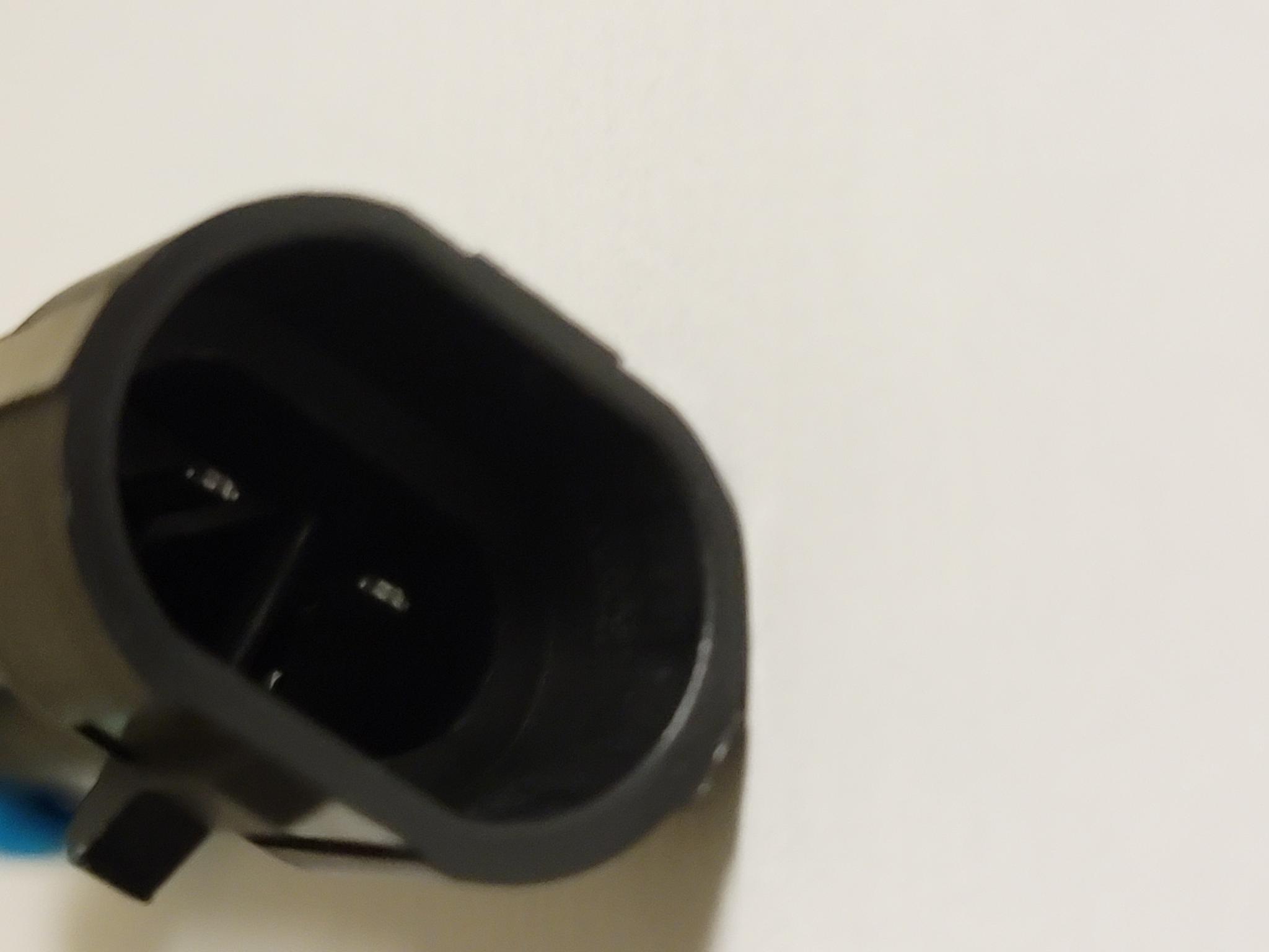

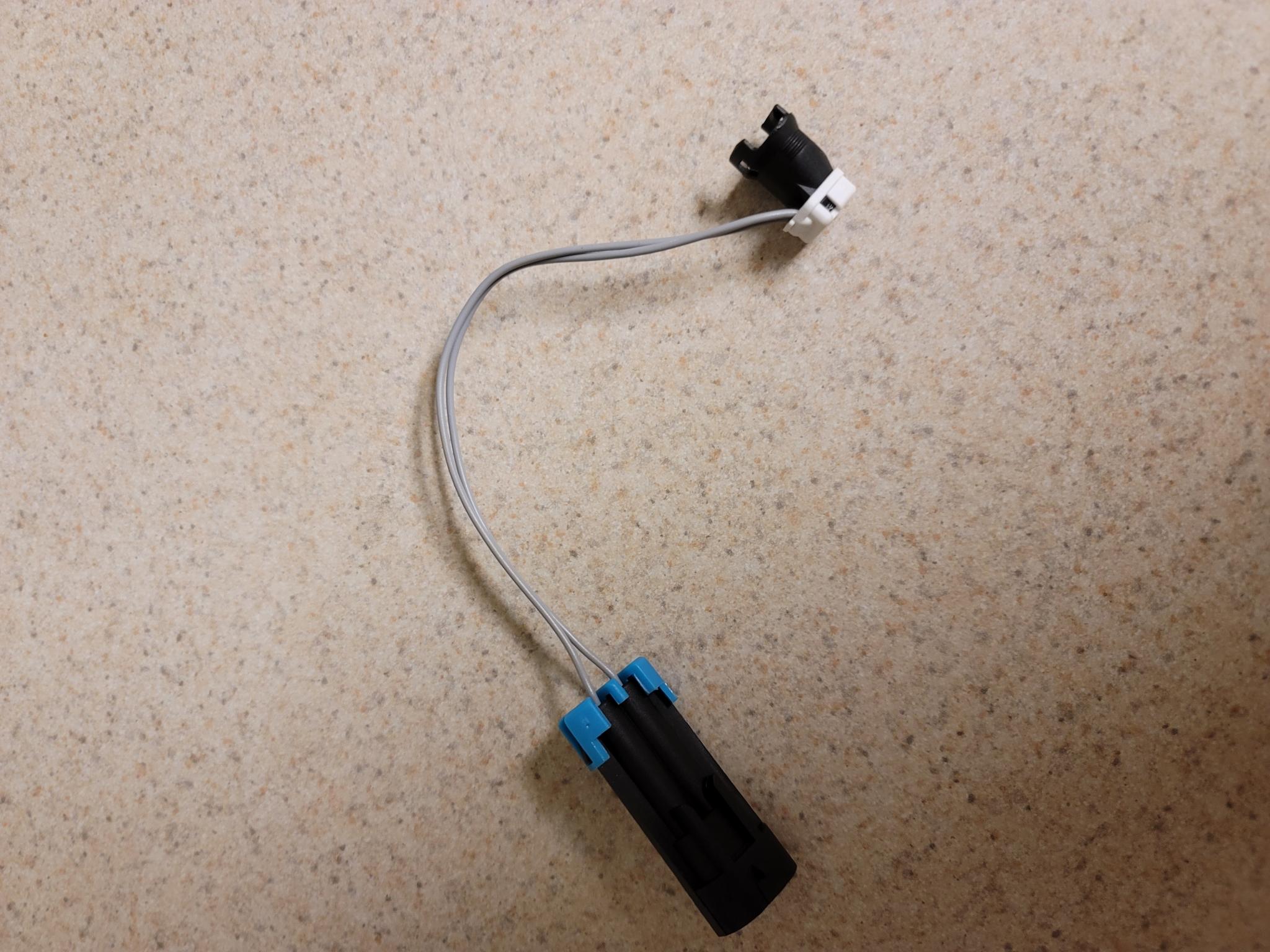

I didn't want to start another Prostar ac thread. I just got the thermomistors kit, and it comes wire with a quick disconnect. The last time I had these replaced the shop just cut the connector off, and just used butts connectors. I want to use the connector incase I have to replace again.
Does anyone know where I can get the female part for this?

I think this is what you're after..the female end...it's just the empty connector so you'll need the spades and retainer...or ebay that part number and order one as a kit
https://www.customconnectorkits.com/12052641

Just so you can do your own Google search, the part your looking for is called a Delphi metri-pack 2 pin female connector.
There are entire kits for sale online and many parts stores have them. I usually start out buying the big $100-$200 kit and replenish it what I need to when I use up certain ones.
