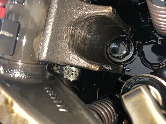

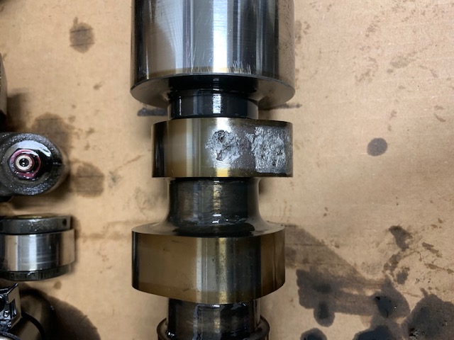

Recently picked up a 2015 Peterbilt with a CM 2350 in it. Sent an oil sample in for analysis after doing a full service on the truck and it came back with Iron @ 63ppm and Chromium @ 4ppm. After doing some research on this site it was clear I needed to investigate even though it was my first oil sample from the motor. As simple as it is, I removed the valve cover to inspect the cam and cam followers. I found exactly what I was dreading.....One of the cam lobes was destroyed.

(12-10-2020 )SemiSweet Wrote:  Hi everyone,
I decided to dig right into it knowing that it will not get better and it will destroy the motor if not taken care of asap.
