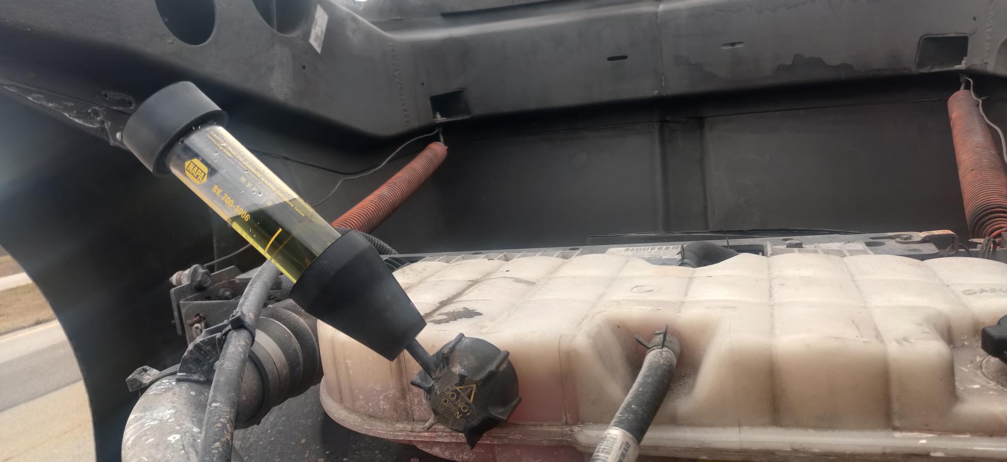

If i had a blown head gasket would the coolent over pressure vent be open constantly? Same thing with the air compressor pushing air into the coolant?

I came up with this ghetto test and had no bubbles with the engine at 150f, i am going to get it hot going to my consignee and test it like that again

I forgot to mention, engine running at 1400 rpm. Pumped down to activate the air compressor and no bubbles

Alright got the engine nice and hot and still not over 15psi, i also added more coolent to try and force the issue but nothing still.

The exhaust gas, if there is something truly wrong, could be so minimal that you will not see a pressure increase in the coolant system idling in your driveway. I know on mine it slowly got worse, to the point it was blowing hoses and eventually blew my radiator apart.

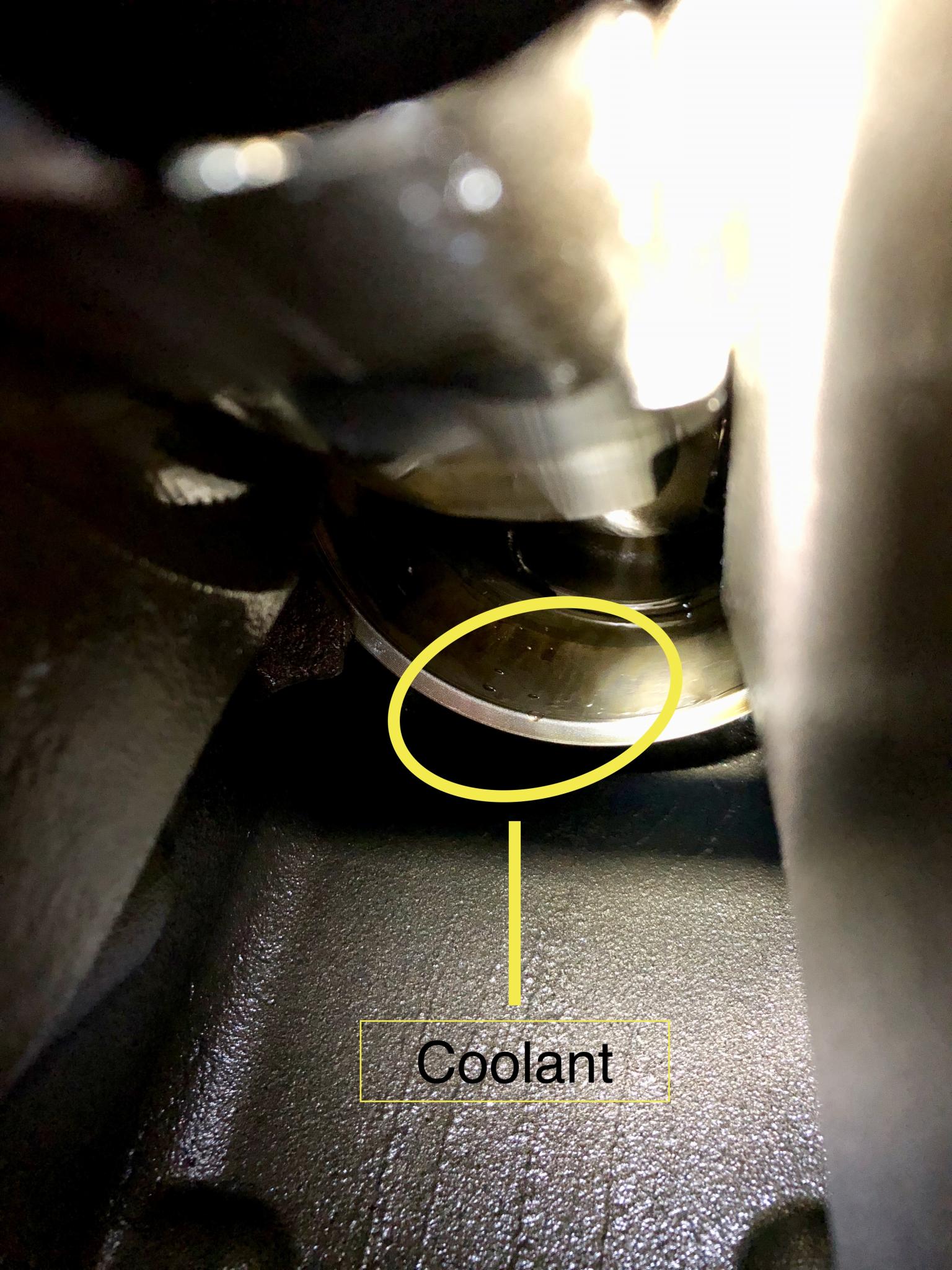

Me, I would drop the pan, pressurize the coolant system to 20psi, let sit over night and in the morning someone needs to be under the motor and someone else barring the motor over. You need a quiet area, because if there is a fretted liner, you will hear the coolant gurgling if it is to that stage. You will also need a flashlight, a good one, bright, you are looking for coolant on the liner walls as your buddy bars the motor over.
I think the photo will show up... This is my #5 liner, photo I took prior to tearing my motor down. This is what you are looking for. Click on the photo to get a better view...
