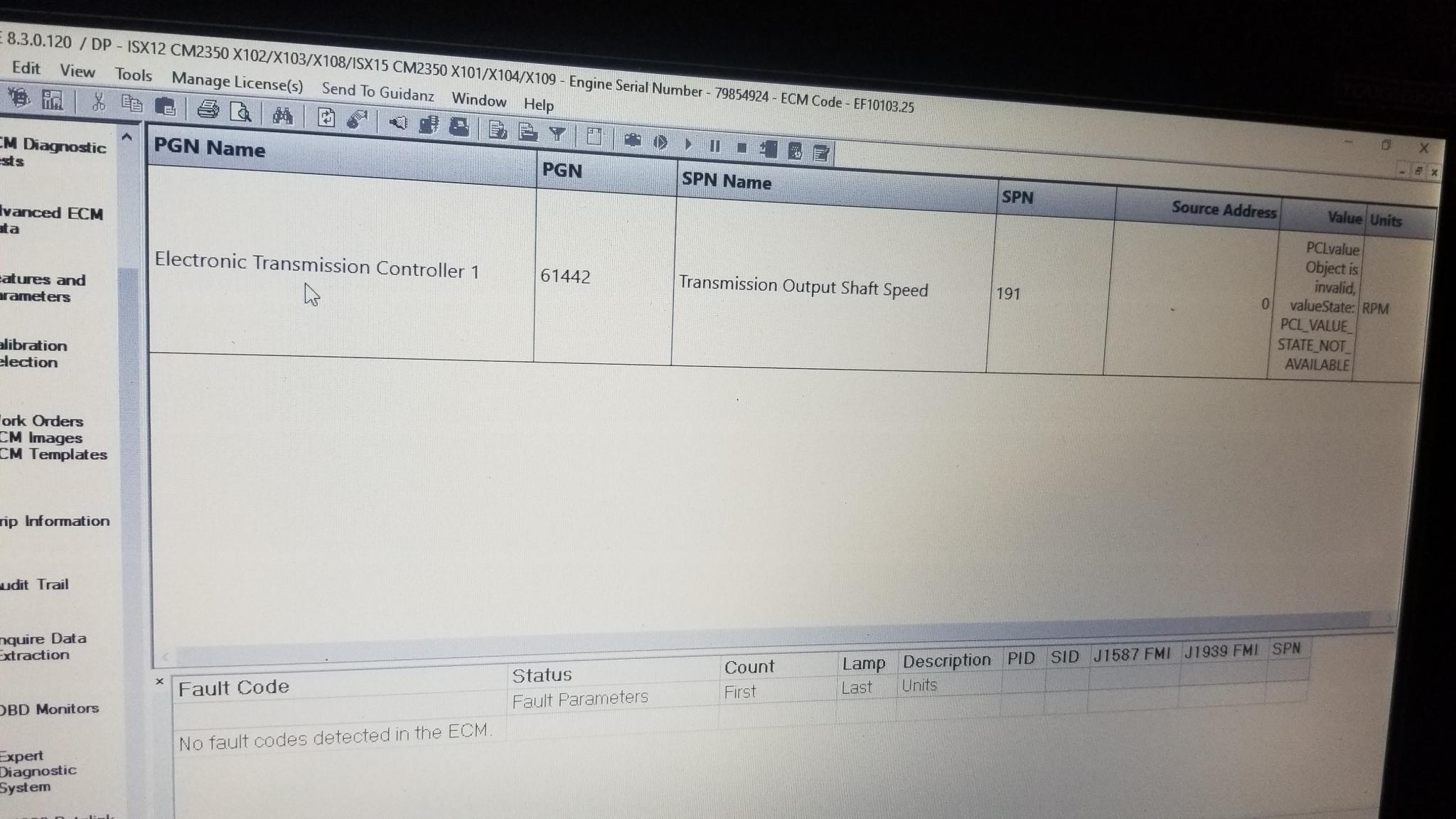

I need help with this fault code I m getting in J1939 daralink messages in IN$ITE. I replaced my speed sensor and tested wiring for malfunction but I cant seem to fix it. I have attached a picture for reference.
Truck is 2016 Peterbilt with 18 speed, isx15
Anyone else face the same thing before?
If you can point me in the right direction

The screen shot shows no faults.

(12-29-2020 )Rawze Wrote:  The screen shot shows no faults.
Clear as day

However, I do see SPN 191 in the trans module. Insite is only for Engine ECM. Might have to connect with transmission mfg software.
