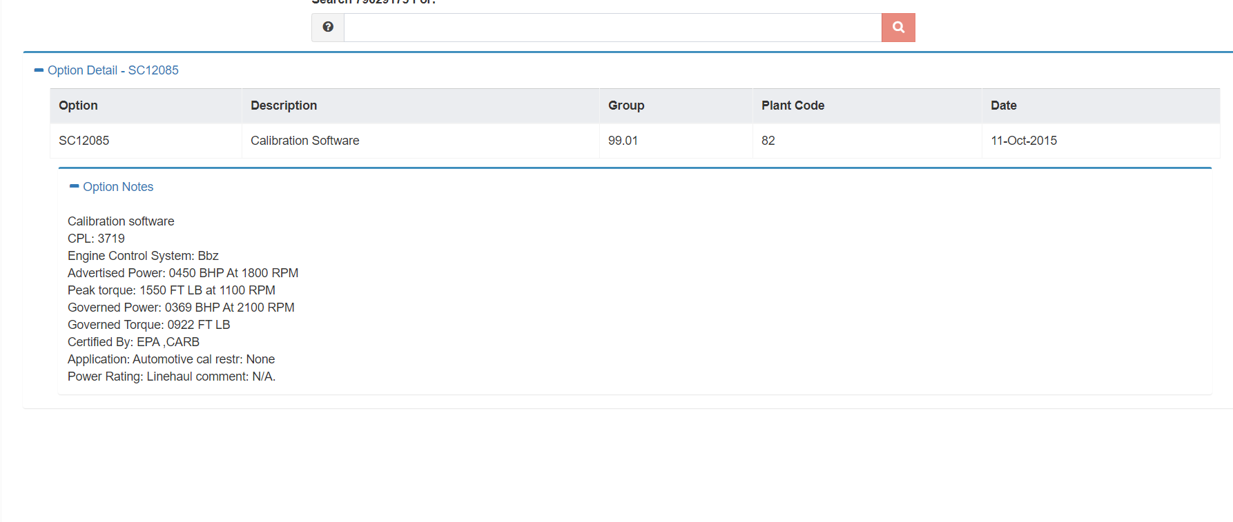

Just became an O/O 2014 freight shaker 125. ISX 15 450hp CM2250 10sp, and trying to learn as much as possible about my truck. I was messing around in Cummins Quickserve and noticed this../uploads/202102/post_5349_1612316586_49c12c41f5d356695b9288d66de5680c.png
Has my motor been governed down by Ryder(previous owner)?

No, your engine makes 450hp@1800RPM and 1550ftlbs@1100RPM
When it says 'governed' it means at governed RPM which is 2100RPM on this calibration. Which is 369hp & 922ftlbs @ 2100RPM
If I could find the fuel curve chart it would make much more sense....

(02-02-2021 )Bward Wrote:  Just became an O/O 2014 freight shaker 125. ISX 15 450hp CM2250 10sp, and trying to learn as much as possible about my truck. I was messing around in Cummins Quickserve and noticed this.
The photo you posted is simply stating that at the upper limits of the motor power has been reduced to prevent damage. In regular operating mode, you are supposed to make 450 Brake Horse Power @ 1800 rpm. Your peak torque level is set for, or at, 1100 RPM
