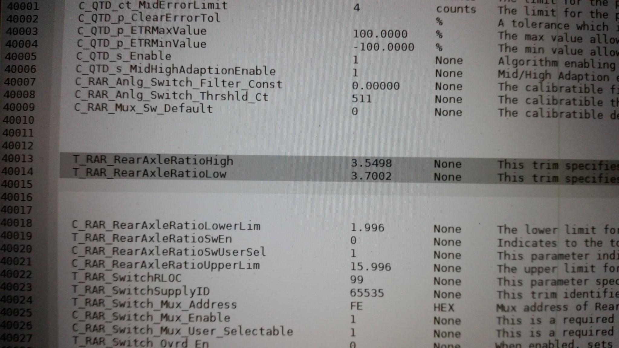

(02-21-2021 )SemiSweet Wrote:  ...The truck actually has 3.73 gears in the back.
u sure about that? - someone needs to update the ecm program to reflect the actual hardware then. The rear axle ratio settings is sitting on 3.36041 .. just an FYI.
02-21-2021, (Subject: 2350 fuel pressure decay Fault code 4726 )
RE: 2350 fuel pressure decay Fault code 4726
I am positive on the rear end ratio . Insite also shows 3.73.
User's Signature: 2015 389 Peterbilt. ISX 550 18speed 3.70 gears
(02-21-2021 )SemiSweet Wrote:  I am positive on the rear end ratio . Insite also shows 3.73.
ahh.. I see it ( I got curious, so I looked again). you have 2 settings in your for 2 diff axle ratios.
most trucks I see only have this as a single setting (the other one mentioned above).
just for a reference: On mine, both those settings show 3.5498 and the other setting shows this too. I have 3.55's in mine and that setting has never been adjusted since the truck was new.
even so, 3.70's is still a bit tall for what your hauling.
