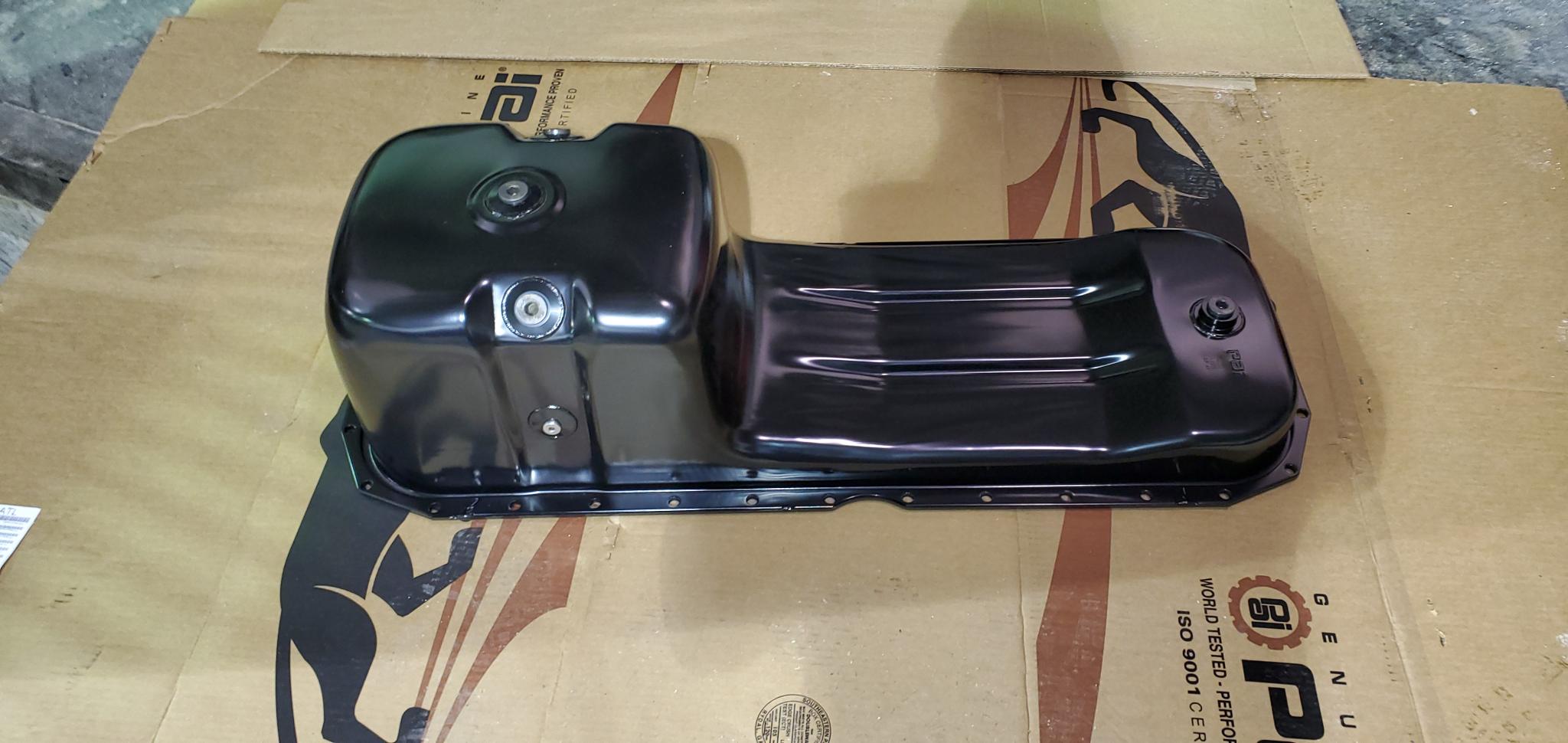

02-22-2021, (Subject: Oil temperature gauge ) Post: #8 | |||
RE: Oil temperature gauge (02-22-2021 )tree98 Wrote: Don't the oil pressure sensors also read the oil temp? The new oil pan I just put on mine has a plug in the side. I wasn't sure if you could put one in there and get a good reading. | |||
