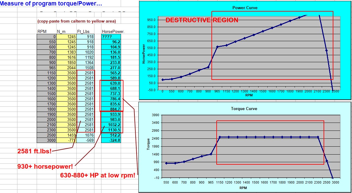

* The Advertised Power and torque settings are set for 550HP, 1850 torque ... HOWEVER... THE ACTUAL POWER/TORQUE is set so insanely, destructively high that it is not even remotely funny. Here is a view of the completely horrible power/torque curve in this thing...

* The torque and fuel conversions are whatcked all the hE#ell as well. The engine really does not know how much power it is making any more. I have never seen a torque fuel conversion table edited into oblivion this badly... ever.

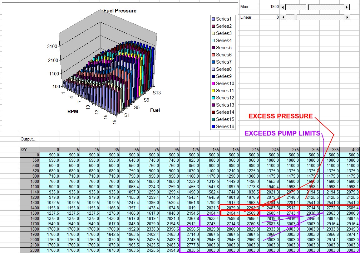

* Fuel pressure tables for the fuel pump set to force the the pump to make more than 4,500+ PSI ABOVE THE STRUCTURAL LIMIT OF THE FUEL PUMP!. - I guess they wanted the fuel pump to explode!!???. here is the values...

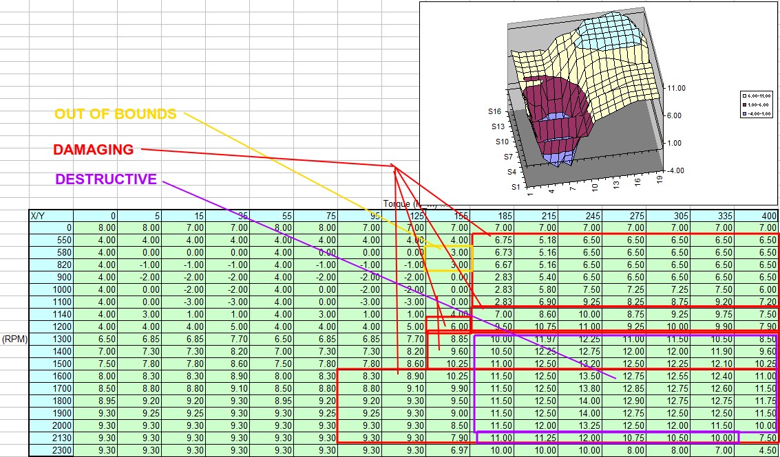

* Injection timing settings have been set to absolutely destroy this engine!. Here is a preview of how bad it really is...
./uploads/202103/post_2_1616852088_a15c8b878517bd7f5102e6c701c46e49.jpg
The ISX-2350 does good to handle about 3+ degrees BTDC at high fuelling without egr gas ... this thing is set to more than 12+. Also,.. WHY THE [email protected]#LL is it so damn wacky?. This map is all over the place like maybe some 3'rd grader was trying to make a video game map out of it?.. because This haven't seen any engine injection timing map I have ever seen work before!. -- Holy Smokes this thing is bad!
