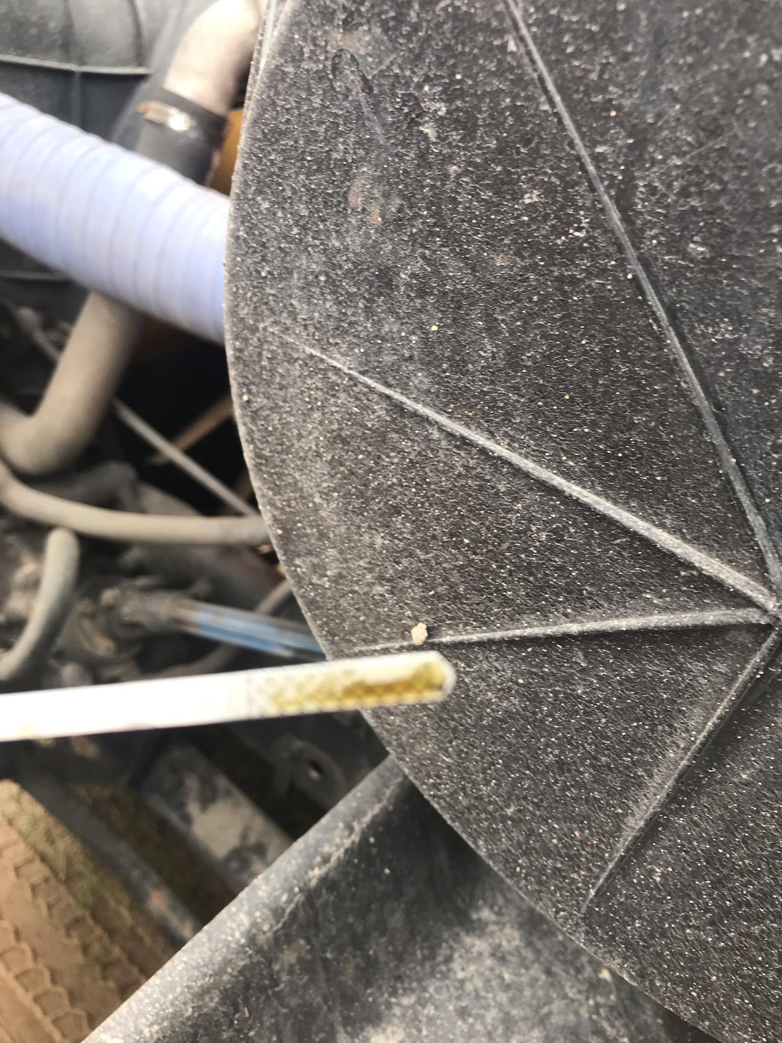

I did my first change around 600 miles because of changing oil pans. My dip stick rubbed a tiny hole in the pan. But I went ahead and did the gallon of 75-90 from Walmart. Jerry said it was fine to go ahead with it. I have just over 10 thousand now and going to change it tomorrow and do the gear oil again. Here's a picture of my oil now, reminds me of my old N14. Notice the short stick, we ground about a quarter inch off so it won't rub any more. Like I said in the inframe post, five pans at my friend shop ALL had rub marks from the stick.
 Thanks given by: Rawze , amermextrucker
