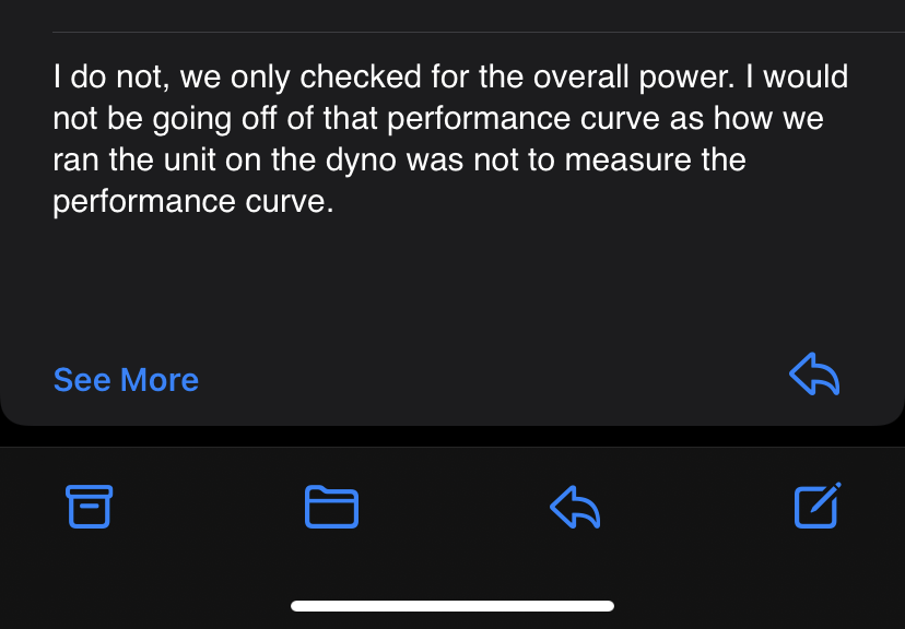

(03-31-2021 )Nilao Wrote:  Yeah that ecm can be flashed to stock for a couple hundred. Cummins will only have the data from whenever he hit record, so that may be all he saved.
It should have hit max torque around 1200 rpm and max hp around 1800 as that is how cummins tunes them stock.
This is what he wrote back when I asked about the rest of the curve.

03-31-2021, (Subject: Can someone please look at this dyno report? )
RE: Can someone please look at this dyno report?
Pfft...then why run a dyno at all? Your paying for a dyno so I want it to show the whole curve not just max power

(03-31-2021 )Nilao Wrote:  Pfft...then why run a dyno at all? Your paying for a dyno so I want it to show the whole curve not just max power
Yup! What a ripoff. Based on the limited data that it has and if I were to return it to stock power and also everything else on the truck being in good condition will it be worth buying? $25k,3.90gear ratio,13 speed.
