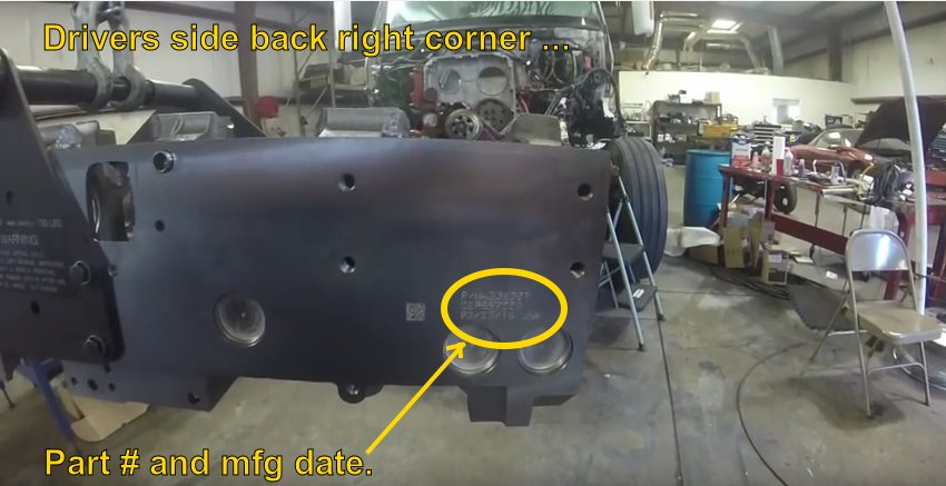

Also.. was the head re-worked?, or was a new OEM head installed?. Check the drivers side back corner near cylinder#6 .. If it is an RX or PX + part# and build date should be stamped into the head there.
